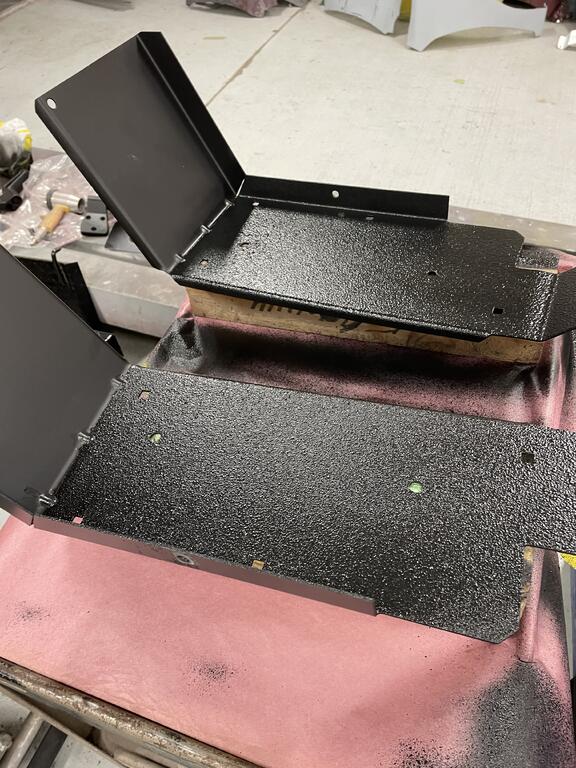

BHunter 1,702 #51 Posted January 12, 2022 (edited) We applied some spray on bed liner for the step tread and Hot rod black on the upright portion. Edited January 12, 2022 by BHunter 7 Share this post Link to post Share on other sites

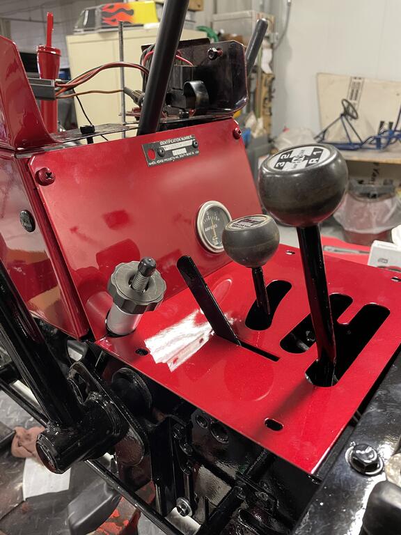

Gregor 4,848 #58 Posted January 12, 2022 I tried to buy Candy Apple Red in a can, apparently you can't. I have a spray gun now, is that color difficult to paint? Like silver ? 1 Share this post Link to post Share on other sites
BHunter 1,702 #59 Posted January 12, 2022 31 minutes ago, Gregor said: I tried to buy Candy Apple Red in a can, apparently you can't. I have a spray gun now, is that color difficult to paint? Like silver ? It required a silver-red base under the red candy. It’s a little tricky to spray. You need a slower reducer for the silver so it doesn’t come out blotchy, the gun needs to be even with the surface, you need to be careful not to drop your spraying elbow down so you don’t get stripes and you need to keep a 6-8 inch distance so the metallic will lay down evenly. I raise the gun up to 10” on the last coat and spray faster than the previous coats so the metallic stands up and looks even. The candy coats require you to spray the full length of the panel and be careful of overlapping too much so you don’t get dark areas. You can’t stop and start in the middle of the panel. It’s challenging, the kids had to repaint a couple of the panels because they messed up. It’s also very rewarding when it turns out good in the end. 8 Share this post Link to post Share on other sites

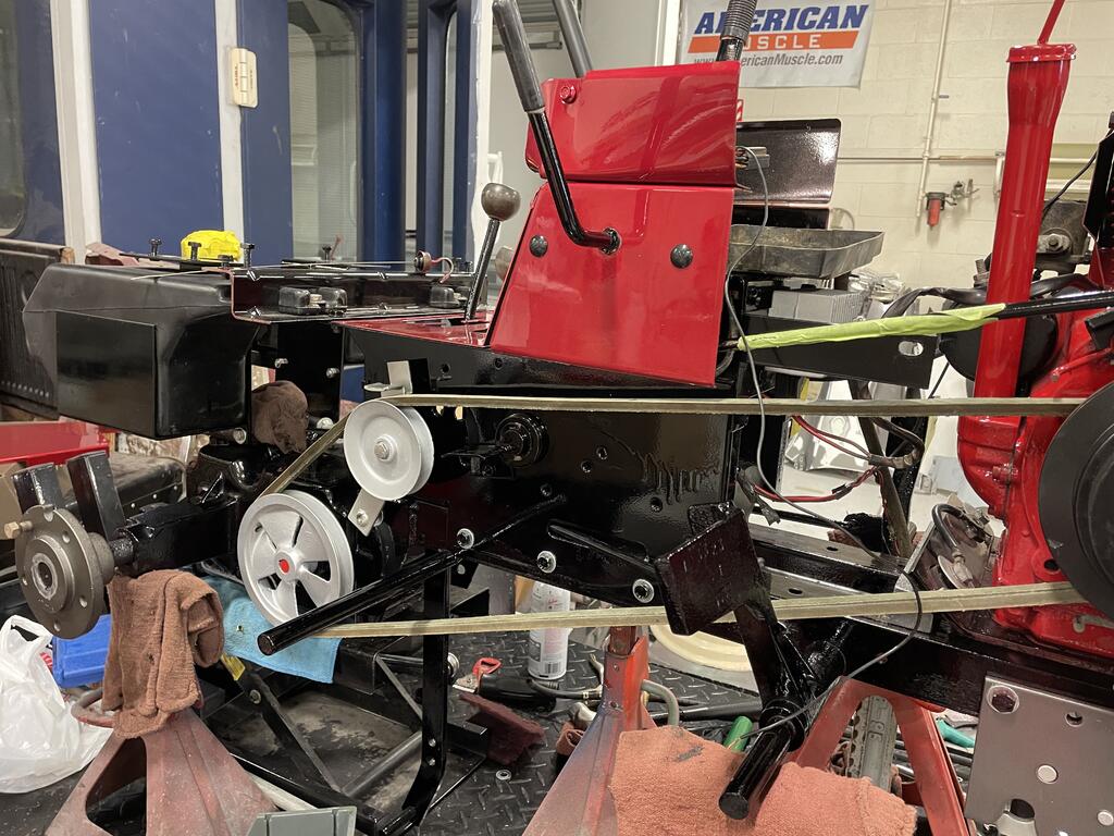

BHunter 1,702 #65 Posted January 25, 2022 Today we made good progress. We installed new axle seals, put the drive belt and pulleys on, did some wiring, installed the clutch and brake rods, and installed the id tag. 10 1 Share this post Link to post Share on other sites

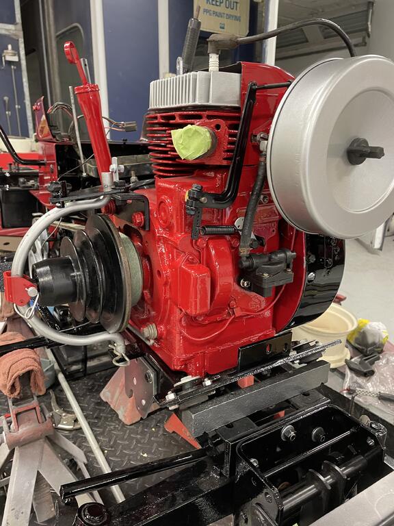

peter lena 10,103 #73 Posted January 26, 2022 @BHunter agree with others on your paint and detail work ! engine picture , see the opportunity to improve starting ? put a fuel check valve VERTICALLY in line from fuel pump to carb , simple / easy , holds a fuel charge for carb , insuring starting ease. have that on my 3 magnum engines , lots of hours and verify the way to go . just an idea, pete 1 Share this post Link to post Share on other sites
peter lena 10,103 #74 Posted January 26, 2022 @BHunter using this check valve ,https://www.amazon.com/EVIL-ENERGY-Return-Petrol-Aluminium/dp/B07ZB42CGT , these are all over the net , come in various sizes , INSTALL VERTICALLY TO PROPERLY FUNCTION , ARROW ON VALVE, they work . pete 1 Share this post Link to post Share on other sites
BHunter 1,702 #75 Posted January 26, 2022 8 hours ago, peter lena said: @BHunter agree with others on your paint and detail work ! engine picture , see the opportunity to improve starting ? put a fuel check valve VERTICALLY in line from fuel pump to carb , simple / easy , holds a fuel charge for carb , insuring starting ease. have that on my 3 magnum engines , lots of hours and verify the way to go . just an idea, pete I will get one of those valves. I never liked how long I had to crank the engine until it finally got fuel into the carb. thanks for the recommendation! 1 1 Share this post Link to post Share on other sites
