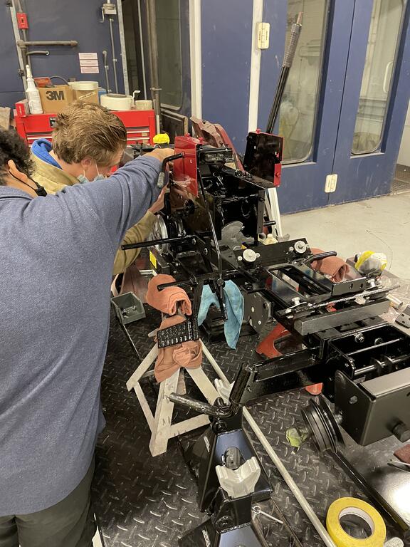

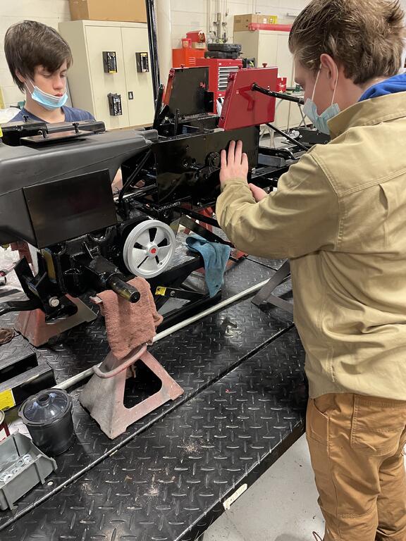

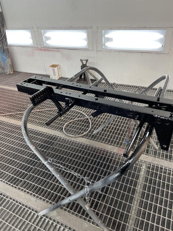

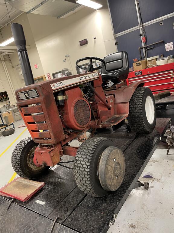

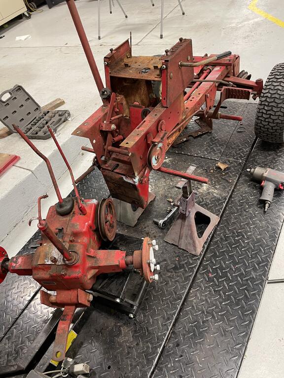

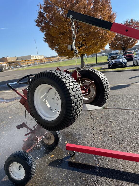

BHunter 1,702 #1 Posted December 17, 2021 The students asked if they could restore another wheel horse . I said of course. I brought my C141 in last month and they are going to town on it. They tore it down to the frame and sand blasted a majority of the parts. Each part received a coat of epoxy primer before the paint. They are doing a fantastic job. 5 23 1 Share this post Link to post Share on other sites

BHunter 1,702 #5 Posted December 18, 2021 45 minutes ago, Handy Don said: Sounds terrific. Must be interesting to listen to the chatter amongst the students as they work. I like to stand back and hear them talk. They really like the transformation from dull and rusty to shiny and clean. I let them chose the color scheme. I give them options and they run with it. They like having a say in the project. I like their choices so far . It’s going to look sharp. 1 4 Share this post Link to post Share on other sites

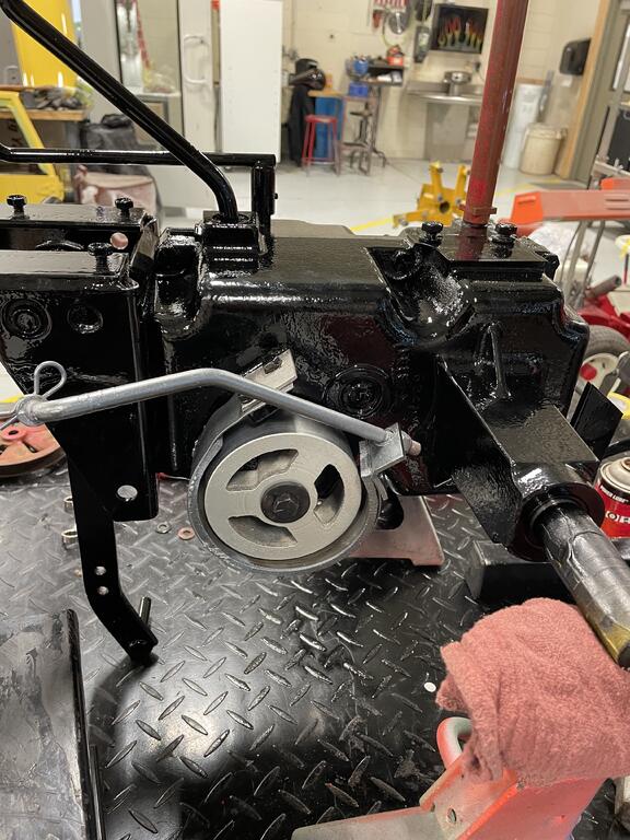

peter lena 10,103 #9 Posted December 18, 2021 @BHunter great opportunity to tighten up that sloppy end fit on the PTO LEVER .typically add 3/8" or more of washers and lubricant to that battery ground rail end point . also use battery ground bolt , to add a cable to corner of engine to frame , clutch pedal side to enhance frame ground . use a bolt on electrical lug , letting you easily add on more wires. pete 4 1 Share this post Link to post Share on other sites
BHunter 1,702 #10 Posted December 18, 2021 Thanks for the advice Pete. I never considered those items. I will definitely do that. Thanks! 3 Share this post Link to post Share on other sites

clueless 3,440 #21 Posted December 19, 2021 who makes the lift it's on? 1 Share this post Link to post Share on other sites
BHunter 1,702 #22 Posted December 19, 2021 2 hours ago, clueless said: who makes the lift it's on? Black Widow is the company. It’s air operated. I like it a lot. I also use it to load and unload tractors and other stuff into my truck bed. It’s the same height when up. the price really skyrocketed on it since I bought it a few years ago. 1 Share this post Link to post Share on other sites

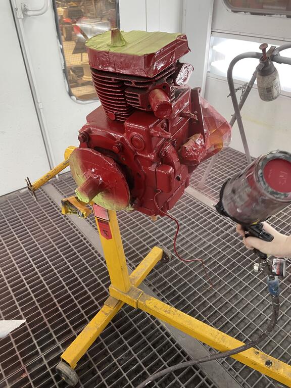

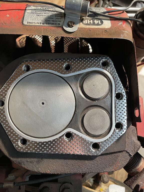

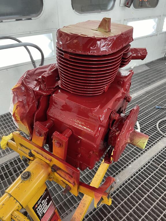

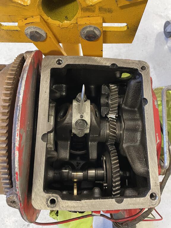

BHunter 1,702 #23 Posted December 21, 2021 Today we put new gaskets in and painted the engine. We replaced the valves before taking the tractor apart. Made sure the adjustments were good and it ran properly first 7 Share this post Link to post Share on other sites
