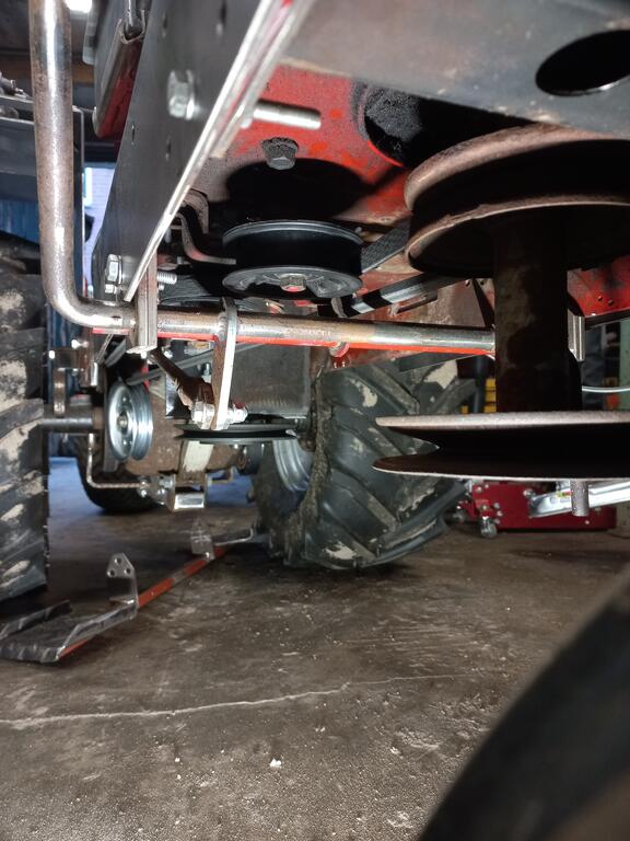

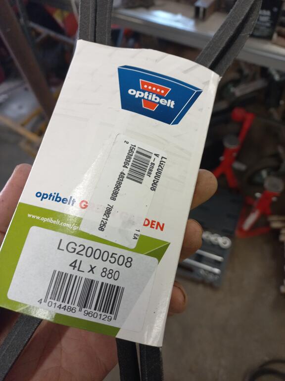

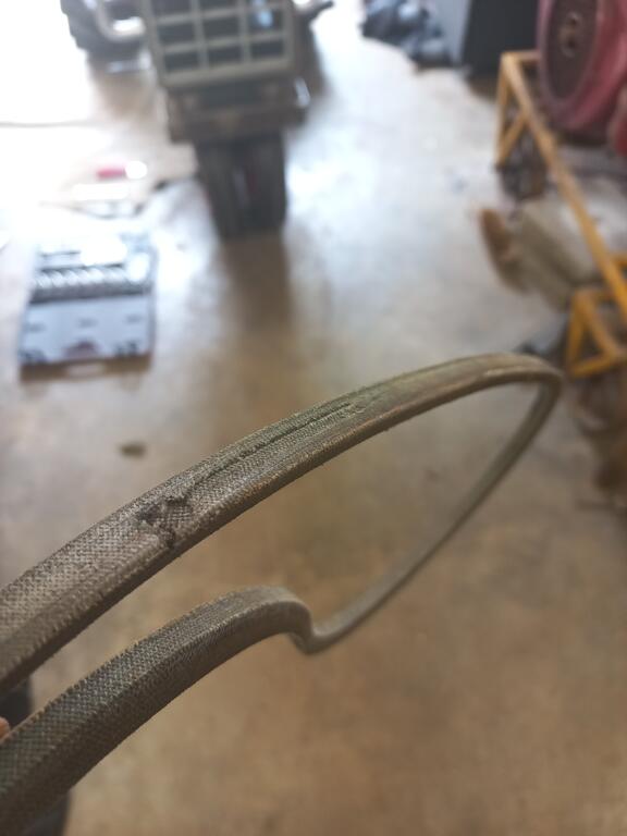

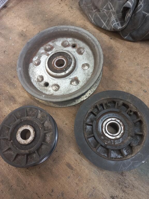

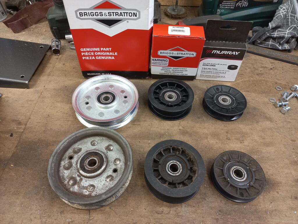

Did a little maintenance on the mini IH 1468 today. Straigtened the pulley on the gearbox since it seemed something got jammed in there at some point in time and bent the flanges out a bit. Still not perfect but much better than before. Also, three new pulleys and a new drivebelt were installed.
Old ones were crusty and bearings were shot.
Also the pvc flat idler pulley had some flat spots in it from being stuck and the drivebelt wearing a groove in it.
Ordered Murray part numbers and got B&S parts which are identical. I'm not complaining.
Also new belt because the old one had seen better days.
Last but not least installed some new sparkplugs in hopes that would help the engine run a bit smoother. Old plugs were totally black/full of soot which to me indicates it's running rich(?).
Can't really find out how to change the mixture on this carb but as a precaution also ordered a new airfilter and pre-filter.
Choke seems to work okay and carb has been rebuilt fairly recently.

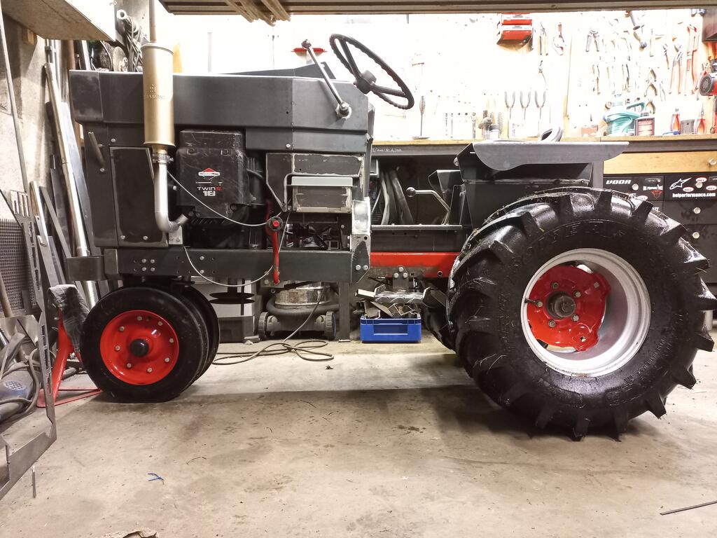

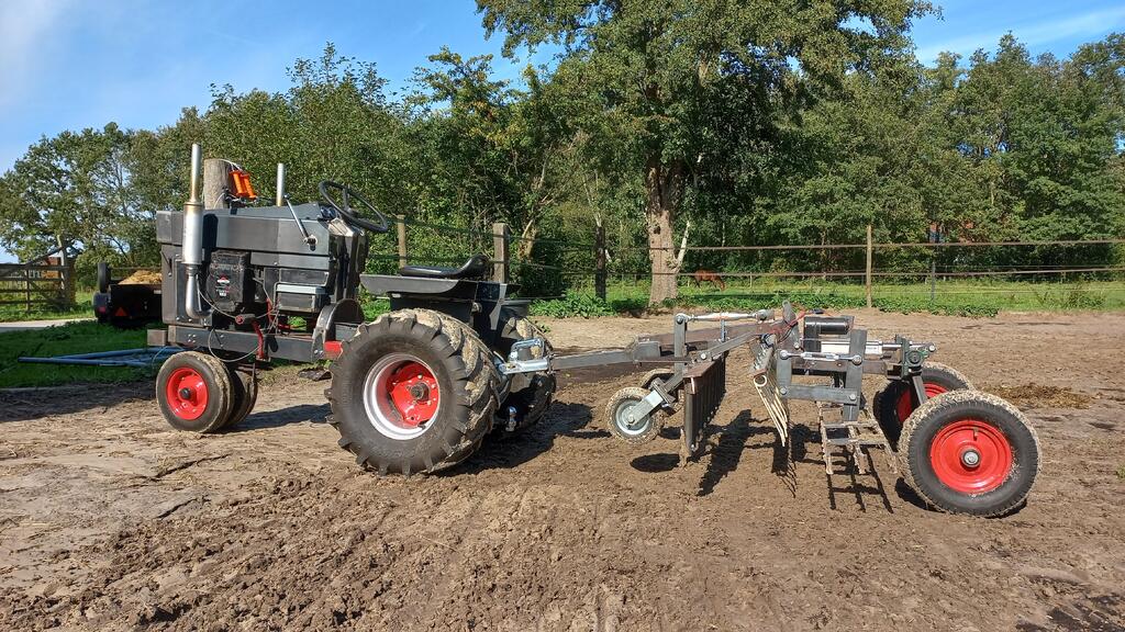

Took the mini International out for a spin tonight and drove to where my girlfriends horse is parked to do some manure hauling again.
There and back is about 1.5 miles total. It did fine and the new belt and pulleys seemed to have helped quiet it down a bit.
Even crossed some substantial puddles, about a foot deep, and it did'nt even flinch.
Knowing it CAN do it is something else than really doing it. Also found that despite the narrow front wheels it doesn't dig in as much as what I had anticipated.
It probably helped that I left the front weights at home on this trip.

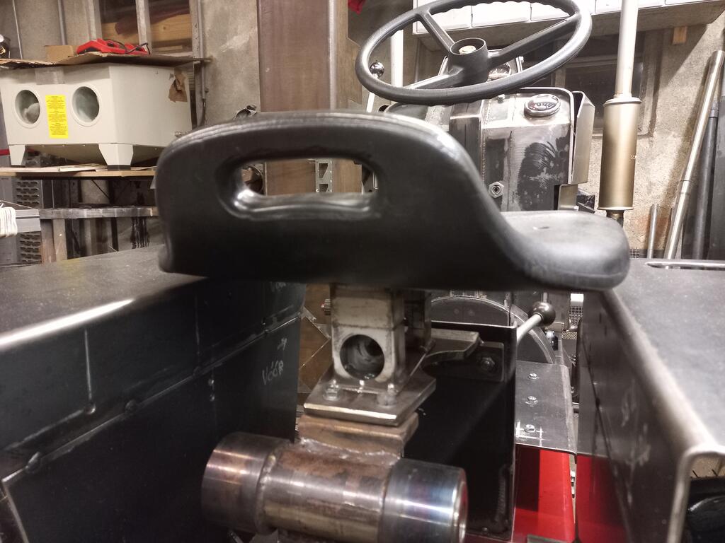

Only thing I definately need to change is the seat. It's hard mounted and very unforgiving, no bueno when driving long(er) distances.
Also lost my brake drum along the way but was lucky enough to find it again on my way home. Have to look into what happened there.
Another thing I noticed regarding the throttle and/or carb is that the engine did'nt want to come back to idle again once I drove full throttle for a while.
Seems to me there's something not quite right yet.

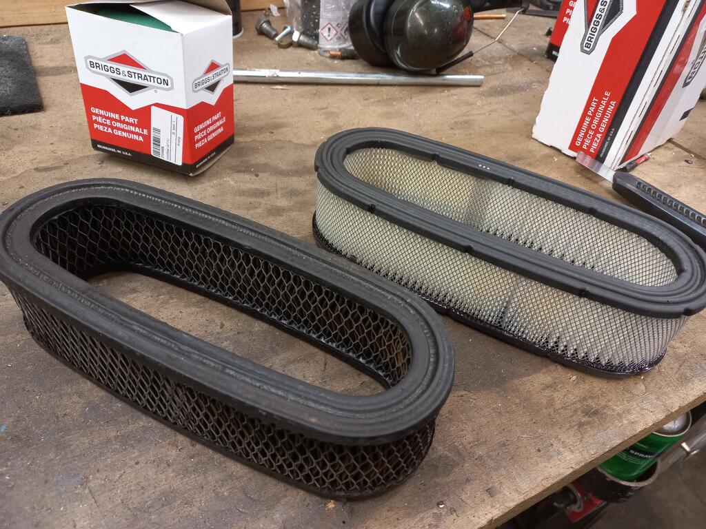

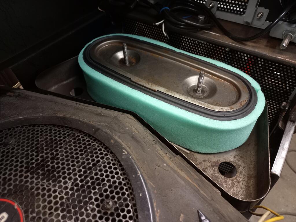

More maintenance today. New air- and prefilter came in and I installed them this morning.
Can you guess which one's the new one? :law-policered:
With foam filter installed. What do you do with that? Keep it dry (as is) or lube it up with filter-oil?
19richie66
I pit a couple drips around the prefilter and then squeeze it out. I like a light coat of oil on it all o er.

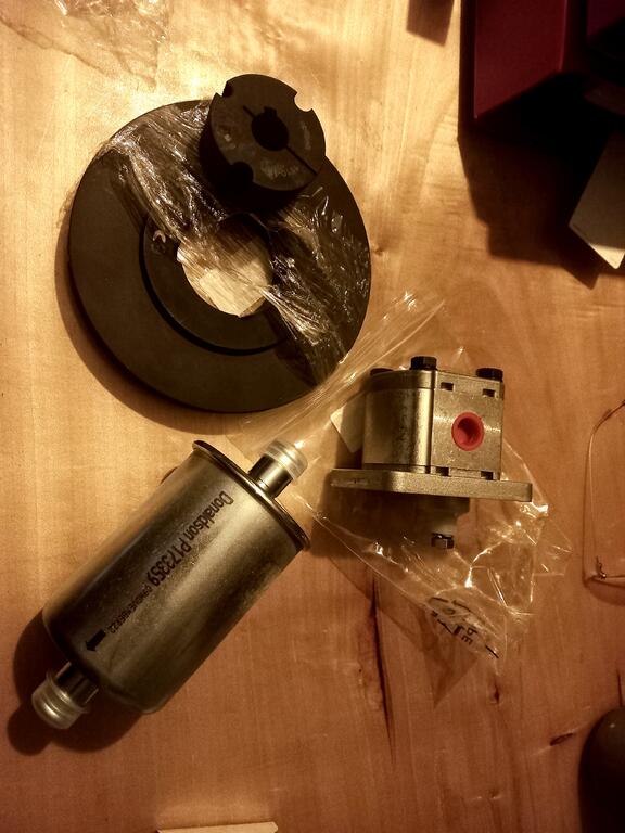

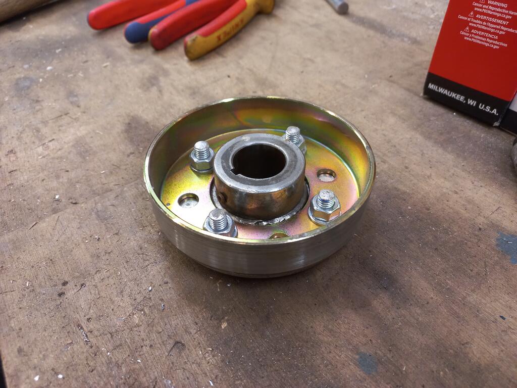

New parts arrived today:
-hydraulic pump
-pulley 155mm/6.1"
-taperlock
-filter
Still waiting on:
-bearing block (for the pump)
-coupler (for pump/bearing block)
Tonytoro416
Oh taperlock bearings.  Until one has fought them nightly in a diecasting plant you can’t truly appreciate them lol.
sjoemie himself
@Tonytoro416 I have'nt had that pleasure..yet.. any advice on how to make (un)installing them more enjoyable?

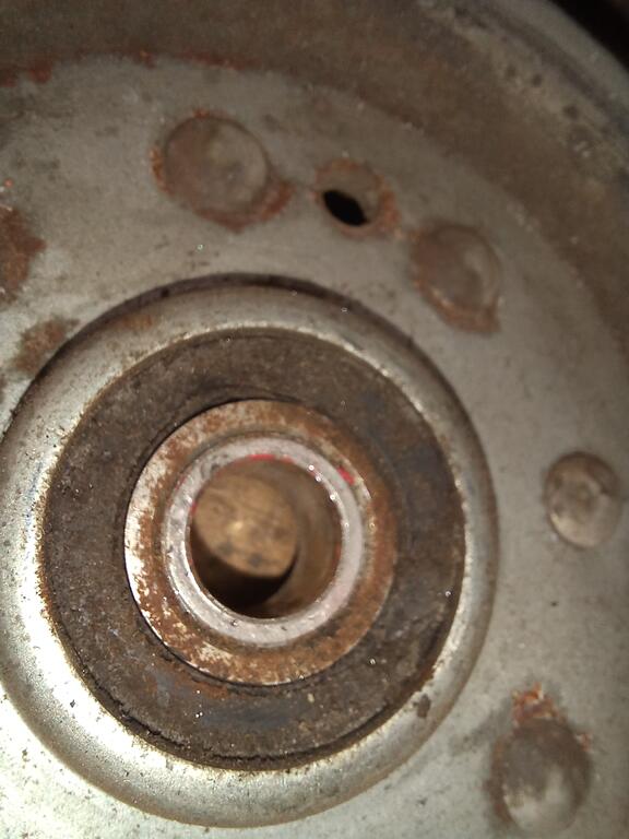

 @sjoemie himself   as usual with your work, there is killer detailing !  that  related , deck is something else , emphasize on the rotational , belt drive hand off , personal experience says , emphasis on rotational bearings , lubrication , every collective movement area , should be detailed for function , Lucas , hi temp , 550 + degree , polyurea (  anti sling )  grease in every bearing , move slide point . just the look of that  " EXHAUSTED  / FRAYED / BELT ,  is telling you the story / fix  route . combined  pulley bearing drag , equals heat , bearing side seals , removal , RE GREASE , also detail in every related movement area , this INCLUDES  THE PTO DRIVE SET UP .  LEAVE NO MOVEMENT AREA  , UNTOUCHED / improved . would also consider adding a , stronger tension spring , to cut down on belt / flutter . have not done one of those , but , would like to recover it . also look over , initial , lever engagement . pulley drag , belt bounce , hiding in plane sight , let me know , pete
peter lena
@sjoemie himself  , DID YOU CLEAN OUT AND RE GREASE THOSE NEW PULLEY  BEARINGS ?   rotational drag , makes heat , usually cooks and fails original grease . those wide side shields , flat pocket screwdriver , small putty knife , wipe out , 550 deg rated grease , makes them quiet / last . how about some super lube on that related choke linkage ? smooth easy . that foam over the air filter is left dry , helps capture the big stuff , you can always remove an clean out / replace .  verify full fuel flow ?  is pump ok? any possible blockage in line? float setting ?  add some carb cleaner to fuel , might have picked up  a  speck , to jetting , fuel filter ? , don't make me come over there !  kidding , sure you have it covered , any new set up , has , some tuning issues ,  pete

I must confess I did not clean and re-pack the bearings in the new pulleys. Might still do that but for now I wanted to check if these upgrades would quiet down the drivetrain, which it did.
Still need to get a new pulley for the input shaft on the gearbox because that had something wedged in it at some point so the belt bounces up and down in the groove. Not ideal.
The carb has been rebuilt fairly recently, added a new diaphram/pump while I was in there so *should* be good..
I'm leaning towards an issue with the air/fuel mixture because the old filter was very dirty/clogged. The engine would get less air and more fuel, so running rich.
Now with the new filter the engine can get (more than) enough air but not enough fuel so runs lean, has no power and dies?
Does that make sense?

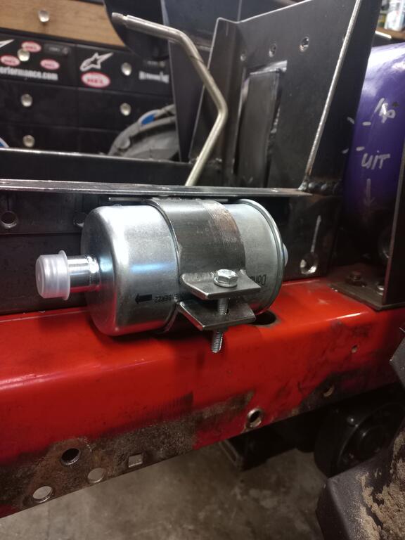

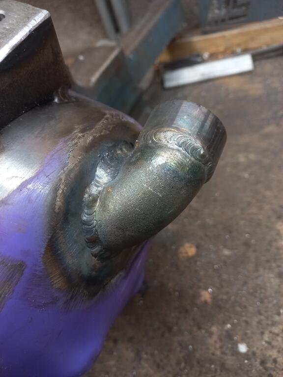

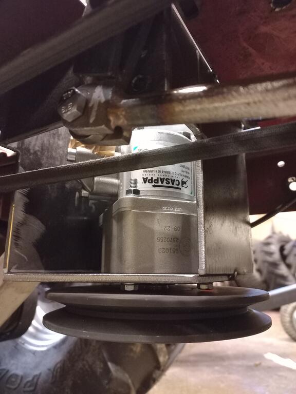

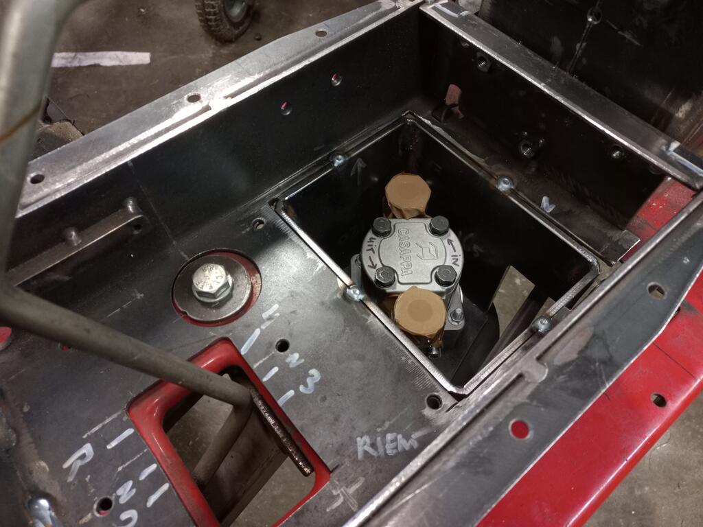

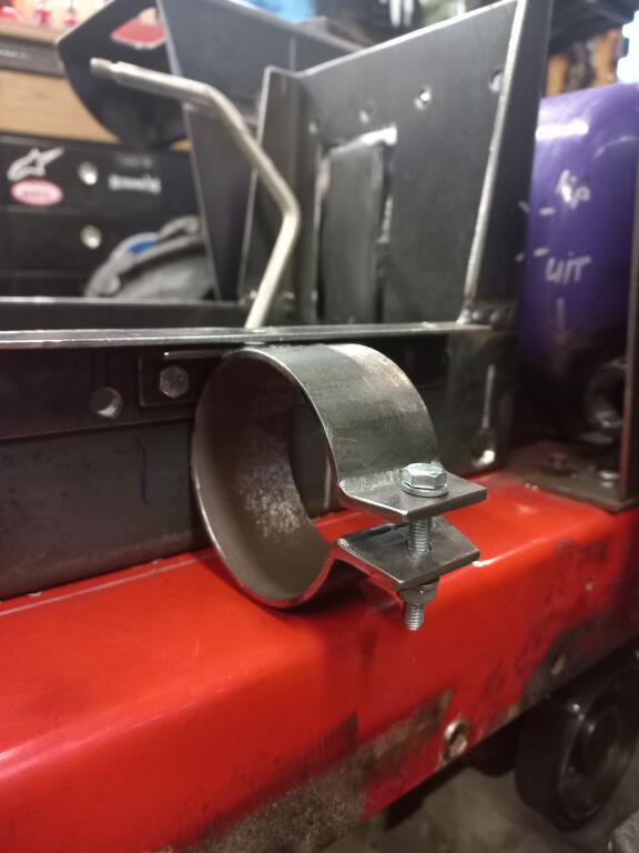

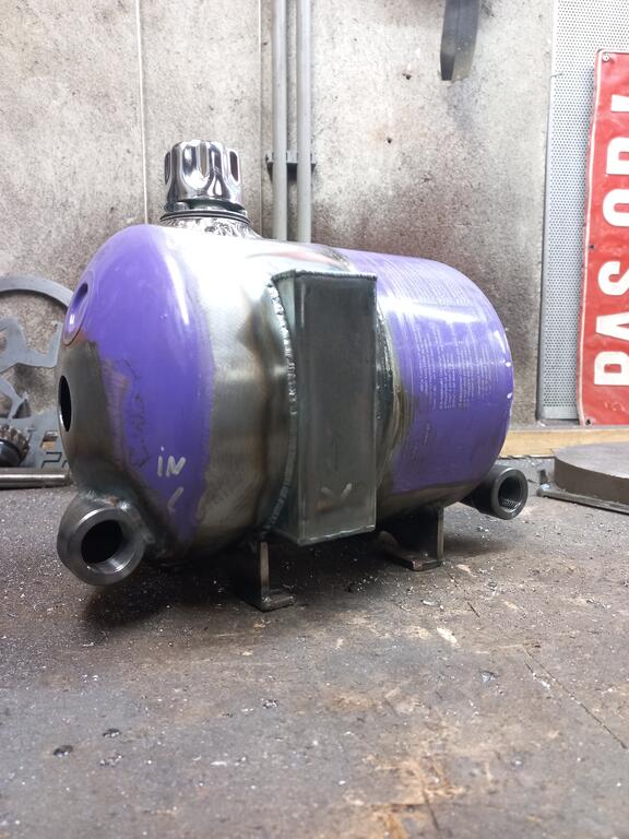

Been tinkering around with hydraulics. Changed the mounting point for the pump, lowered it.
Testfitted the pump. Seems good for now.
Next I moved to completing the hydraulic tank. Welded an intake and outlet bung on and a flat spot for an oilgauge.
Last but not least I found a spot for the inline oil filter and made up a clamp for it.
Next up is either hoses or the valves, probably valves.
Thanks for watching!
