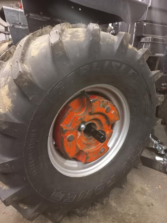

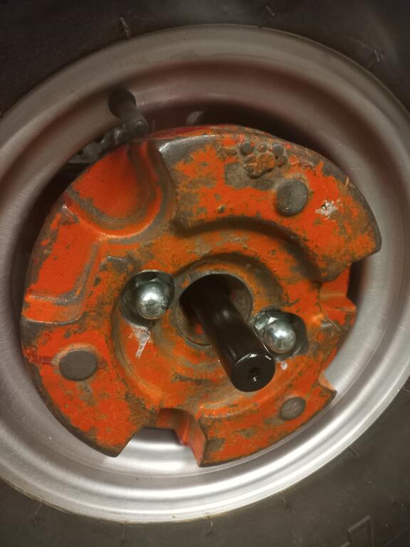

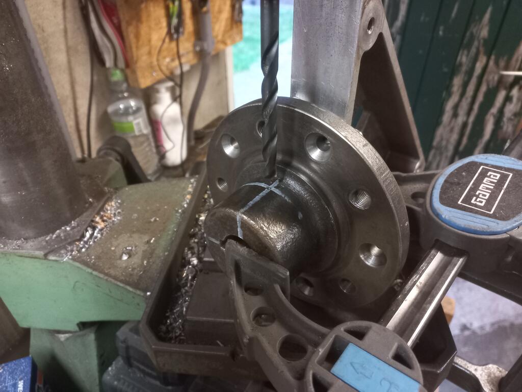

 Wheels off today..
I had already installed some setscrews in the hubs but they proved to be too small. The hubs were loose on the axle after my last testdrive.
To combat that I redrilled the thread to M8 (0.3") while also adding an extra threaded hole at 90° from the first hole (yes I learned that trick on this forum).
Now the wheels should hold firmly on the axle.
And finally, after what felt like an hour with the diegrinder I got the holes to fit the nut for the wheelweight bracket.
Testfit you say? Ofcourse! Fits :eusa-dance:
Now all I have to is get my blasting cabinet running and blast and paint the wheelweights and that's another thing done.
Probably going to work on the 3-point again next.
Edited by sjoemie himself
  • Excellent 5
Over here, our tapped holes are 3/8-16, similar to your 10mm 1.5 thread.  :handgestures-thumbupright:  those wheel weights look great!

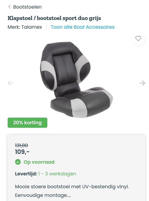

I think i've asked before but those seats.. where could I purchase something like it? Would you mind measuring how wide the seat is?
Sorry, I haven't been following along for a few weeks. The seats on the 953 are not something readily available but you may be able to find a metal chair or stool that has a pleasing seat and frame to adapt to your 1568. The cushion of the seat is 18" wide.
sjoemie himself
@953 nut no worries! There's more to life then tractors :handgestures-thumbupright: Thanks for taking the time to respond.
I think you're right about the availability of the seat (or any WH part for that matter) on this side of the pond.

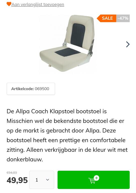

I've been looking at boat seats lately. They look to be very comfortable, all weather proof and affordable.
I would like to get a seat that's not too wide to keep the right look for the tractor. Luckily my rear.. erm.. "unidrive" isn't that wide so that won't be a problem :mrgreen:
  • Haha 3
I've had the same thought for when I may need to go seat hunting.   Color and pattern selection is very good.
Some also fold down to keep most of the weather off them when not in use.
sjoemie himself
Yep! I mean you have to like the colors and patterns but these are very comfortable. Hard to beat that price. Tractor or lawnmower seats are way less comfortable and the same or higher price..
1780594250_Screenshot_20221113-155242_Brave2.jpg.bb55c993c0044dbcd24f287290cf825b.jpg
IMHO...
This one looks reasonable on a tractor. Availability of different colors is good.

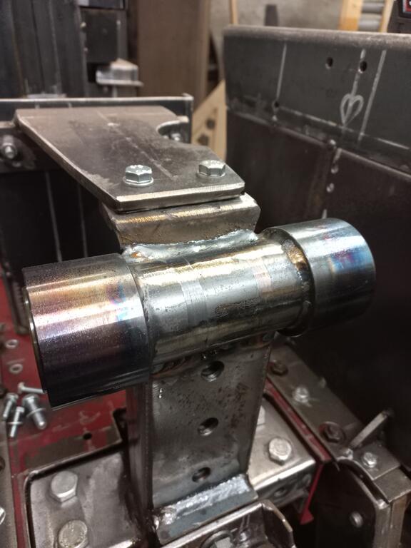

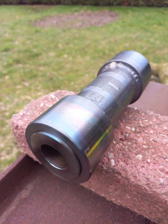

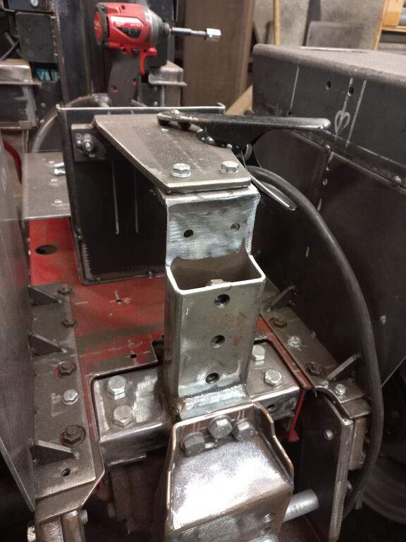

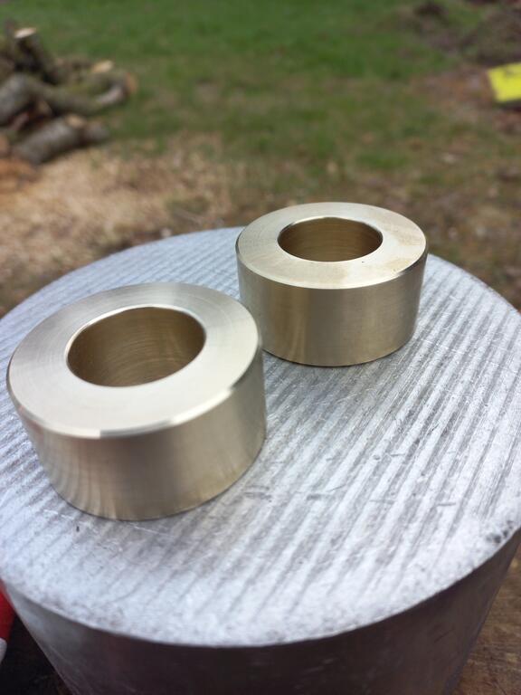

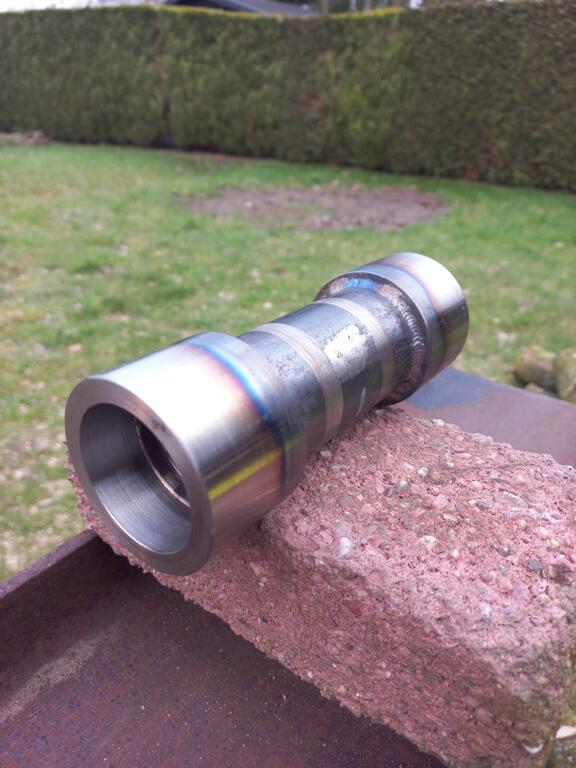

Besides that there were a few others things that needed my attention so I don't have a big update to show but progress nonetheless.. worked on the 3-point hitch again, to be more specific the upper hinge. Turned some bronze bushings and shrunk them in the housing then welded the housing to the tractor. Once fully welded everything will get linebored to make sure it turns without binding.
Turned and welded upper hinge.
Bronze bushings
Heated up the hinge and shrunk in the bushings
Cut out a spot for the upper hinge
Welded it in, still more reinforcing to do.
