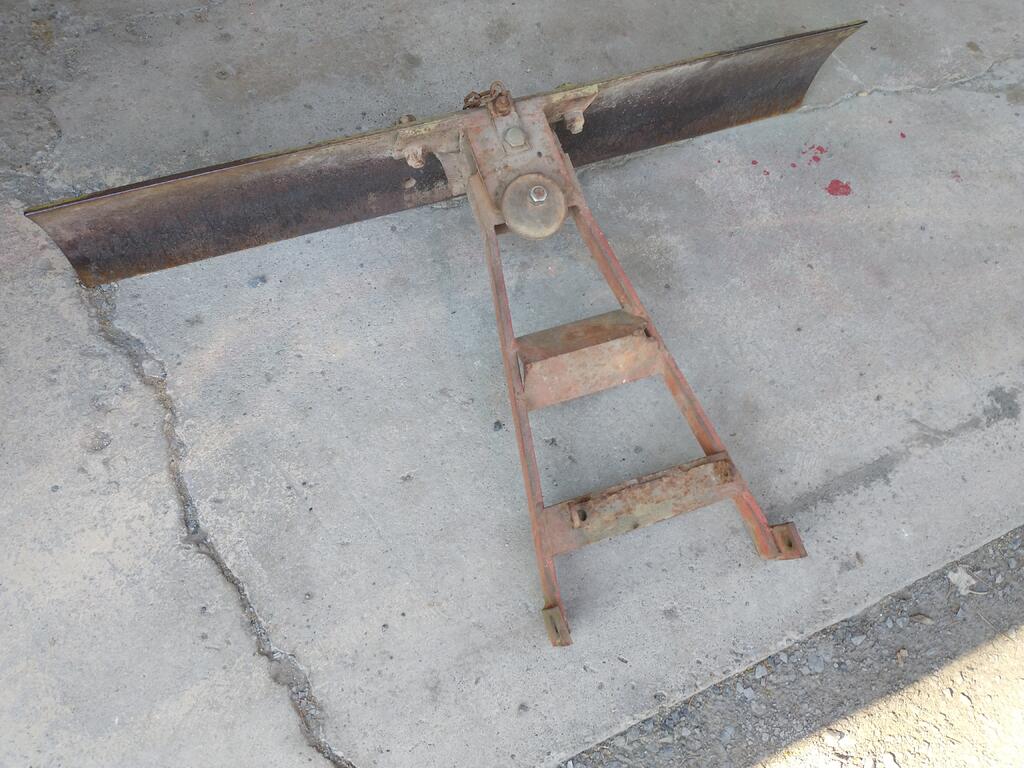

Goldnboy 1,147 #1 Posted December 12, 2021 I have been restoring a grader blade over the past few weeks. And it reminds me why I hate storing equipment In a shed with a dirt floor that gets wet. This blade was located in a guys lean to and was covered in dirt . The corrosion did a great job on the blade and made the pivot stuck. 1 Share this post Link to post Share on other sites
Goldnboy 1,147 #2 Posted December 12, 2021 I managed to get the pivot separated from the blade using a hydraulic jack as I seen done for the axle hubs. 5 Share this post Link to post Share on other sites

Goldnboy 1,147 #4 Posted December 12, 2021 Now I am at the cleaning stage where you can see the harsh work the dirt floor storage dirt to the blade. I have already went through two abrasive disc's cleaning this up. 1 Share this post Link to post Share on other sites

ri702bill 12,807 #7 Posted December 12, 2021 Yup, the L/D (length to diameter) ratio is high, probably 6 to 1 or greater, as it needs to be on this application, but - a great place for it to rust up solid. Any way to drill and cross drill for a grease fitting ?? Just a thought. Bill 1 Share this post Link to post Share on other sites

Goldnboy 1,147 #9 Posted December 12, 2021 1 hour ago, ri702bill said: Yup, the L/D (length to diameter) ratio is high, probably 6 to 1 or greater, as it needs to be on this application, but - a great place for it to rust up solid. Any way to drill and cross drill for a grease fitting ?? Just a thought. Bill This one does has a grease zerk but it was bone dry. 2 1 Share this post Link to post Share on other sites
