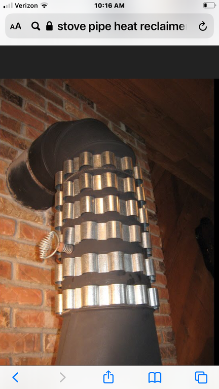

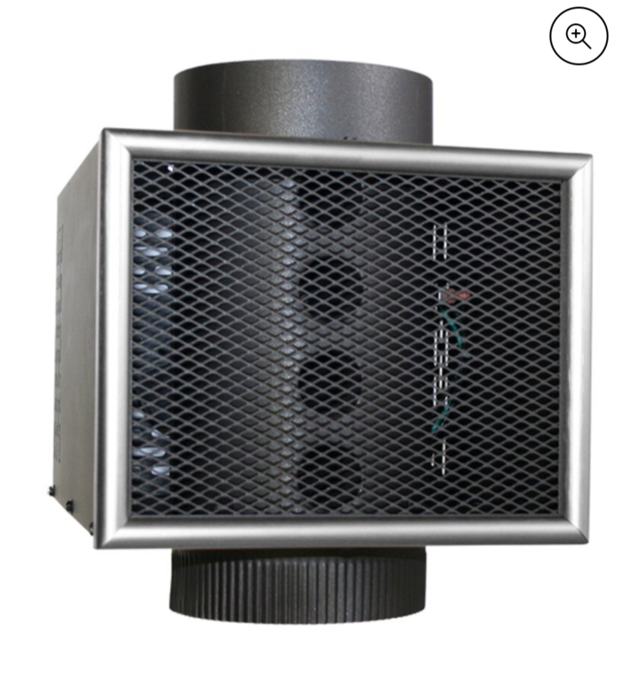

ebinmaine 80,108 #1 Posted December 11, 2021 Anyone use one of these? I've read/heard both good and bad about them. The good is that you're getting more heat from the stove by taking some from the rising smoke. The bad I've read is that some folks say the pipe cools too much causing draft issues and possible creosote increases. Any thoughts? Share this post Link to post Share on other sites

Achto 32,269 #11 Posted December 11, 2021 (edited) The Voglelzang design one that you have pictured is not the best reclaimer. Very few heat flues and no way to clean them. Magic Heat is a much better design for reclaiming heat and it has an internal scraper so you can clean the flues every day. https://www.shelllumber.com/magic-heat-mh-6r-heat-reclaimer-8000-to-30000-btu-black-for-6-in-bottom-crimp-chimney-systems.html?feed=Froogle&gclid=EAIaIQobChMIm6Ov54fc9AIVTsmUCR3-CgwrEAQYCyABEgKaS_D_BwE We had one of these above the Wonder Wood stove in the house when I was young. It was like adding a second wood stove as far as heat output. As mentioned above it can cause your chimney to run too cool resulting in build up inside the chimney. To keep this in check, Dad would clean the chimney 2 or 3 times per heating season. Never had a draft issue though. Wood stove and Magic Heat got moved to the garage after Dad installed an add on wood furnace in the basement. Edited December 11, 2021 by Achto 3 Share this post Link to post Share on other sites
JCM 11,343 #12 Posted December 11, 2021 I second what @Achto said. I used a Magic Heat unit in one of my camps up North for many years. It was used primarily because when I was heavy into snowmobiling and arriving late on Friday nights it would usually be around Zero inside. This helped bring the temp up in the camp but was only used for roughly 2 or 3 months. I eventually removed it and gave it to a neighbor here in Southern Maine. I would agree with full time winter woodstove use you would need to keep an eye on the flue passages. Think I bought it from Northern Tool for just over $ 100 dollars around 1995. Nice quality unit though. 3 Share this post Link to post Share on other sites
