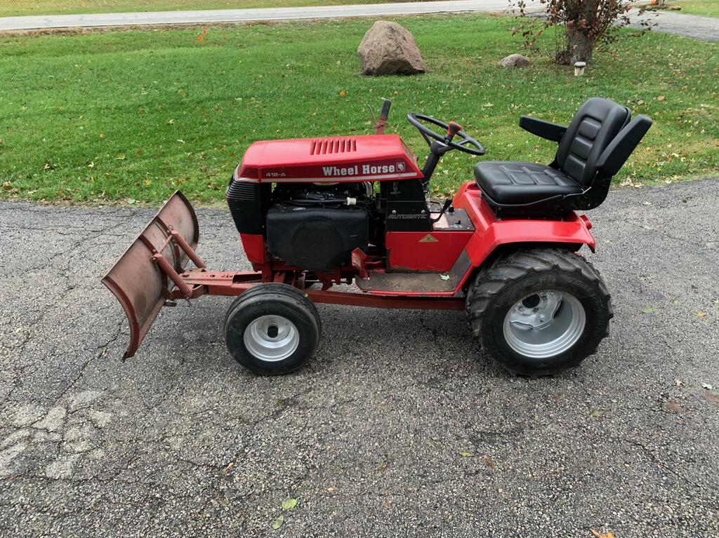

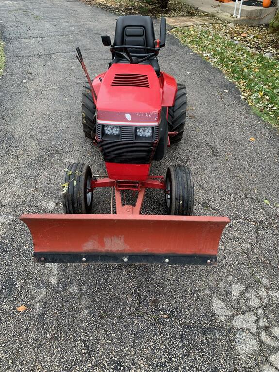

Pullstart 70,688 #13 Posted December 12, 2021 23 hours ago, lynnmor said: I would try losing the wheel weights and swapping the tires so they run backwards. Many in agriculture reverse the front tires on two wheel drive tractors. I can attest that running the ags backwards does help with steering traction, especially in slippery applications like snow. The tires on this round hood “Poppy” are not really ideal, I built it for the looks. I did however put loaded skinny ags on it for winter time, spun the fronts around and plowed a good amount of snow with it. Share this post Link to post Share on other sites
