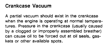

moe1965 774 #3 Posted December 2, 2021 I just pulled the dip stick while it was running and there seams to be quite a bit of blow back from the dipstick tube. Share this post Link to post Share on other sites
moe1965 774 #4 Posted December 2, 2021 I took breather cover and its loaded with oil. Sound like a new piston and rings or might something else cause this? 1 Share this post Link to post Share on other sites

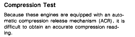

953 nut 67,489 #11 Posted December 3, 2021 2 minutes ago, Gregor said: I guess if it has ACR you really can't do a leak down test either. I been up too long. The ACR opens the exhaust valve momentarily just before TDC. You can do a leak-down test just past TDC. The keyway on the crank shaft will be at the top when the piston is at TDC. 1 1 Share this post Link to post Share on other sites

oliver2-44 11,632 #14 Posted December 3, 2021 (edited) 5 hours ago, moe1965 said: I took breather cover and its loaded with oil. Sound like a new piston and rings or might something else cause this? This area should have some oil in it to lube the tappets. That little hole is the oil drain and it is raised off the bottom a little so it will hold oil. You cannot do a compression test on a kohler k or magnum due to the compression release. Ideally a leak down test is the thing to do. See if your auto parts store has a leak down tester they loan out. PS I usually think of blue smoke only on startup as possible being due to valve guides. Worn piston rings/oil rings will smoke all the time. How does the motor run does it seem to have good power or low on power? Gregor types faster. Edited December 3, 2021 by oliver2-44 1 Share this post Link to post Share on other sites
moe1965 774 #15 Posted December 3, 2021 Seams to have good power. I'm going to clean breather assembly the Reid appeared to be stuck but I'm not sure. I'll check the exhaust and intake for proper clearance and restart. If that doesn't change anything I'll pull the head and go from there. 1 Share this post Link to post Share on other sites
