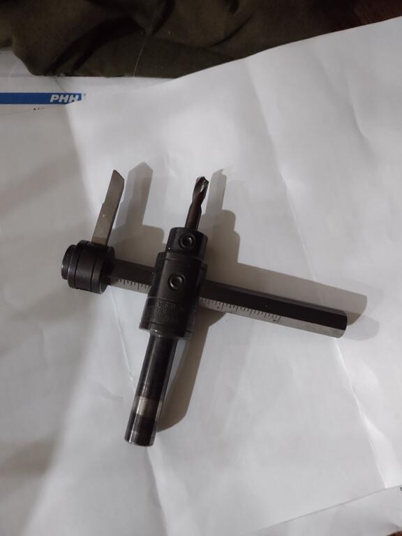

ebinmaine 79,297 #1 Posted December 1, 2021 I need to cut some circles of 3/4" thick pine. Found this at a friend's house. High RPM? Low pressure? Any tips or tricks? Thanks. Share this post Link to post Share on other sites
8ntruck 8,989 #2 Posted December 2, 2021 Very carefully. I'd use it in a drill press at slow speed. I would not even attempt to use it in a hand held drill. 8 Share this post Link to post Share on other sites
ebinmaine 79,297 #3 Posted December 2, 2021 7 minutes ago, 8ntruck said: drill press That's the plan. Figured I could clamp the work piece to the table too. Share this post Link to post Share on other sites
8ntruck 8,989 #4 Posted December 2, 2021 Clamp it to the table? CHICKEN! You know @Pullstart would not do that. 9 Share this post Link to post Share on other sites
ebinmaine 79,297 #5 Posted December 2, 2021 1 minute ago, 8ntruck said: Clamp it to the table? CHICKEN! You know @Pullstart would not do that. He'd hold the board with his teeth and run the drill press with a sandal covered toe. 7 1 Share this post Link to post Share on other sites

953 nut 66,862 #12 Posted December 2, 2021 6 minutes ago, WHX?? said: hole saw might work better best ask @formariz or one of the other silver wizards I had a cutter like that at one time, it did a poor job and lots of tear-out on cross grain. I threw it away and never missed it. I would suggest you invest in a set of hole saws. for wood working you should wax the hole saw inside and out, go slow and clear the sawdust frequently. 4 1 Share this post Link to post Share on other sites
ebinmaine 79,297 #13 Posted December 2, 2021 1 minute ago, 953 nut said: I had a cutter like that at one time, it did a poor job and lots of tear-out on cross grain. I threw it away and never missed it. I would suggest you invest in a set of hole saws. for wood working you should wax the hole saw inside and out, go slow and clear the sawdust frequently. If I want a 4" OD circle what size hole saw is that? It's the circles I need. Not the holes... Share this post Link to post Share on other sites
pacer 3,180 #14 Posted December 2, 2021 I've got one exactly like that one and another similar, and, have used them many times for just the type thing you are needing. Will do great on wood and I have even fell back on one for an odd ball piece of metal. As mentioned your piece will have to be VERY well clamped/held and a drill press set at a pretty slow speed and feed it slowly To get a circle you will need to reverse the bit..... and you just might have to make a couple "prototypes" to get the feel of it, cause its .... different! With this thing you can fiddle with it and end up with an exact size and I dont think a hole saw would do that, plus, as you said it'd be pricy! 1 Share this post Link to post Share on other sites

formariz 12,379 #21 Posted December 2, 2021 As it been mentioned before, only use that thing in a drill press. Make sure that everything is clamped properly and go slow with it. Make sure cutter is sharp. Probably has been used on drywall. If so it is not sharp. Also make sure all cutter holding screw is tight. Gentle pressure slow speed. avoid that thing cutting even the smallest of knots Make sure, make sure, make sure or it can make for a very bad day. 2 2 1 Share this post Link to post Share on other sites
