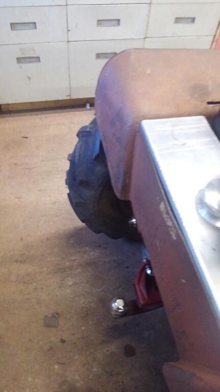

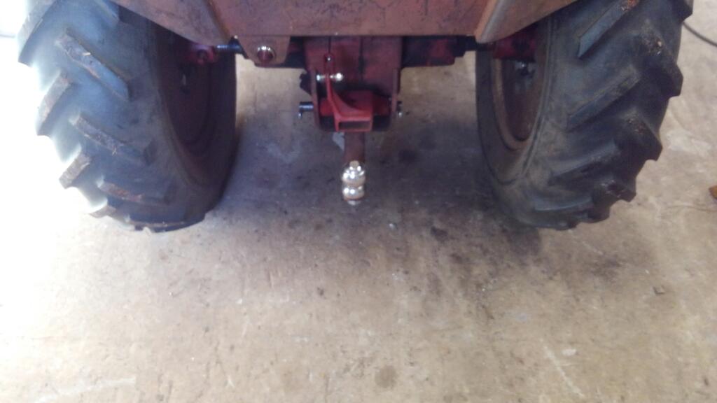

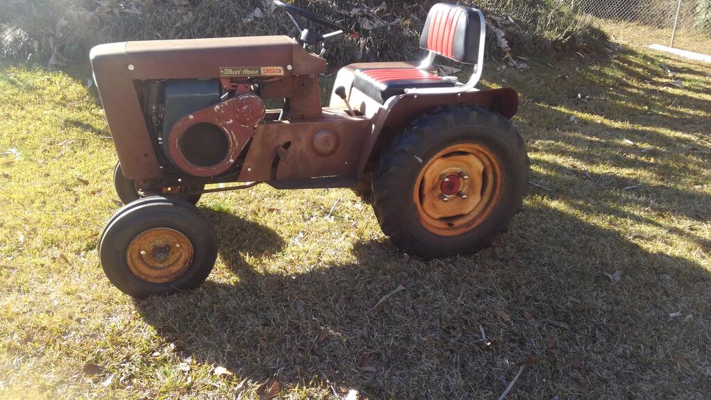

19richie66 17,937 #126 Posted January 23, 2022 I had no idea the rear tires were loaded. No wonder it was so hard to push into the shed. 4 Share this post Link to post Share on other sites

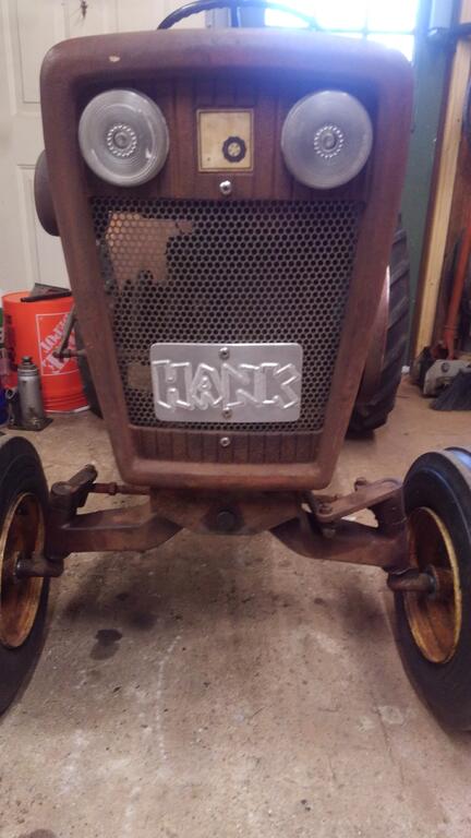

JPWH 6,544 #127 Posted January 23, 2022 After body work. Name plate installed. 4 6 3 Share this post Link to post Share on other sites
Pullstart 71,386 #128 Posted January 23, 2022 Hank! 3 Share this post Link to post Share on other sites
19richie66 17,937 #129 Posted January 23, 2022 Love it! 3 Share this post Link to post Share on other sites

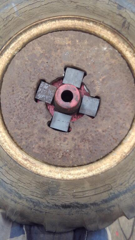

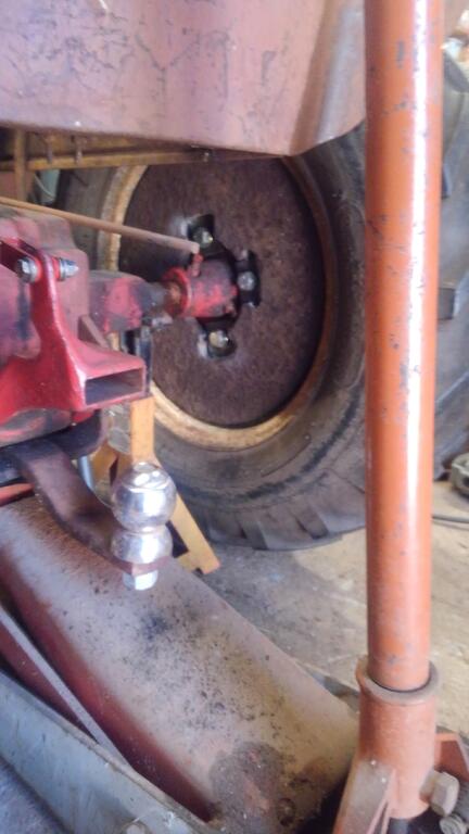

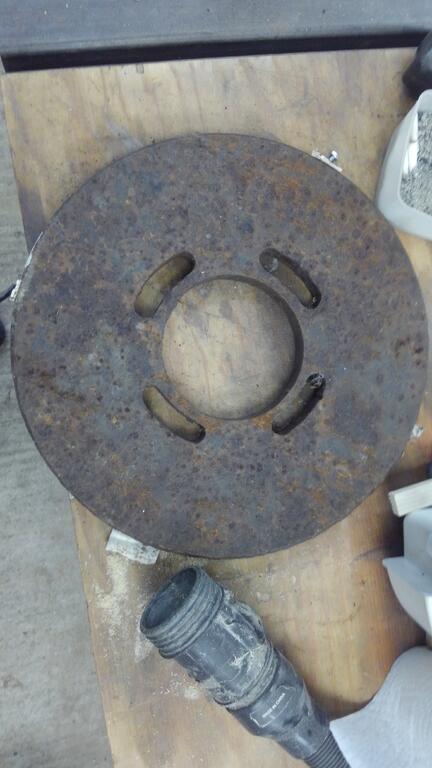

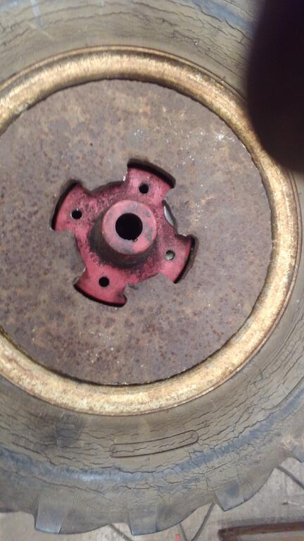

JPWH 6,544 #130 Posted February 5, 2022 I finally got the rear wheel weights. The steel is 3/4" thick and weigh 30 lbs. each. The bolt pattern is too big but for the price I think I can make them work. A little cut here and there. Then a little cutting on the band saw gets them ready for a little shaping and hole drilling. 7 2 1 Share this post Link to post Share on other sites
JPWH 6,544 #131 Posted February 6, 2022 Finished the homemade rear wheel weights. Not pretty but functional. I don't like the lug nuts but they work till I find what I want. 4 7 2 Share this post Link to post Share on other sites
Pullstart 71,386 #132 Posted February 6, 2022 Nice work! I used “Prevailing torque lock nuts, Zinc plated grade 8 (grade C) steel, 9/16"-18” from Bolt Depot and chased the threads for lug nuts. It seemed to work great! 2 1 Share this post Link to post Share on other sites

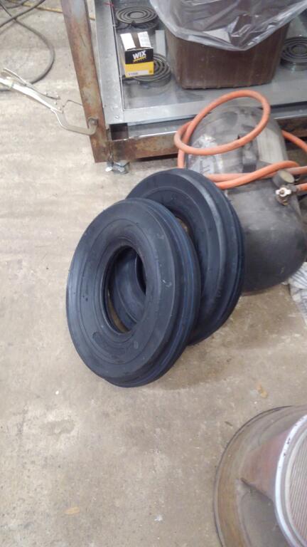

Horse Newbie 7,405 #134 Posted February 6, 2022 On 12/9/2021 at 7:26 PM, JPWH said: New front shoes arrived today. Í need to finish cleaning the rims and get them installed. If you don’t mind me asking, what size are those, how much $$.$$, and where did you find them ? 1 Share this post Link to post Share on other sites
JPWH 6,544 #135 Posted February 6, 2022 (edited) @Horse NewbieI got them from the bay. Seller Gregthree $77.00 + tax tires and tubes shipped. 4.00 - 8 4 ply. Jay Edited February 6, 2022 by JPWH 1 Share this post Link to post Share on other sites
Horse Newbie 7,405 #136 Posted February 6, 2022 22 minutes ago, JPWH said: @Horse NewbieI got them from the bay. Seller Gregthree $77.00 + tax tires and tubes shipped. 4.00 - 8 4 ply. Jay Thanks @JPWH… I’m sorry I bothered you with the same question you answered in post # 57. But thanks for the specifics! Share this post Link to post Share on other sites
JPWH 6,544 #137 Posted February 6, 2022 @Horse NewbieNo problem. I just went back to see who the seller was. The tires are a soft rubber but I think they will work good when I fill them. May have to raise the pressure some to add weights. Jay 1 Share this post Link to post Share on other sites
JPWH 6,544 #138 Posted February 12, 2022 It was 69 degrees when I got home today so I loaded the front and rear tires. 16 gallons total. I took it for a test drive and when I pulled back in the shop my wife came down to see what I had been doing so I told her and asked if she wanted to drive it. Both Charlie and Bentley had to have a turn with her. @oliver2-44 She likes it! 1 4 4 Share this post Link to post Share on other sites
oliver2-44 11,782 #139 Posted February 12, 2022 2 hours ago, JPWH said: It was 69 degrees when I got home today so I loaded the front and rear tires. 16 gallons total. I took it for a test drive and when I pulled back in the shop my wife came down to see what I had been doing so I told her and asked if she wanted to drive it. Both Charlie and Bentley had to have a turn with her. @oliver2-44 She likes it! Their going to have to add a womens section here soon and Lowell will be expanding his womens fashion line soon. 1 3 2 Share this post Link to post Share on other sites
ebinmaine 80,974 #140 Posted February 12, 2022 9 hours ago, oliver2-44 said: Their going to have to add a womens section here soon and Lowell will be expanding his womens fashion line soon. That would be awesome. 2 Share this post Link to post Share on other sites
rjg854 13,405 #141 Posted February 12, 2022 It's good to see both wife and tractor are doing well. And the little dogs too. 1 2 Share this post Link to post Share on other sites

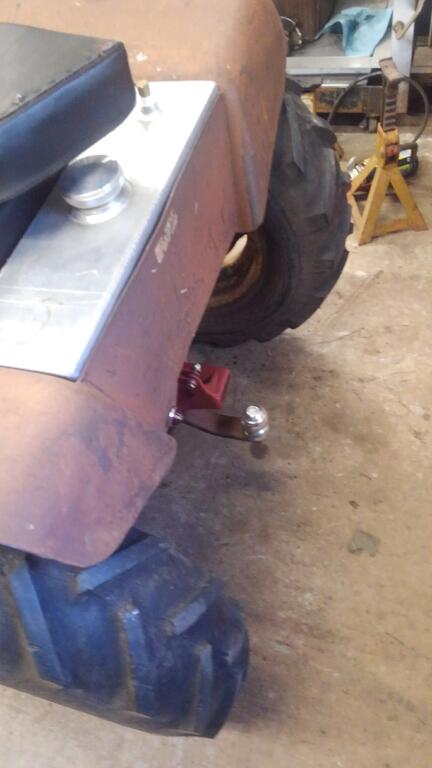

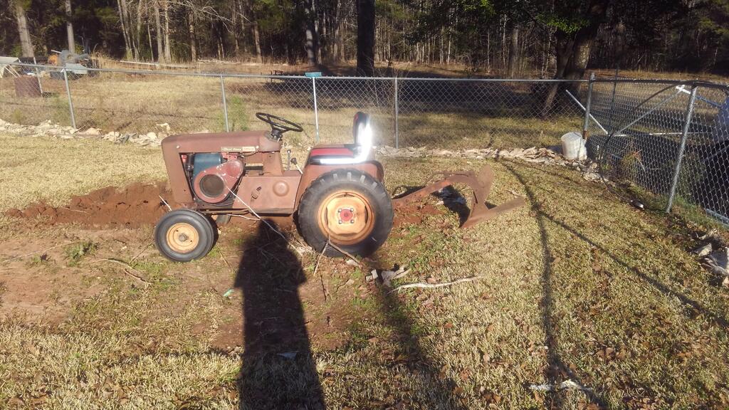

JPWH 6,544 #142 Posted February 13, 2022 I finally got Hank to do a little work moving some stuff from my truck and from behind the shop. The I installed the sleeve hitch I got from @ebinmaineand hooked up the plough for a little test run. 2 4 Share this post Link to post Share on other sites
19richie66 17,937 #143 Posted February 13, 2022 The side covers and belt cover fit into the look just right. Fine job👍 2 1 Share this post Link to post Share on other sites
ebinmaine 80,974 #144 Posted February 13, 2022 6 hours ago, JPWH said: got Hank to do a little work NIIIIICE! Ya can't let these beasts just sit around not earning their keep. I agree with @19richie66. Looks excellent. 2 1 Share this post Link to post Share on other sites

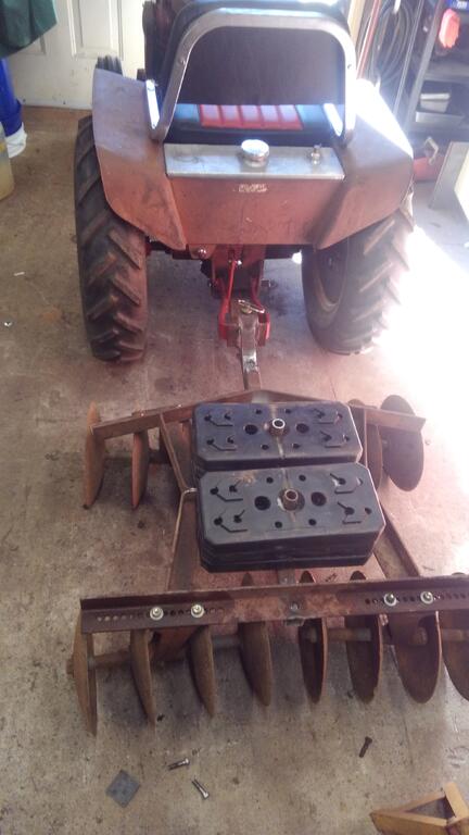

JPWH 6,544 #146 Posted February 13, 2022 I finished the tandem disc build. Now I need a large enough garden plot to try it out 9 1 Share this post Link to post Share on other sites
Pullstart 71,386 #147 Posted February 16, 2022 Sweet disc! 1 Share this post Link to post Share on other sites
Snoopy11 5,731 #148 Posted February 16, 2022 On 2/13/2022 at 6:10 PM, JPWH said: I finished the tandem disc build. Now I need a large enough garden plot to try it out I have a tandem disc pull-behind... thingy... for a big tractor. I could cut it down for a smaller tractor... but I have often questioned how good it would work. You may be giving me ideas for a project... @JPWH Don 2 Share this post Link to post Share on other sites
