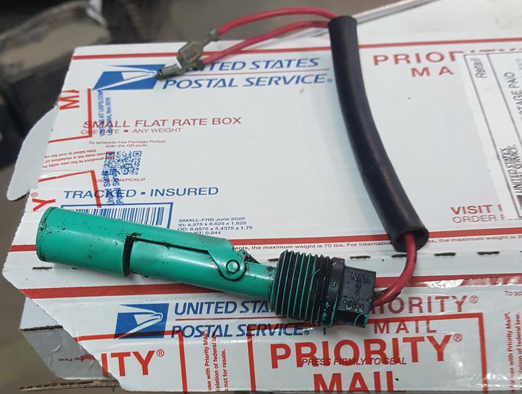

@biged77 When i was takeing the tractor apart and cleaning it, I tore the wires out of the switch. The tractor still cranks and runs like it is suppose to, my oil switch just doesn't work. That switch that you have there, does it work cause i wouldnt mind having thta function working on mine even if it's not all that important?

Your low oil switch (oil sentry) is a normally closed switch (sitting on the shelf with no pressure or force applied it is closed). If engine oil is correct the float will rise and open the switch, if it is low the switch will close. When this switch closes it activates a relay opining the connection between the ignition switch "S" terminal and the solenoid. It will not stop a running engine, it will prevent you from starting the engine with a low oil level.

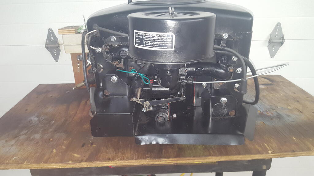

I don't have a Magnum "ON" a tractor.  But it does not have an oil switch.20211021_105204.jpg.6d5e35b52aef8eb2670337d1fc10db79.jpg

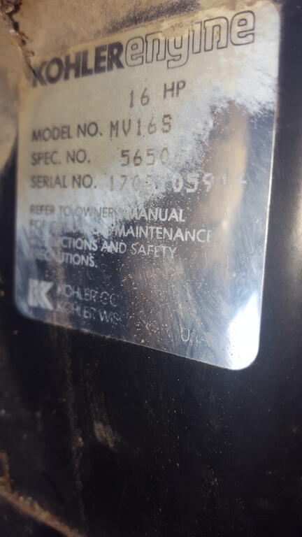

Is that a vertical Greg or am I just lookin at the pic wrong? KT series two?

MV16  Spec  56506  Vertical shaft, yes.
Twins would not have an oil switch they had oil pressure sending units. (pressurized lube system).  magnum singles were just splash so a low oil switch was used.

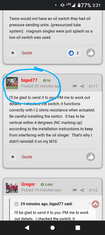

I'll be glad to send it to you. PM me to work out details.  I checked the switch, it functions correctly with l-2 ohms resistance when actuated.
Be careful installing the switcn.  It has to be vertical within 4 dergrees (NC marking up) according to the installation instructions.to keep from interfering with the oil slinger.  That's why I didn't reinstall it on my M10.

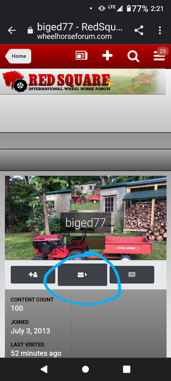

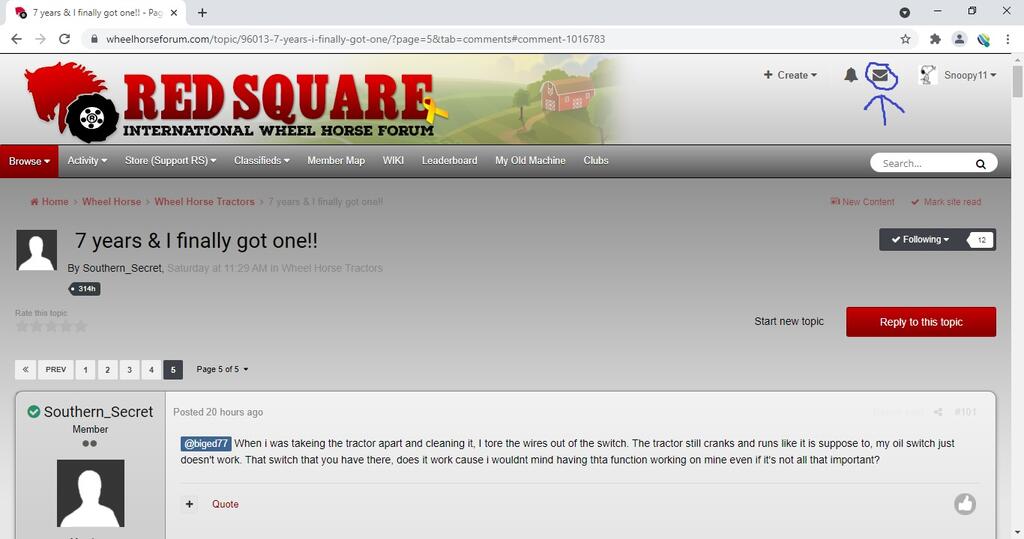

@biged77 im not sure i know how to PM :oops:
@Snoopy11
Different on a phone.
Couple ways I can go about it.
I'll show you how I would do it from here.
Click on the name of the person.
That will open up the next screen. Their own profile page. Click on the icon that is the envelope in the middle. That opens up another page that will be self-explanatory.
