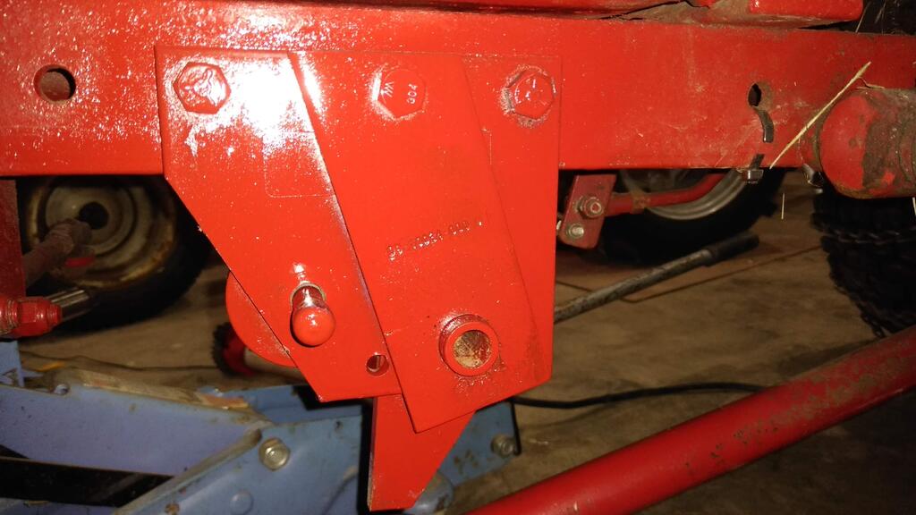

edgro 680 #1 Posted November 21, 2021 I did not like the looseness of the crank handle support that goes into the mid mount tach-a-matic. Don't know if this has been done before, but here is my cure. I drilled a piece of flat stock, and made this bracket to support the end on the left side. Handle slop is gone now 1 2 Share this post Link to post Share on other sites

lynnmor 8,831 #4 Posted November 21, 2021 1 hour ago, edgro said: A 1/4" rod thru those holes that back up the latches, (see photo), will help reduce the slop for any implement. Of course capturing it completely, like you did, will reduce the slop to near nothing. The use of a rod is not documented in my owners manuals, maybe at one time it was. Share this post Link to post Share on other sites
