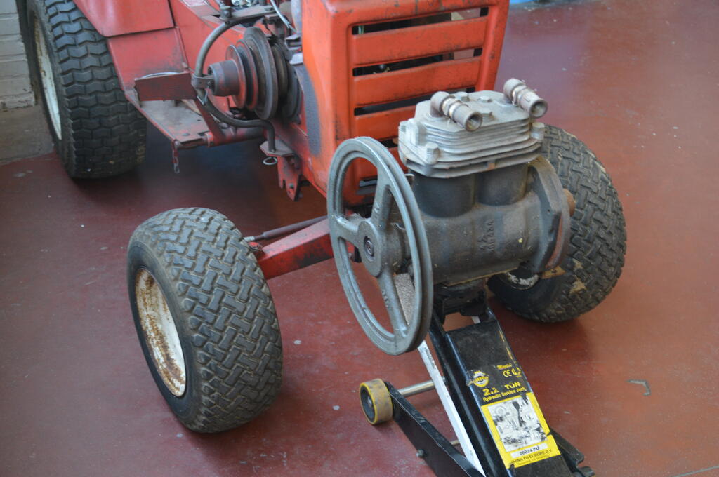

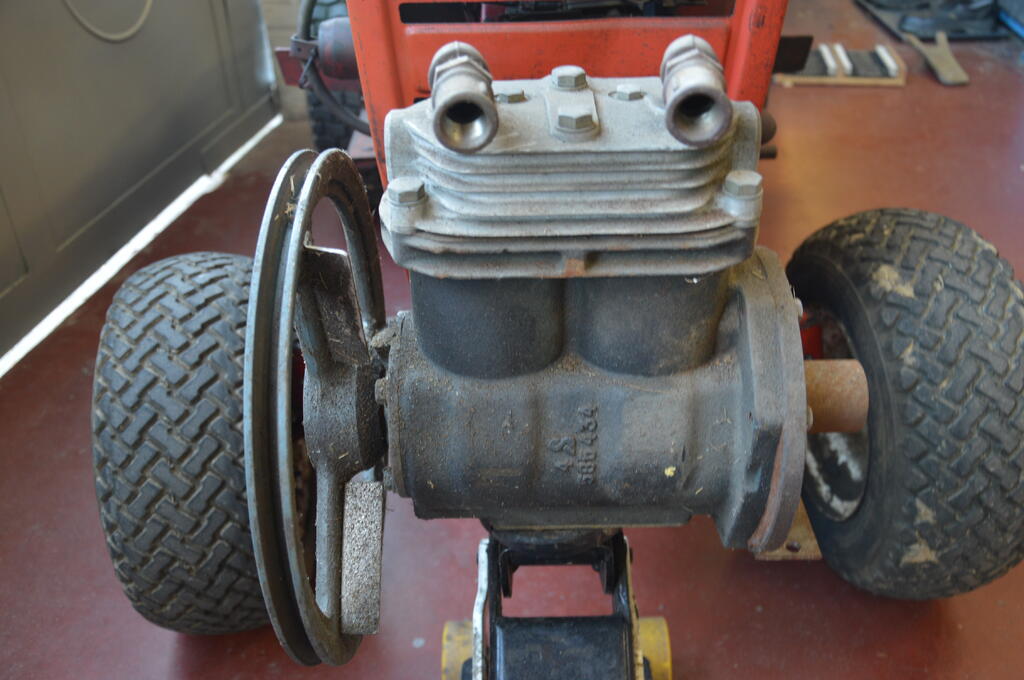

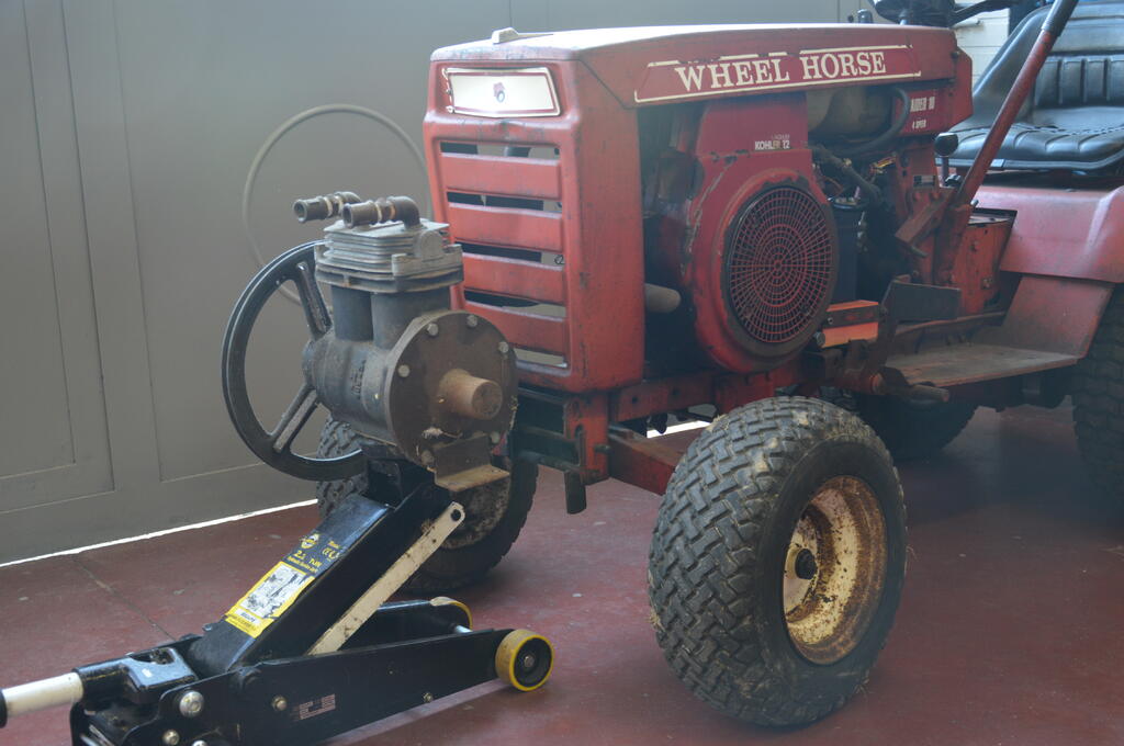

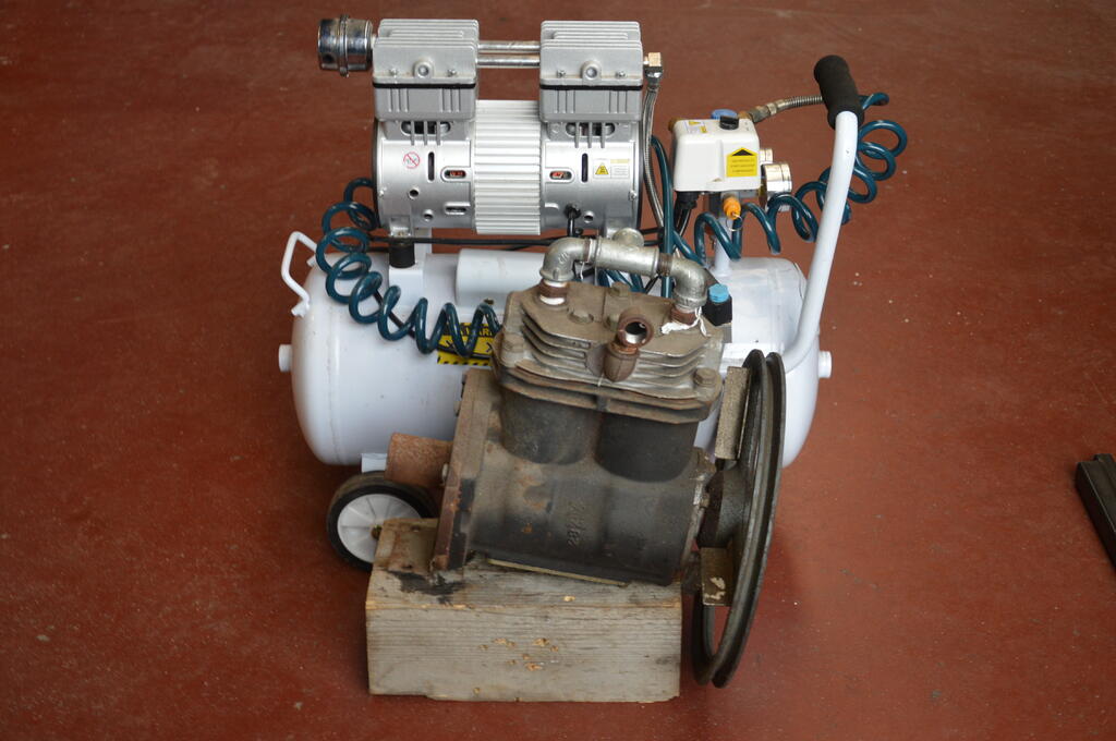

Maxwell-8 4,371 #1 Posted November 13, 2021 Thanks to @ebinmaine I am going to make a separate topic on the fabrication of my Front-mounted air compressor, that will be driven by the PTO. We do have a huge compressor in the shop, but we often have had the need for compressed air on the propriety. And often this is out of reach with our big shop compressor. Like our concrete air hammer. So the idea came up to simply mount one on the front of a Wheel Horse, expanding it's utility-range. I found this big 1983 two cylinder compressor. All cast-iron and big enough to have a high CFM for running the concrete hammer. Coming in at 25kg or 55lbs, it weighs more then our little compressor(with thank and hoses included). 4 2 2 Share this post Link to post Share on other sites
Maxwell-8 4,371 #2 Posted November 13, 2021 (edited) The main questions that I have to find an answer on are: 1. compressor speed: I measured the pto pulley on my raider 10 and it is 4.5 inches(inside) and the pulley on the compressor is 12 inches. After some calculations I determined that at full engine speed (3.600RPM) the compressor will be doing 1.350 RPM. Is this to high or to slow? 2. buffer tank: I will be needing a buffer tank, how big should I go? And wouldn't it be getting a bit heavy on the front of the tractor? Maybe use support wheels? 3. compressor shut-off: This is a hard one, I know @Pullstart has a compressor with a mechanical shut off, but couldn't find that post. If I had a Horse with a electrical PTO, things would be a lot easier. Edited November 13, 2021 by Maxwell-8 1 Share this post Link to post Share on other sites

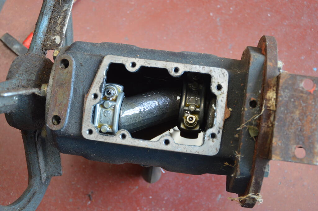

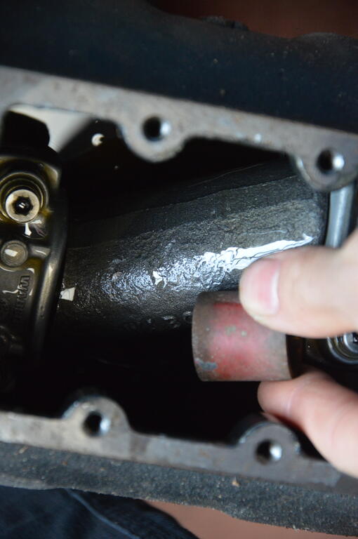

Maxwell-8 4,371 #8 Posted November 13, 2021 I already prepared the compressor for the fabrication. Changed the oil, and how freaking beefy this compressor is! crankshaft has a diameter of 1.7 inches !!!! A hitch spacer for references 2 1 Share this post Link to post Share on other sites
