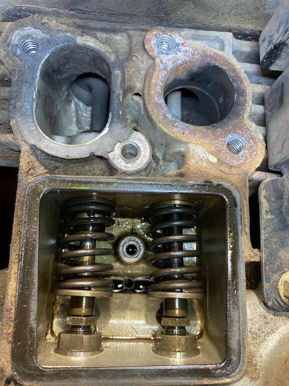

Prewarvtwin 1 #11 Posted November 12, 2021 Hi Guys, Thanks for all the Replies! Great Site with no shortage of help here, and a downloaded manual to boot. UPDATE--- I went ahead and dug my way down to the valve adjust cover, then rolled engine over so both valves were closed. I put air into plug hole as part of a leakdown test to find all the air blowing out thru the intake valve. Checked with feeler gauge to find no gap at all on intake valve adjuster. Would it be my lucky day that valve will close once I adjust lifter to proper clearance?? My next move to see if compression returns! The valve seats look ok and dont look like they are loose thru intake port. STAY TUNED CHEERS Share this post Link to post Share on other sites

Handy Don 16,962 #13 Posted November 12, 2021 (edited) 4 hours ago, Prewarvtwin said: Hi Guys, Thanks for all the Replies! Great Site with no shortage of help here, and a downloaded manual to boot. UPDATE--- I went ahead and dug my way down to the valve adjust cover, then rolled engine over so both valves were closed. I put air into plug hole as part of a leakdown test to find all the air blowing out thru the intake valve. Checked with feeler gauge to find no gap at all on intake valve adjuster. Would it be my lucky day that valve will close once I adjust lifter to proper clearance?? My next move to see if compression returns! The valve seats look ok and dont look like they are loose thru intake port. STAY TUNED CHEERS That would be terrific! If you can get the right clearance and the valves seal, then just eyeball to make sure there is enough valve left (wear somewhere caused the loss of clearance-valve stem, valve seat, or valve head). Also, the exhaust port looks pretty clean and the valve box is clearly getting lubed, so those are good. Edited November 12, 2021 by Handy Don Share this post Link to post Share on other sites
Prewarvtwin 1 #14 Posted November 13, 2021 Well , i guess it was my lucky day! Compression back up to 120psi in rear cylinder. Local dealer even had new intake gaskets for me. Reassembled and fired right up and never ran sooo good. Why over the years would it slowly open the valve and adjustment be so far out that it wont run? Anyway now when I engage PTO the engine immediately quits.. whole new problem. Any recommendations as to what this is about?? Thanks Guys Share this post Link to post Share on other sites

lynnmor 8,914 #16 Posted November 13, 2021 1 hour ago, Prewarvtwin said: Why over the years would it slowly open the valve and adjustment be so far out that it wont run? There is the possibility that the valve seat is loose and pounded into the head taking all the clearance. 2 Share this post Link to post Share on other sites
Handy Don 16,962 #17 Posted November 13, 2021 32 minutes ago, lynnmor said: There is the possibility that the valve seat is loose and pounded into the head taking all the clearance. Something caused the valve clearance to be lost and you still don't know what. 1 Share this post Link to post Share on other sites

squonk 47,421 #22 Posted November 13, 2021 Seat sinking in head. Valve stem stretching can cause the clearance to close. Share this post Link to post Share on other sites
Handy Don 16,962 #23 Posted November 14, 2021 8 minutes ago, squonk said: Seat sinking in head Yep, this would be my first look. How much shoulder is left on that valve. If it is already worn and the shoulder is shot, the next failure could be much worse. Share this post Link to post Share on other sites
Snoopy11 5,731 #24 Posted November 14, 2021 (edited) 16 minutes ago, squonk said: Valve stem stretching Yep, that is why I was wondering if it is titanium. I have heard of this happening before, exactly what you are referring to @squonk... and I know that some manufacturers run titanium on the intake side and steel on the exhaust side... so... that could be the culprit... The Onan P220G engines are notorious for having loose valve seats... and obviously, as the valve train components wear, mainly the valve face and the valve seats, the valve clearance goes away. I am looking over this: Don Edited November 14, 2021 by Snoopy11 Share this post Link to post Share on other sites
lynnmor 8,914 #25 Posted November 14, 2021 20 minutes ago, Snoopy11 said: Are those intake valves titanium, per chance? Anybody have an idea? Don They are steel. Onan made a heavy duty engine that had better steel valves and a few other things, but they weren't used in Wheel Horses. I never understood why Onan just didn't make them all the same, the price would have been only a little more. 1 Share this post Link to post Share on other sites
