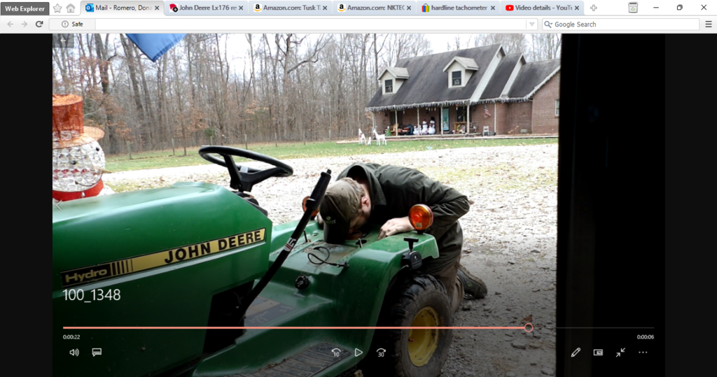

Snoopy11 5,731 #96 Posted December 11, 2021 Hey guys, So, here is what I am going to call the finished product. Of course, since I changed all the fuel lines, I had to use Eric @ebinmaine's priming technique... Don 2 Share this post Link to post Share on other sites
ebinmaine 77,826 #97 Posted December 11, 2021 @JCM @Pullstart you boys see this???? 1 Share this post Link to post Share on other sites
Snoopy11 5,731 #98 Posted December 11, 2021 You just KNEW I had to... @ebinmaine Don 2 Share this post Link to post Share on other sites
JCM 10,989 #99 Posted December 11, 2021 Oh no, not this again. Where's @wallfish when you need him to make sure your technique is correct. 2 Share this post Link to post Share on other sites
