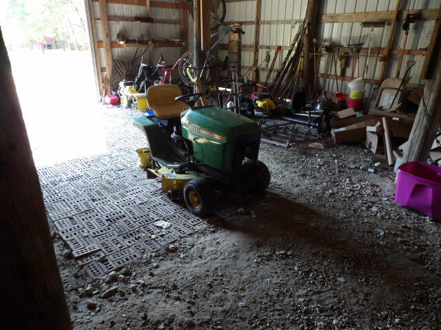

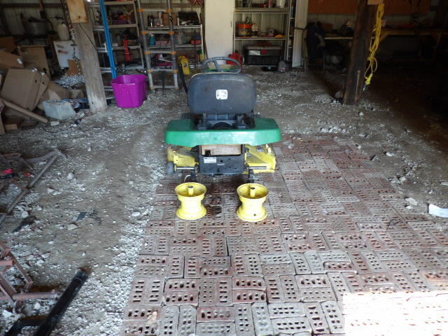

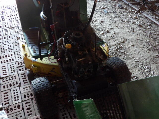

Snoopy11 5,731 #14 Posted November 5, 2021 Progress! Well...sort of. It still doesn't run... no spark... but I ordered and am awaiting the parts sometime next week. While Gracie was getting spayed, (we pick her up at 4 today)... I did a little bit of work... changing fluids... cleaning the fuel tank, etc. The one thing I noticed is that there is no fuel going through the filter after a good amount of trying... so I might end up needing a fuel pump... UGH... In my frustration... yes, Eric, @ebinmaine I took the tires off the rims... even though I don't have a tire changer. 💪 Here are some pictures. I have the zero turn pulled out and HellHorse up at the house... thus why they are not seen in the photos... I am undecided... as well as unknown if I need to remove the engine and do a full rundown. Time and lack of will are 2 variables... (wouldn't be the case if it was a Wheel Horse... I would have already pulled the motor and gone through it...) This is a bit far off... if I even ever get this thing running... (which I am beginning to question the more I dig in...) but what color I should paint it? I SIMPLY REFUSE FOR IT TO REMAIN GREEN IN MY POSSESSION... (yes, I know that my zero turn is green... but I didn't build that... we bought it...) I need a vote people! Not pink or purple... I am thinking like a really deep, metallic brown, with nice shining clear coat... but I am totally undecided. Don Share this post Link to post Share on other sites

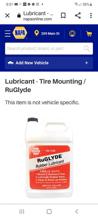

AMC RULES 37,260 #21 Posted November 6, 2021 The correct tire mounting spoons and a liberal application of this stuff will make all the difference too. 1 Share this post Link to post Share on other sites

AMC RULES 37,260 #23 Posted November 6, 2021 From my experience, screwdrivers and or prybars are rarely tube and rim friendly, and them inner tubes are no longer cheap. https://www.tractorsupply.com/tsc/catalog/inner-tubes?cm_mmc=SEM-_-Google-_-DynamicAdGroups-_-AllSiteTSCExtAd&gclid=Cj0KCQjwrJOMBhCZARIsAGEd4VFLuvVnAiwu7v6OZQcyVss5gXBROQJMrrMAi7QYUpY2j95EevyBn5YaAiniEALw_wcB 2 Share this post Link to post Share on other sites
