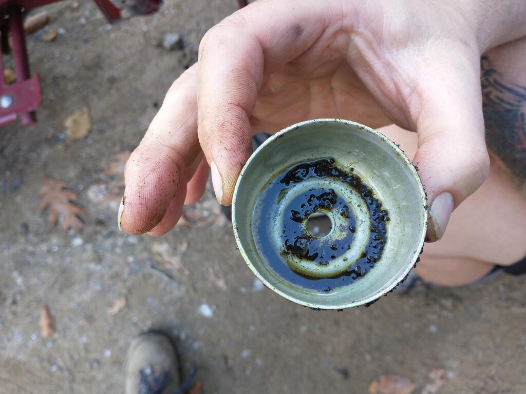

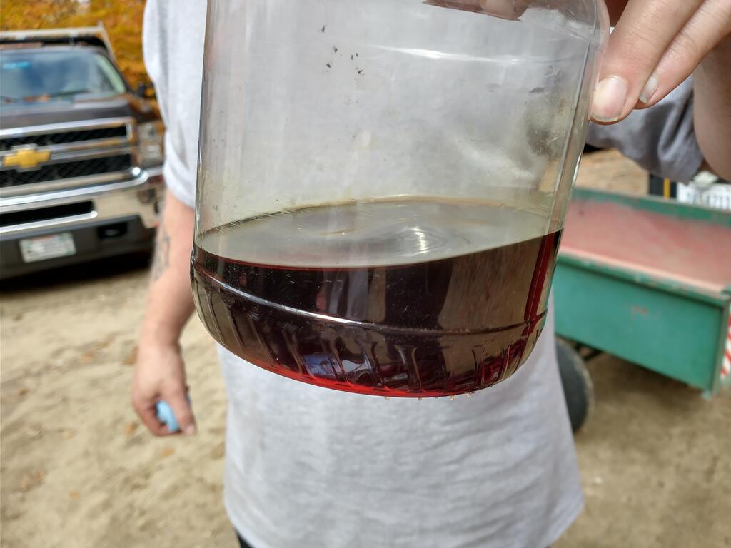

ebinmaine 80,641 #29 Posted October 31, 2021 2 hours ago, Pullstart said: So you and BBT and keeping them all? I was wondering how many were for you’s and how many were for @JCM… The future of the 2 417As is yet undetermined. They'll be here for a bit at least. 2 hours ago, SylvanLakeWH said: The 2 C160s are mine. The '75 Auto will likely be the plow beast for this winter. Jim and I both drove it around the yard a minute or 3 today after some maintenance was done to get it running. I drained the old gas, changed the fuel line. Added a fuel filter. Cleaned the points. Changed the sparking plug. Removed and cleaned the fuel bowl which was right full of muck. Removed the air filter and left it off. Filthy! Someone had bypassed the fuel pump. Fixed that. The brake pedal was able to slide down beside the safety switch. Adjusted that. I used the @wallfish method of blow in tank to prime fuel. It started up and rumbled right to life. Here's the gas. Delicious fuel bowl contents 2 7 Share this post Link to post Share on other sites

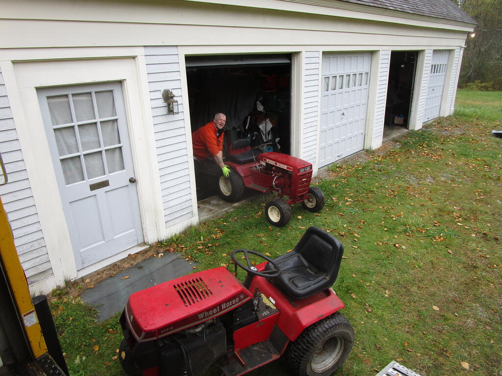

JCM 11,415 #37 Posted November 2, 2021 I figured it's about time to congratulate @ebinmaine on this past weekend score here so all his buddies can see what he's really like when content. You may see a difference in the before and after pictures. In the first picture he's like a kid on the 25th of December and on the second one he seems very happy looking for berries. I mean how many C-160's should a BEAR legally own ? Only he knows the answer to that question. Great job on that score Bear, and thanks for taking me along, much appreciated. 1 1 5 2 Share this post Link to post Share on other sites

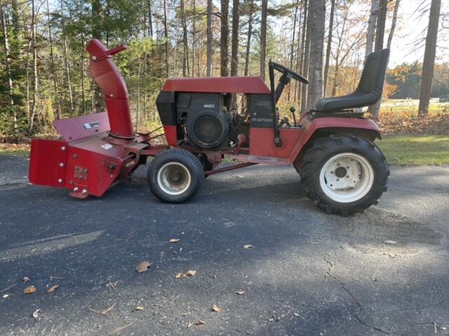

AHS 1,698 #46 Posted November 8, 2021 414-8 w/ loaded tires. Chains haven’t been put on! 2 2 Share this post Link to post Share on other sites
