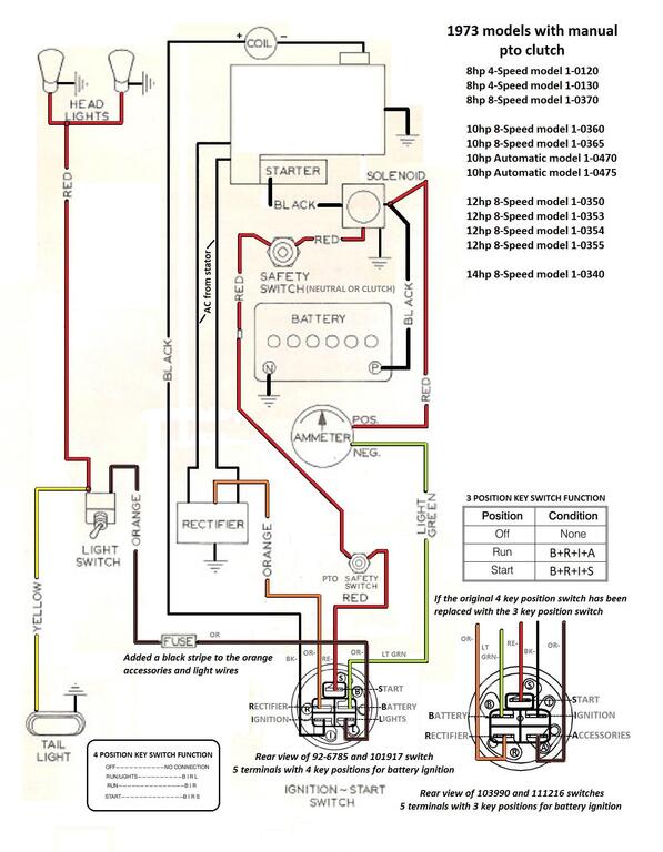

953 nut 64,651 #19 Posted October 24, 2021 9 hours ago, Wheelhorse#1 said: Wiring is confusing to me at times. The drawing below may help with your confusion. Each portion of the electrical system is separated from others so you can see what goes where. This is not a wiring diagram for your tractor as it has no safety switches. It is drawn with the 103-990 ignition switch. 1 Share this post Link to post Share on other sites

gwest_ca-(File Mod) 12,067 #22 Posted October 25, 2021 A replacement wire holder for the switch terminals is available with and without wires. Click on the picture to see it. Makes a nice installation. The wires colors do not match what we have. 2 Share this post Link to post Share on other sites
