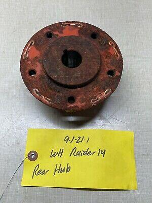

Snoopy11 5,731 #4 Posted October 14, 2021 I am kinda looking for something like this... Don Share this post Link to post Share on other sites
pfrederi 20,869 #5 Posted October 14, 2021 (edited) 1 hour ago, Moparfanforever said: Not in my shop to check , but I was thinking the three hole hubs lined up with three holes in a five hole hub ?? If so , maybe use a five hole spacer ?? They do not line up not even close. 3" from one hole to the next one. Not sure how you measure 3 hole patterns. \ \ EDIT The bolt holes on a 5 lug QH hub are 2 1/4" form center of axle. Lawn Ranger are 1-3/4" from center of axle... Edited October 14, 2021 by pfrederi Share this post Link to post Share on other sites
Maxwell-8 4,371 #6 Posted October 14, 2021 5 on 4.5 pattern is what is just on the 5 bolt Wheel Horses. You will need longer bolts if you run spacers. Share this post Link to post Share on other sites

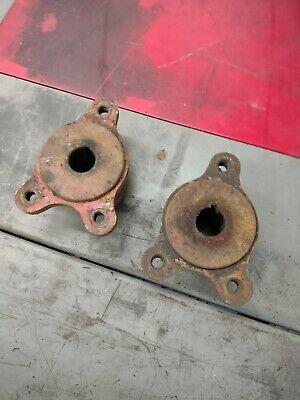

Snoopy11 5,731 #11 Posted October 15, 2021 Here is an old picture, just in case you guys need to verify the three bolt triangle... Don Share this post Link to post Share on other sites

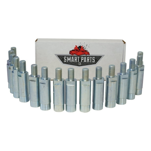

Snoopy11 5,731 #15 Posted October 15, 2021 One of my buddies just told me about the above... wheel stud spacers for winter when I have chains on the tractor. Obviously wouldn't be something I would leave on all the time... although ATV nuts supposedly have good luck with them... Whatchya think, guys? Don Share this post Link to post Share on other sites

8ntruck 9,048 #18 Posted October 15, 2021 1 hour ago, Snoopy11 said: I wonder how these would work? https://www.amazon.com/gp/product/B00CA98OUC/ref=ox_sc_act_title_1?smid=A11AMJP7SLFKZ2&psc=1 Don The retired steel wheel engineer here would not use these. 3 Share this post Link to post Share on other sites

ebinmaine 79,685 #21 Posted October 15, 2021 14 hours ago, 8ntruck said: The retired steel wheel engineer here would not use these. I concur 15 hours ago, Snoopy11 said: ATV nuts supposedly have good luck with them A lot of ATVs are lighter than a lot of garden tractors although I realize you're hell horse is fairly small. Those type of spacers at that length just don't make me feel warm and fuzzy. Was it me, I would get a stud kit and use appropriately sized half inch thick spacers between the wheel and the hub. Or.... Something along this idea: https://www.titanwheelaccessories.com/products/1-2-flat-wheel-spacers-adapters-5x4-5-wrangler-tj-yj-xj-kj-kk-zj-mj-billet-forged?variant=27947940118551¤cy=USD&utm_medium=product_sync&utm_source=google&utm_content=sag_organic&utm_campaign=sag_organic&gclid=CjwKCAjwzaSLBhBJEiwAJSRokh6ma9OpcUiQdjWqfM9kDt0W1e63S1iN-5Rj7y-M2UddFNyg10EpMxoCdg4QAvD_BwE 1 Share this post Link to post Share on other sites
