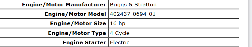

Bill D 3,213 #60 Posted October 8, 2021 (edited) 2 hours ago, Horse Newbie said: Alright fellas, I'm throwing a lifeline ! I AM NOT an engine mechanic ! @ebinmaine , @pullstart , @lynnmor , @Handy Don , and all the rest of the calvary... Can I order carb parts using just what I suspect is the engine model number- 402437 ? The carb on my 16 hp twin Briggs has absolutely no markings. So far I will be needing... 1. Intake manifold gaskets. 2. Carb to intake gasket. 3. Carb top to carb body gasket. 4. O-ring for main jet access/ drain plug. 5. Hinge pin for float. Can you answer these questions for me ? 1. How does the float needle valve attach to the float ? See the pic and notice the small wire wire. 2. Does the needle valve hang on the float by the wire as pic shows ? But the rebuild kit for it. It will come with all the needed pieces to rebuild the carb and built in fuel pump. As to my post #55, if you're interested in spending the money I'm sure Scott could get more power out of it. If not, run a compression check on it and see if it had even compression on both cylinders. Rebuild the carb and see how it sounds. Leave the carbon alone and run serveral cans of Seafoam thru it to clean it out once it's running. The engine numbers should be stamped into the tinwork over the front cylinder. The first two digits of the code is the year of manufacture. Edited October 8, 2021 by Bill D 1 Share this post Link to post Share on other sites

Gregor 4,848 #70 Posted October 8, 2021 5 hours ago, Horse Newbie said: Can I order carb parts using just what I suspect is the engine model number- 402437 ? This is according to Wheel Horse manuals. When I ordered the kit for my M18, it came complete with all the parts to rebuild the integrated fuel pump as well. The kit contains parts for many different carbs. Use what you need, discard the rest. I got lucky, my local home/farm store had the kit on the shelf. Briggs # 694056. Google it, lots of choices out there. Anywhere from 8 - $25. When I pulled the intake, the gaskets came off perfect, so I reused them. The following is for a Wheel Horse GT 1600. I don't know what the differences are between a WORK Horse and a WHEEL Horse. 1 Share this post Link to post Share on other sites
