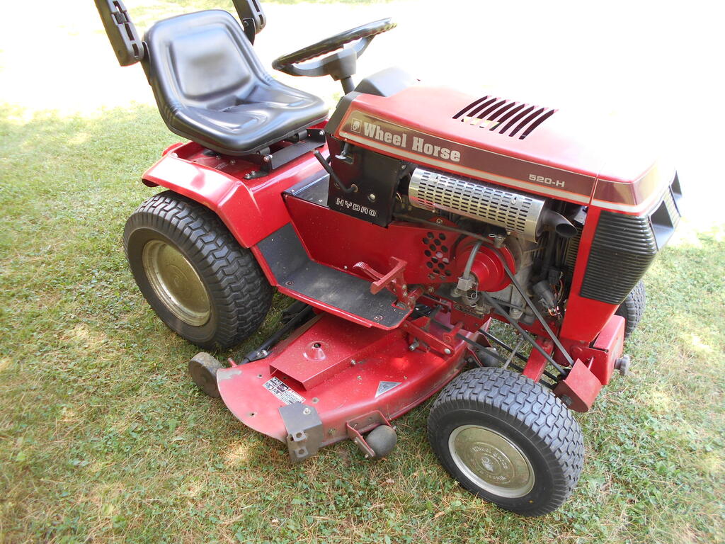

cleat 9,005 #11 Posted July 10, 2025 Here is my 520 with the 48" deck with the power flow bagger pulley used as a center drive pulley. Blade speed is definitely increased but still seems well within limits. I just got finished mowing, that is why the machine is dirty. 2 Share this post Link to post Share on other sites
kpinnc 18,740 #12 Posted July 11, 2025 15 hours ago, cleat said: just got finished mowing, that is why the machine is dirty. Good grief @cleat!!!! I've never seen one of your machines dirty before! 1 Share this post Link to post Share on other sites
Lee1977 7,709 #13 Posted July 11, 2025 That's not dirty down here. when it's dry down here our Wheel Hoeses turn brown. Share this post Link to post Share on other sites
