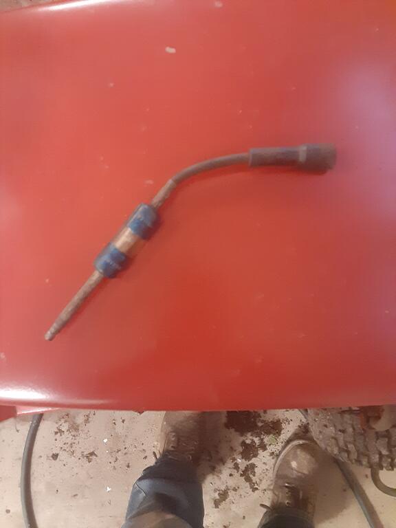

Oldskool 6,678 #58 Posted September 19, 2021 9 hours ago, diesel cowboy said: The inline testers are good for the newer engines but on the old one can give a false reading. The best ones to use on them are the old ones that let you see the spark when it jumps so you can tell what color and how thick it is. This is the tester I was using. I'm going to go thru things one more time this morning. Clean and re-gap the points and re-time. If I can't get it to fire this morning I will unfortunately have to move on to other things. I did cycle each cylinder stopping at each valve movement and blew compressed air in to see if there was a blockage or any sort keeping the gas from getting in. While doing this I did notice some air coming out thru my bowl gasket which tells me the Zenith carb is a bit warped. So now with an air leak and possibly a weak coil I feel I'm just banging my head off the wall. 1 Share this post Link to post Share on other sites

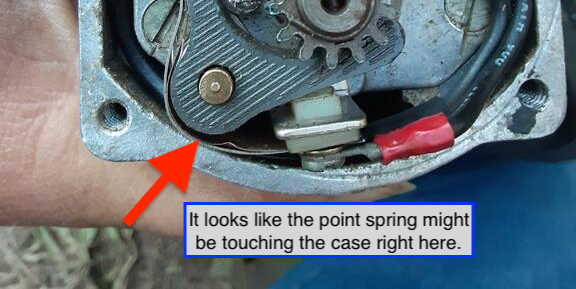

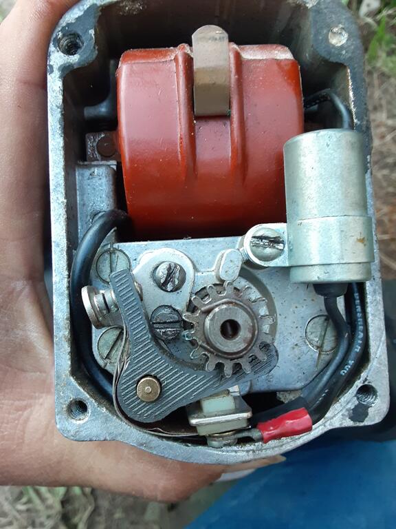

diesel cowboy 263 #61 Posted September 21, 2021 Yeah that's probably a big part of the problem. Nothing looks out of place to me on how the points are setup, so I wonder if one of the wires running up behind the coil might have a tiny hole in the covering that's causing it to bleed part of the spark to the case. Ran into something like that years ago on one of my Farmalls. The plug wires on that ran through a long tube around the engine and when cranking it there'd be weak erratic spark at the plugs. Finally found that when it bit me when I had someone else crank it and I had my hand on the tube trying to adjust the mag. It was sparking out of the tube to the block 2 Share this post Link to post Share on other sites
Oldskool 6,678 #63 Posted September 21, 2021 7 hours ago, diesel cowboy said: Yeah that's probably a big part of the problem. Nothing looks out of place to me on how the points are setup, so I wonder if one of the wires running up behind the coil might have a tiny hole in the covering that's causing it to bleed part of the spark to the case. Ran into something like that years ago on one of my Farmalls. The plug wires on that ran through a long tube around the engine and when cranking it there'd be weak erratic spark at the plugs. Finally found that when it bit me when I had someone else crank it and I had my hand on the tube trying to adjust the mag. It was sparking out of the tube to the block I had a chance last night to mess with it a bit after dark. All the wires look good. I do have spark. It's very intermittent to none. Yellow to blue. I also noticed some slop at the pivot point of the fiber arm of the points. I ordered new points and condenser last night. Do you know what the coil should test out at with an analog multimeter? Share this post Link to post Share on other sites

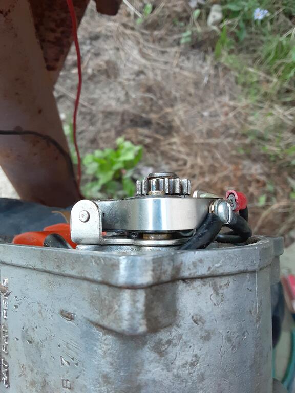

Oldskool 6,678 #64 Posted September 21, 2021 7 hours ago, Handy Don said: I showed that pic to a friend that thought the same thing. The points are actually outside the housing. 1 Share this post Link to post Share on other sites

Handy Don 17,393 #70 Posted September 21, 2021 3 hours ago, Oldskool said: The points are actually outside the housing. Thanks! Got fooled by the perspective. (Was hoping for an easy solution, rats! ) 2 Share this post Link to post Share on other sites

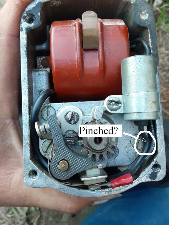

diesel cowboy 263 #72 Posted September 21, 2021 7 hours ago, Oldskool said: I had a chance last night to mess with it a bit after dark. All the wires look good. I do have spark. It's very intermittent to none. Yellow to blue. I also noticed some slop at the pivot point of the fiber arm of the points. I ordered new points and condenser last night. Do you know what the coil should test out at with an analog multimeter? I don't know how the coil should test out and the only thing I can find in my books is the condenser should test at .20 MFD +/- 10% I finally had a chance to ask my dad and showed him the pictures and he pointed out the condenser wire looks like it might've been pinched If it was and there's a spot on the back side you might not be able to see or hear the spark jumping, plus it's touching the mounting plate and could cause it to have continuity when the points are open. He also said that any dirt/dust build up in the cap or mag body will let it arc internally and might not be visible 1 Share this post Link to post Share on other sites
Oldskool 6,678 #73 Posted September 21, 2021 1 hour ago, diesel cowboy said: I don't know how the coil should test out and the only thing I can find in my books is the condenser should test at .20 MFD +/- 10% I finally had a chance to ask my dad and showed him the pictures and he pointed out the condenser wire looks like it might've been pinched If it was and there's a spot on the back side you might not be able to see or hear the spark jumping, plus it's touching the mounting plate and could cause it to have continuity when the points are open. He also said that any dirt/dust build up in the cap or mag body will let it arc internally and might not be visible I'll check out that pinch point after work today. I did try blowing any dirt, dust, debris out of the body. It seemed quite clean. As far as the spark goes, I was testing it in the dark so I could see. I didn't see any elsewhere but I'm not saying there wasn't any. I'm hoping to have the new points and condenser by the weekend. Share this post Link to post Share on other sites
