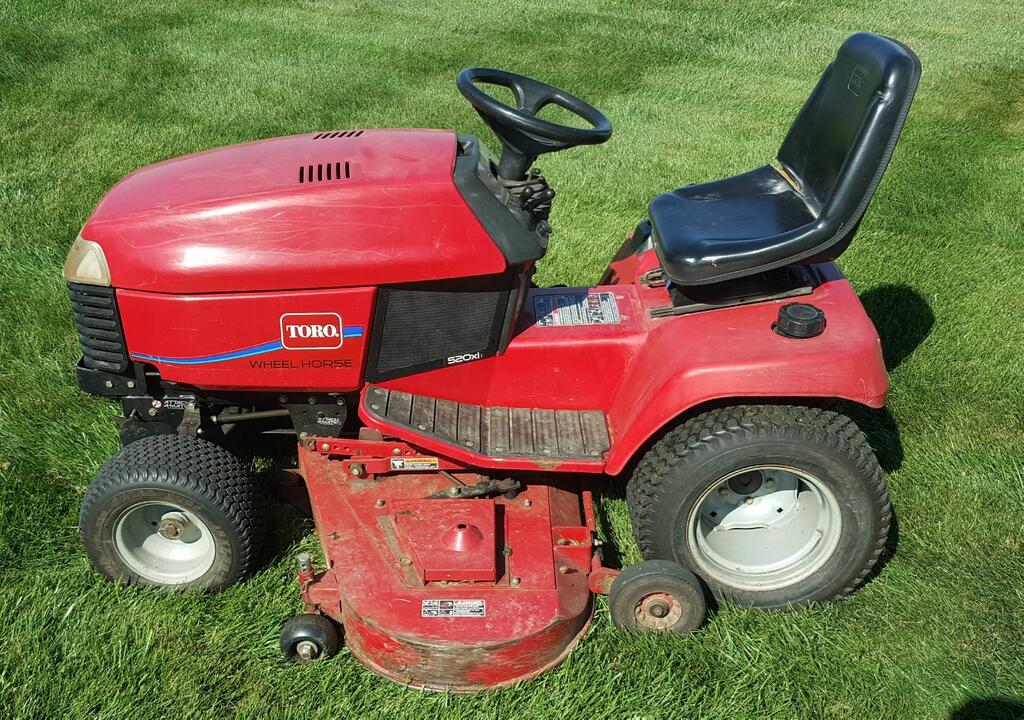

Shuboxlover 490 #1 Posted August 31, 2021 Just brought home my first 520xi I've ever had. It has 760 hours on it, is in pretty descent shape and came with a really nice 60" deck, The motor runs great but the hydro has an issue I think. When you press the foot pedal, it will go full speed then slow down, then speed up over and over again surging. Is this the classic sign of a weak hydro pump, or is there something else easier I should start with? Thanks in advance 1 Share this post Link to post Share on other sites

shallowwatersailor 3,222 #19 Posted September 1, 2021 Depends on your area plus it is getting close to the end of lawn cutting season. Some areas the 60 inch deck is a deterrent. Larger properties will like the 60 inch deck. Value is probably around $1,000-$1,400 given the hours and condition from the photo. Share this post Link to post Share on other sites
