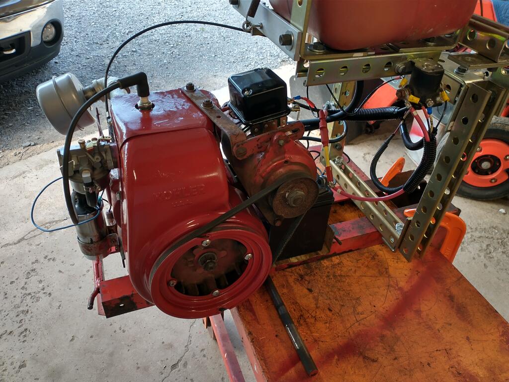

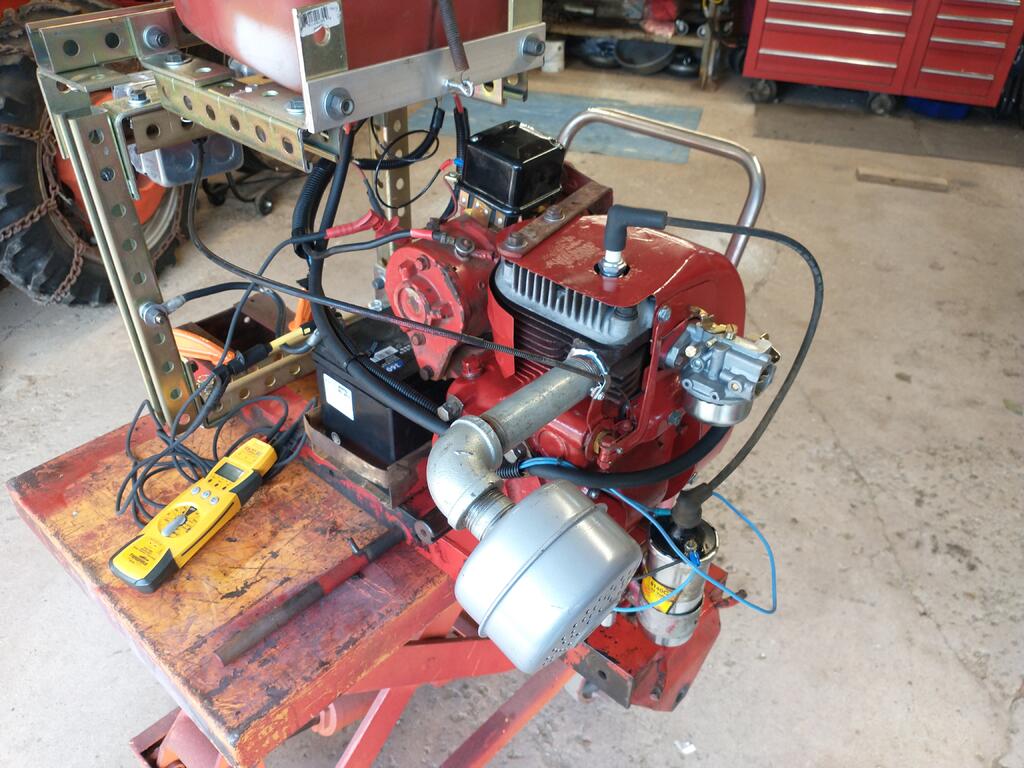

squonk 48,156 #1 Posted August 29, 2021 (edited) Finally got one of these junkyard engines together. Much Thanks to @oldredrider for the needed parts. And @rjg854 for the Kabitzing. Couldn't run it long as it's still early Sunday morning. A little noisy due to bad genny bearings. It isn't charging either going to have to look into that. Also the China carb needs some tuning. Plan on breaking this engine in on this stand then putting it on the shelf. Edited August 29, 2021 by squonk 12 3 Share this post Link to post Share on other sites
formariz 12,381 #2 Posted August 29, 2021 I like the test stand idea. Tell us a bit more about it . Set up for most engines electrically? Share this post Link to post Share on other sites
squonk 48,156 #3 Posted August 29, 2021 Right now it's wired for the starter gen design. I believe it would wire right up to a normal starter engine. Just move the big lead from the solenoid that attaches to the gen to the starter terminal. If I mount a 3 terminal voltage regulator on it I believe the bat wire I have hooked to the gen voltage reg would attach to the bat terminal of the 3 terminal regulator and the stator wires would attach to the reg. Should be a simple switchover. 1 Share this post Link to post Share on other sites

squonk 48,156 #18 Posted August 30, 2021 Engine has been run 2 hrs. on the stand. Ready to put on the shelf. Going to rebuild a Genuine Kohler carb. This China one is almost as bad as a Genuine Tecky carb! So to recap. Engine wouldn't run when I got it because of the points lobe being 180 degrees off. Repairs as follows: 2 piece cam replace with one piece cam Cracked main bearing boss welded Broken governor shaft replaced Seized governor gear replaced Valves and seats ground Connecting rod turned around so oil hole is on the correct side. 1 2 Share this post Link to post Share on other sites
