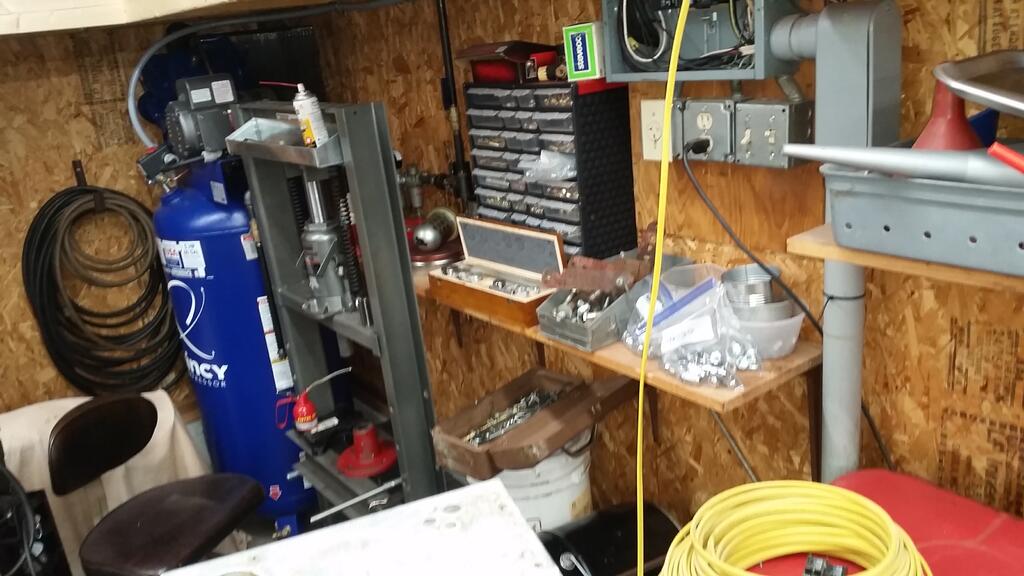

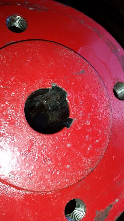

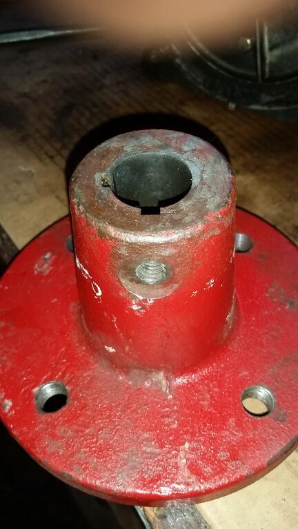

WHX?? 58,069 #1 Posted August 17, 2021 (edited) Well that's what it may come to a hub it comes to my shop! So go to pull a new 220 volt line to the new shop AC and the power box is in the corner by the press and I notice this hub for a 953 sitting on it. Now I got some tractors sitting in pieces in the shop but I don't recollect a 953 being one of them. Ok whats this for or better yets whose i?!?? After much It finally dawns on me that @953 nut gives me a bag of crap at the BS to put a new key way in! Well duh maybe that's why it was sittin on the press. Never claimed to be the sharpest knife in the drawer! You'll be happy to know Richard I sat down right then and there and giterdone! I only had it what since what June? Took a whooping 5 minutes! Sides it beat climbing in a very hot attic and rolling in fibergla$s. Goes to show how long I seen this corner of the shop. Gotta blame it on @Achto and all his stupid tractor shows just about every weekend. Yah my garage starting to look like his! Hope I didn't set your project back by years Dick! Came out good tho Richard. I put the new keyway in line with the back set screw figurin a guy could put a new set screw in line over the back one. Hub was pretty messed up too....awful hard on the equipment ain't we Mr. Schmidt ?!?!? 'pose you gonna tell us you got it that way! Let me know if you want that set crew put in ...I'll get at it next year.... Now for that wiring..... nawwww it's Miller time! Edited August 17, 2021 by WHX?? speeling 3 5 Share this post Link to post Share on other sites

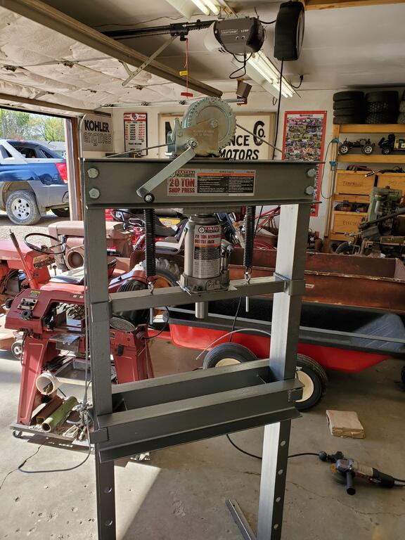

WHX?? 58,069 #5 Posted August 18, 2021 (edited) Yeah got tired of moving the bed up and down.... even better idea is @prondzy has got the same press and he rigged up a winch of sorts to move the apron up and down. Pic Mike??? The cheaters don't have to be much, mine are just old scrap 3/4 round stock but 3/8 would work. Found out with these longer hubs the broach has to be pushed down past the bushing so a longer 1/4 bolt worked perfect. Edited August 18, 2021 by WHX?? Share this post Link to post Share on other sites

prondzy 3,890 #13 Posted August 18, 2021 17 hours ago, WHX?? said: Yeah got tired of moving the bed up and down.... even better idea is @prondzy has got the same press and he rigged up a winch of sorts to move the apron up and down. Pic Mike??? The cheaters don't have to be much, mine are just old scrap 3/4 round stock but 3/8 would work. Found out with these longer hubs the broach has to be pushed down past the bushing so a longer 1/4 bolt worked perfect. 2 1 Share this post Link to post Share on other sites

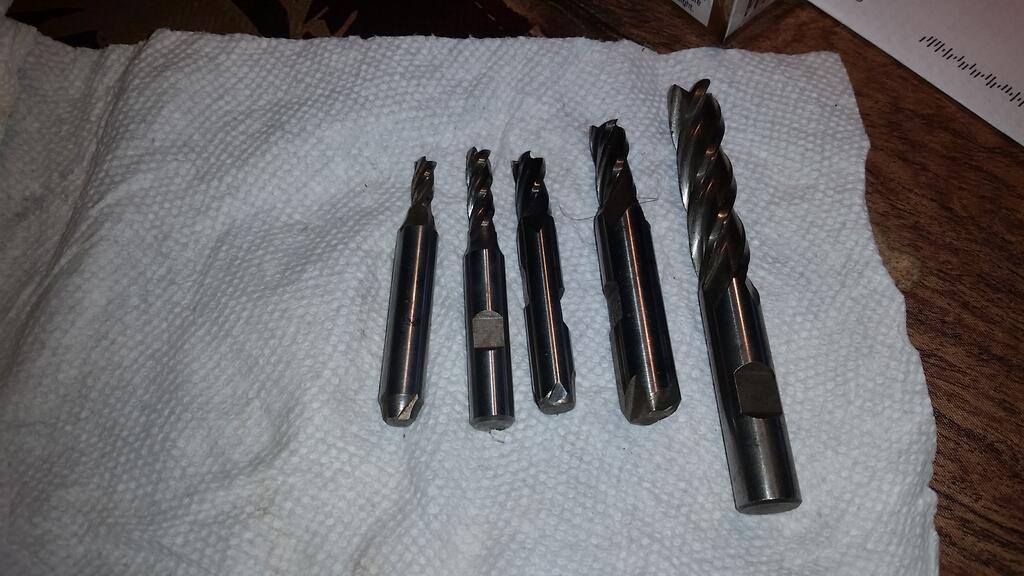

WHX?? 58,069 #16 Posted August 25, 2021 Like these ? https://www.mcmaster.com/counterbore-tools/ @JPWH sent me some mills I am going to try on a scrap 520 hub. Even if they don't work I see a dozen uses for these. Thank you Jay! 1 Share this post Link to post Share on other sites
JPWH 6,544 #17 Posted August 26, 2021 @WHX?? If those won't work for you I may have a counter bore. I will look tomorrow. Just got in from Milwaukee a couple hours ago. Jay Share this post Link to post Share on other sites
953 nut 69,147 #18 Posted August 26, 2021 23 hours ago, WHX?? said: Like these ? https://www.mcmaster.com/counterbore-tools/ Those are very nice but I was considering a simpler solution. I was thinking that after the 5/16" pilot hole is drilled a standard 3/4" HSS bit drilled down a short distance would give the end mill a place to ride without wondering. 1 Share this post Link to post Share on other sites
WHX?? 58,069 #19 Posted August 26, 2021 Good idea Richard I like that. 11 hours ago, JPWH said: Just got in from Milwaukee Really Hank what was ya doin in Brewtown ? Get to take in a Brewers game? Tour of the Harley Museum? Share this post Link to post Share on other sites
