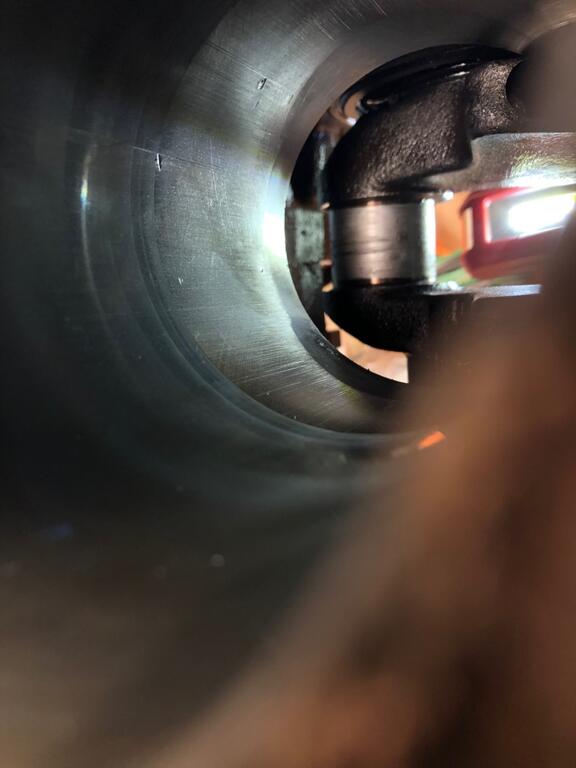

oldredrider 2,554 #26 Posted August 17, 2021 (edited) 15 hours ago, squonk said: Crank can possibly be ground to .020" under and use a .020" undersize rod. Cylinder can be sleeved. @oldredrider The last Kohler I had sleeved was a K341. Already bored .030 and had deep gouges. My machinist sleeved, bored to standard size and recut valve seats. Charged me $80. This was before we became good friends and now share a common interest: Wheel Horses. He now has more of them than I do. The hardest part nowadays is finding a machine shop to work on small engines. Fortunately, my machinist has a boring machine he leaves set up for my work. Edited August 17, 2021 by oldredrider 2 Share this post Link to post Share on other sites

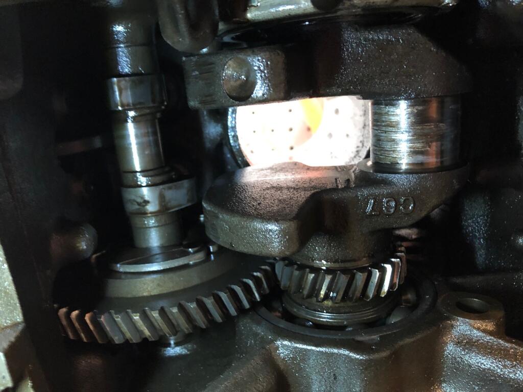

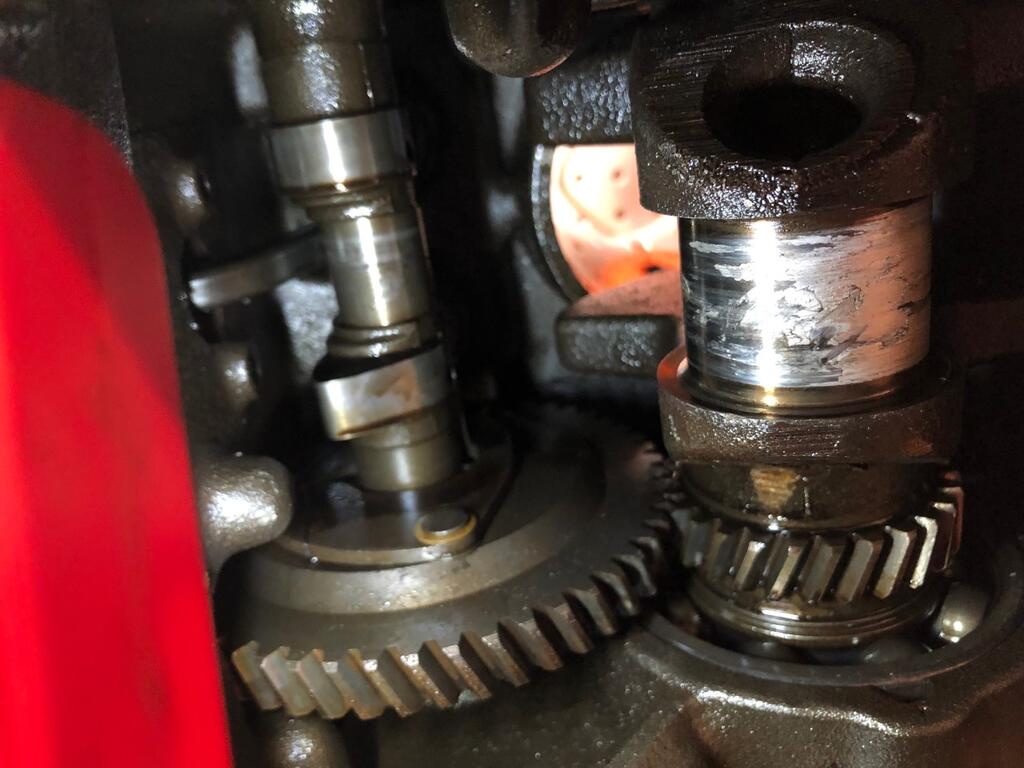

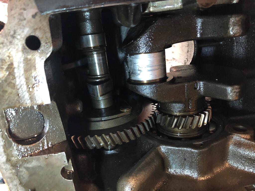

OutdoorEnvy 1,817 #27 Posted August 17, 2021 13 minutes ago, 953 nut said: How much oil was in the engine? How many hours was the engine run following the rebuild? With everything else being well oiled and that much aluminum build-up on the crank it looks like it wasn't getting enough oil to the crank. Wonder if the oil hole on the crank was placed away from the cam? With the block already being +20 needing to be sleeved and the crank being questionable I would start looking for a replacement engine, You will end up being north of $ 450 to fix this one. Not sure on the exact oil amount. What I drained out was very thin. I just picked this up recently. It hasn't run in decades...No idea on hours...Head when pulled did not have excessive carbon build up at all. Yeah if I can't figure out a cost effective way to get it running I will look for a parts tractor with a better kohler candidate. They pop around here somewhat regularly for reasonable pricing. Especially John Deere's. Any 10-16hp single cylinder kohler would work for me. 9 minutes ago, squonk said: Even IF you could run it with that gouge, you still need to check that cylinder for out of round and taper. Who knows how many hours are on it since it was rebuilt once If I get a bore gauge would I have to measure with a micrometer or would a digital caliper that goes to thousandths be acceptable accuracy? Also was thinking the caliper could measure the crankshaft journal? thanks again all the help and suggestions...it's fun learning this stuff Share this post Link to post Share on other sites
953 nut 70,211 #28 Posted August 17, 2021 2 minutes ago, OutdoorEnvy said: oil amount. What I drained out was very thin. Could be the fuel pump diaphragm was leaking gas into the oil and that reduced it's lubricating ability. 5 minutes ago, oldredrider said: My machinist sleeved, bored to standard size and recut valve seats. Charged me $80. You are a lucky man, need to be good to him. I had to pay more than that for a + .030 bore job alone. 1 Share this post Link to post Share on other sites

richmondred01 2,393 #31 Posted August 17, 2021 (edited) I’ve been rebuilding these old Kohlers for 40 plus years. I still do 4-5 a month in retirement. I don’t believe in wasting my money or other peoples’ money (that includes not overlooking issues in an effort to save a few bucks.) Pay me now or pay me more later. With that in mind, after looking at the thread if you came to me with this engine I would say if you wanted it done right it would need to be sleeved and the crank ground. (You are already over .020 and that chip looks like .030 won’t take it out.) While in you have the engine torn down you might as well grind the valve seats and check the guides. If they are out of spec replace and ream new ones. The rebuild will be costly. If it was a k341 I would say it’s worth it but not a k241 wheel horse spec. (However, not all Kohler blocks are the same. The pto sides on some are machined and bolt patterns are different. Even something at simple as the placement of the oil dipstick will make a difference as to if it will fit into the specific application) Therefore, for some people finding the correct block is near impossible so the old block must be used and the additional machine work is required. Unless you have an emotional attachment to that engine, I would find a good running k301 or k321 and drop it in. That will give you an addition 2-4 hp as a bonus. That’s just my opinion I’m sure there’s a lot more opinions out there and I certainly hope that helps and I won’t be canceled by the recent wave of “wokeness”. All the best. Edited August 17, 2021 by richmondred01 5 4 1 Share this post Link to post Share on other sites

Snoopy11 5,731 #35 Posted August 17, 2021 (edited) 22 hours ago, OutdoorEnvy said: Alright more pics...it ain't good either. So it's had a rebuild already. which confirms why there was little carbon buildup on the head. Piston is .020 over already. It also has a small chip in the wall you can see on the last pic pretty well. So is it safe to say this block is done? Looks like some common aluminum to me... Soak that little A-hole (i.e. crankshaft --particularly the journal) in some muriatic acid (you can get this at any hardware store, including lowes in the paint section), wait until all the aluminum has come off (you will visibly see the aluminum bubbling off... but might take a while). Use fingernail file to go over the crankshaft journal all the way around. Here is the deal. When dealing with crankshafts, you never want your fingernail to hit any material. If your fingernail goes into a scratch... not so bad... this can actually give extra oil clearance, which can be a good thing. Once you go over the journal with a fingernail file, it should be smooth, possibly with some light scratching. This is fine. ANY time you clean with muriatic acid, you also want to soak it in a baking soda water mixture, very heavy on the baking soda... and then dry it, and use motor oil to rub on it or assembly lube. You never want to rebuild an engine if it has aluminum on the crankshaft... oil clearances will not be right. I would end up rebuilding and saving this engine... in spite of people saying how much work it would take... but that's just me... One of my Tillotson engines was 10 times worse than yours overall. Now screams 8-9 thousand rpms. Don Edited August 17, 2021 by Snoopy11 Share this post Link to post Share on other sites
WHX?? 58,341 #36 Posted August 17, 2021 3 hours ago, Snoopy11 said: rebuilding and saving this engine... I would too just for the challenge and a shelf spare when @pullstart blows one up at plow day. The 241 is just one of my favorite engines. I have no idea why. Sorry Snoopy that crank gets ground or a donor no doubt. I would want to start with a perfect crank. Sides SWMBO gets quite miffed when she finds her nail files in the shop. I got the frying pan once just 'cause my ignition file looked like one! For a 25 clam workin tractor tho Outdoor I think yours & Richmond's idea is best. 1 1 Share this post Link to post Share on other sites
Snoopy11 5,731 #37 Posted August 18, 2021 (edited) 19 hours ago, WHX?? said: I would want to start with a perfect crank. You might... and so would I... but I have done this on various engines, with very good engine performance over the long run. Never had a further issue after cleaning the crankshafts... You have to consider, race guys break rods all the time... but they don't replace crankshafts all the time. There is a method to their madness... Don Edited August 18, 2021 by Snoopy11 Share this post Link to post Share on other sites
squonk 48,303 #38 Posted August 18, 2021 Cleaning the crank is fine. But you better check or get it checked with a micrometer for out of round or you just going to blow it up again. 4 Share this post Link to post Share on other sites
Snoopy11 5,731 #39 Posted August 20, 2021 On 8/18/2021 at 3:39 PM, squonk said: Cleaning the crank is fine. But you better check or get it checked with a micrometer for out of round or you just going to blow it up again. Fergot to say that... Thanks Squonk Don Share this post Link to post Share on other sites
