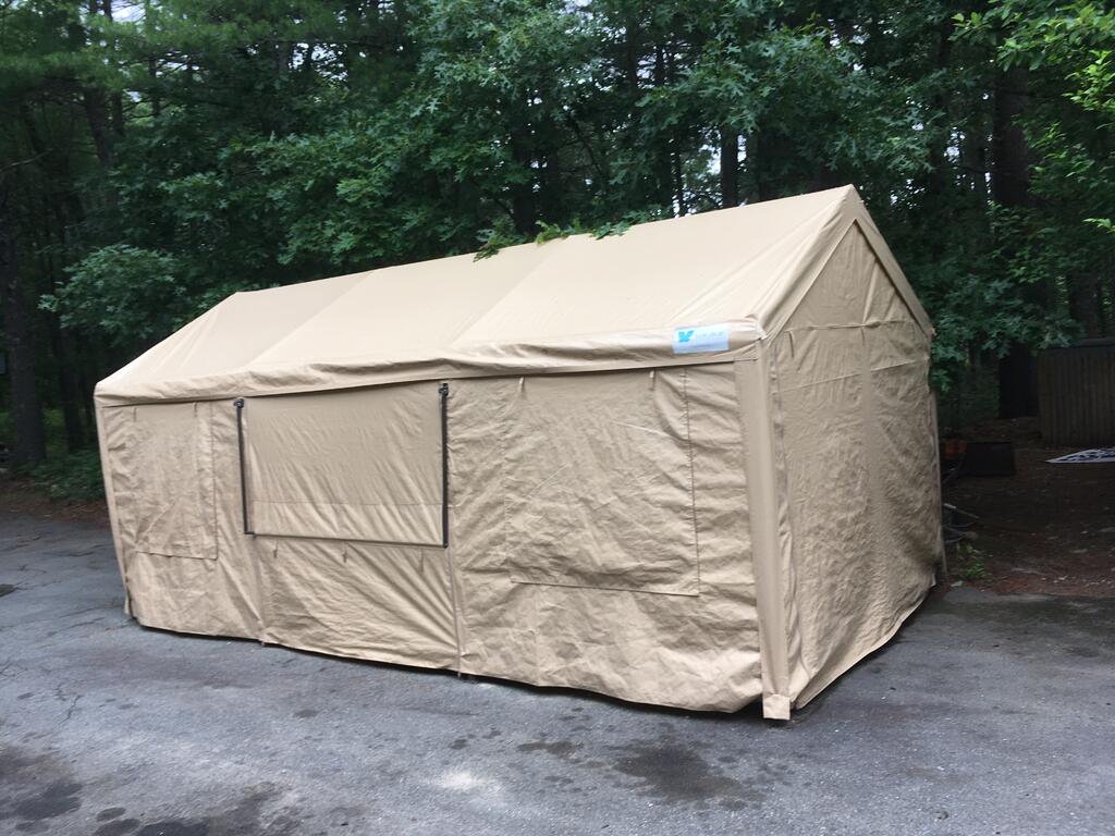

WheelHorse520H 710 #1 Posted July 8, 2021 I am not sure where to put this thread because of what my question is. I have a fabric carport for my 520-H as well as my car and some tables. I was trying to come up with a floor that allows water to pass underneath so I don’t grow mold on my . But I also want to work when / after it rains. Right now my driveway just soaks under the tent and I can’t work in there for days after it rains. I figured with all of the creativity on here I could find a budget friendly floor so I can work when it rains. Thank you all, any is appreciated. Share this post Link to post Share on other sites

RandyLittrell 3,946 #22 Posted July 11, 2021 Is your driveway asphalt? It looks it from the picture. If water is running under it, put the door on the downside and put 4x4's on the other three sides with adhesive to seal it with a few spikes to keep in place. You need ventilation up high to reduce moisture. You could even run a dehumidifier with a hose running out the downside. Randy Share this post Link to post Share on other sites
WheelHorse520H 710 #23 Posted July 11, 2021 Just now, RandyLittrell said: Is your driveway asphalt? It looks it from the picture. If water is running under it, put the door on the downside and put 4x4's on the other three sides with adhesive to seal it with a few spikes to keep in place. You need ventilation up high to reduce moisture. You could even run a dehumidifier with a hose running out the downside. Randy Yes it is asphalt, but three of the four sides have doors although the dehumidifier is not a bad move after hearing what @rmaynard went through. Share this post Link to post Share on other sites
RandyLittrell 3,946 #24 Posted July 11, 2021 Just now, WheelHorse520H said: Yes it is asphalt, but three of the four sides have doors although the dehumidifier is not a bad move after hearing what @rmaynard went through. If you can keep water from coming under the sides you will greatly reduce the moisture inside. Randy Share this post Link to post Share on other sites
