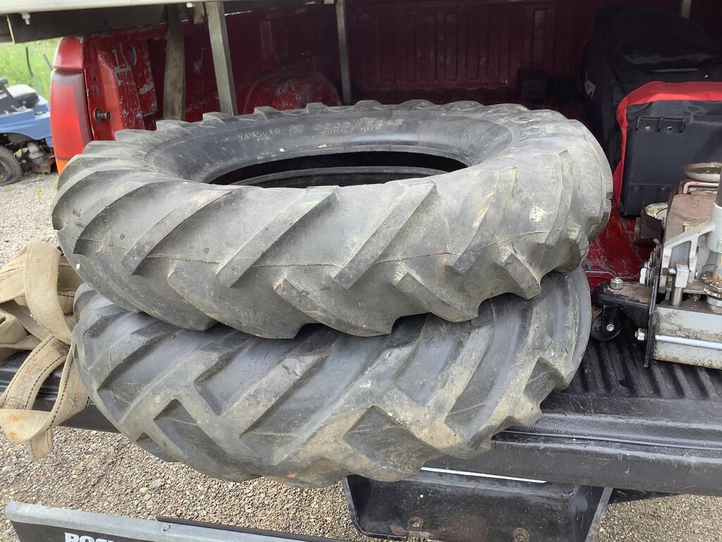

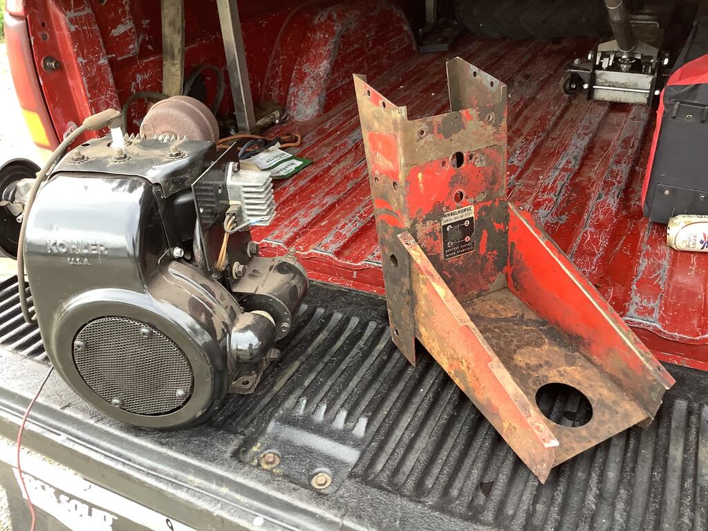

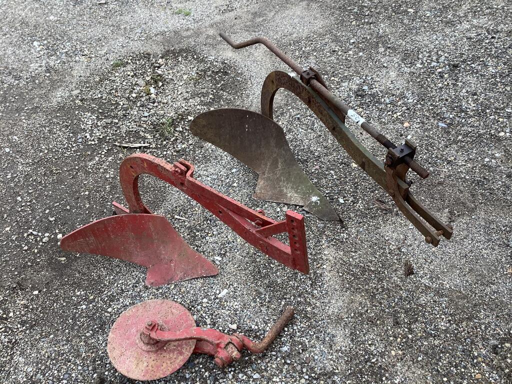

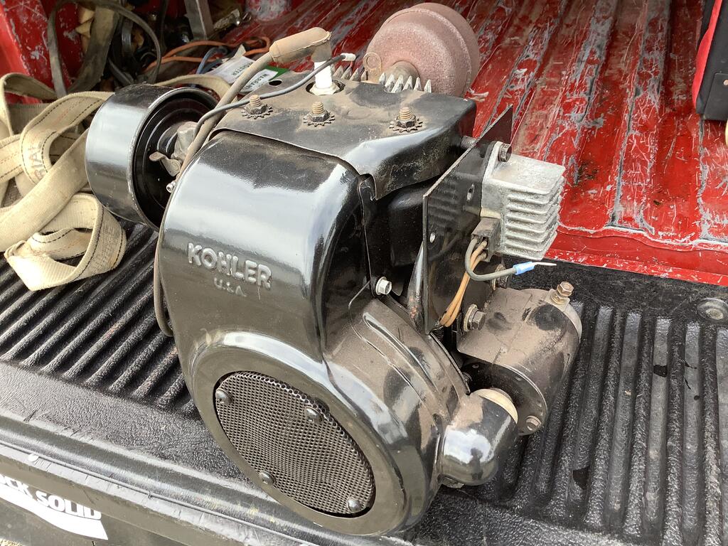

Pullstart 71,403 #1 Posted June 30, 2021 Of course I didn’t make any extravagant haul this year, but I still managed a few things. I found a dash stand for a ‘62 tractor. It’s not much special, but it would help if I choose to make another mock 1045 tractor. $5 well worth it! I also scored a running K-181 from @JoeM for a spare. This made me wonder though. Could a stator equipped engine be converted to @pullstart? It would be cool to feed some small draw LED’s automatically when it’s running. @roadapples gave me a couple one bottom plows. If I can set these up for a slot hitch, they could be “house loaners” at plow days if need be. @stevebo gave me these 16” AG tires. They don’t match, but they are a buttload better than the truck tires currently on Jackie! Mrs. P grabbed us one of Ehston’s (spelling?) tiny scaled Seniors too... so I guess you could say we did buy a tractor this year! I was trying to make a cheap round hood score at the end of Saturday, but neither of us would budge for $30 in either direction... so it stayed on his trailer. It was a basket case, but didn’t have to come home. 10 Share this post Link to post Share on other sites
Achto 32,845 #2 Posted June 30, 2021 10 minutes ago, pullstart said: Could a stator equipped engine be converted to @pullstart? It would be cool to feed some small draw LED’s automatically when it’s running. If it has a magneto ignition it would be very easy. If you wish to use the charging stator for lights or what not, I think that you will need to run some sort of battery in order for the reg/rec to work. 2 1 Share this post Link to post Share on other sites
Pullstart 71,403 #3 Posted June 30, 2021 1 minute ago, Achto said: If it has a magneto ignition it would be very easy. If you wish to use the charging stator for lights or what not, I think that you will need to run some sort of battery in order for the reg/rec to work. Good point. What’s the point of a charge coil and no starter? Share this post Link to post Share on other sites
Achto 32,845 #4 Posted June 30, 2021 7 minutes ago, pullstart said: What’s the point of a charge coil and no starter? Walk behind equipment is the only stuff I've seen with that type of application. Snowblower with lights for example. 1 Share this post Link to post Share on other sites
squonk 48,236 #5 Posted June 30, 2021 If it has the stator on it just leave the starter off and add a recoil cup and rewind assembly like off a 704 2 Share this post Link to post Share on other sites
pfrederi 21,240 #6 Posted June 30, 2021 Charge stators create AC LEDs like DC will need a diode....however the pulsing may cause flickering... 1 1 Share this post Link to post Share on other sites
