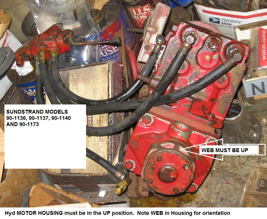

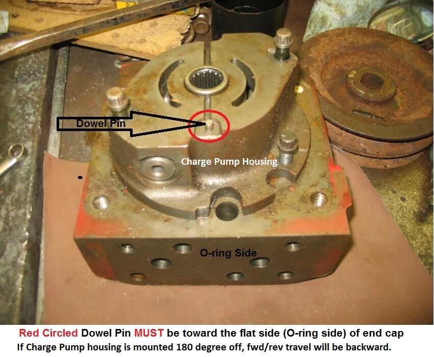

daveoman1966 3,884 #2 Posted June 15, 2021 (edited) I can only imagine...did you remove the CHARGE PUP HOUSING, then bolt it back on backwards? Edited June 15, 2021 by daveoman1966 WRONG PICS 1 Share this post Link to post Share on other sites

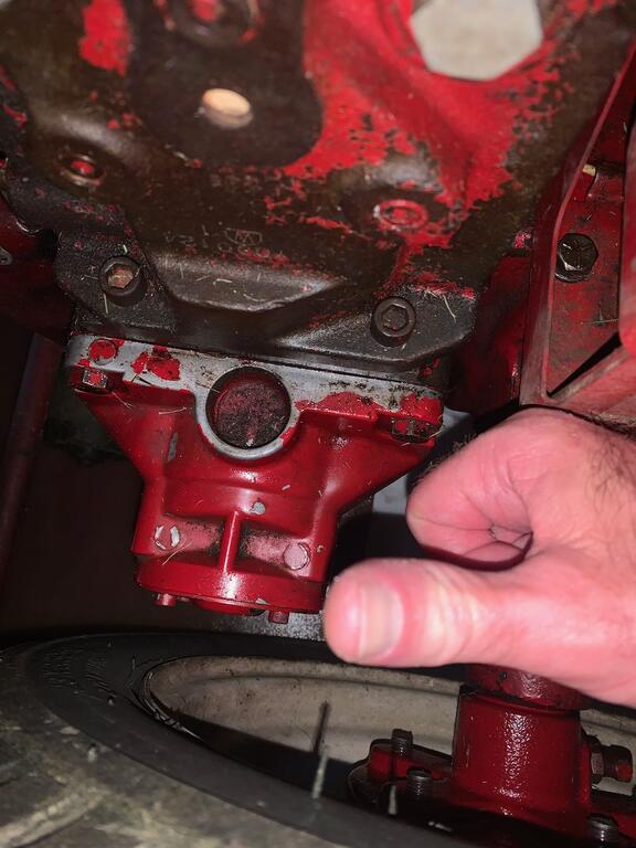

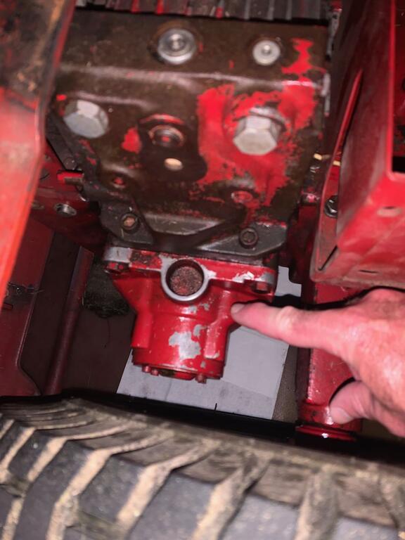

SteveInCA 3 #3 Posted June 15, 2021 Hmm - maybe. I'll look at that tomorrow when I have some daylight. Here's a picture of the charge pump housing that I believe you are referencing. I did wonder, but forgot until you reminded me, if there's a proper up or down for this housing. Inside it is slanted with the 8 or so pistons for pumping the fluid. I'll let you know what I find and if this is it, then I'm impressed with your reply being so quick, targeting something I thought but forgot, etc. Thanks for the pointer. Steve 2 Share this post Link to post Share on other sites
pacer 3,180 #4 Posted June 15, 2021 Yeah, IIRC you just turn that housing - happened to me a few yrs ago and I believe thats all you need. Heh, I remember what a shock it was when I got ready to back out of the shop and WHOA!! good thing I was several feet from my work bench, was almost a disaster when it went forward. 1 Share this post Link to post Share on other sites
daveoman1966 3,884 #5 Posted June 15, 2021 My apology...I posted parts of a HYDRO-GEAR and your is obviously a piston-to-piston system. Correcting all my comments, 2 1 Share this post Link to post Share on other sites

SteveInCA 3 #11 Posted June 16, 2021 To echo @Handy Don, dang you guys @daveoman1966 and @pacer are good. Rotating the Hydro Housing 180 degrees fixed the issue. I guess mechanically if the fluid flows backward the tractor goes backward regardless of the driver's intent. Thank you again for such a quick reply and expert advice!!! Next up for me is to fix the starter and tune up the Kohler engine. For the starter it just spins out of gear sometimes and a rotation with a screw driver typically does the trick. But I think my days of that hack are about up. I've found the following at isavetractors.com and YouTube that are giving me inspiration to keep the old gal running on. Starter: https://isavetractors.com/10-tooth-high-mount-starter-for-kohler-k-series/ Engine Tune: https://www.youtube.com/watch?v=btBG9RpGkdo&list=PLwvK0KSANhqBJHhBnJhhC9WQT2qLJcHoa Steve 1 Share this post Link to post Share on other sites
