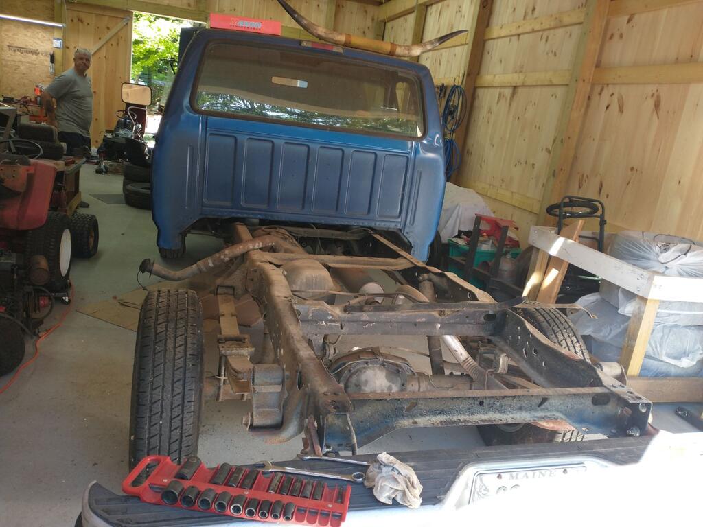

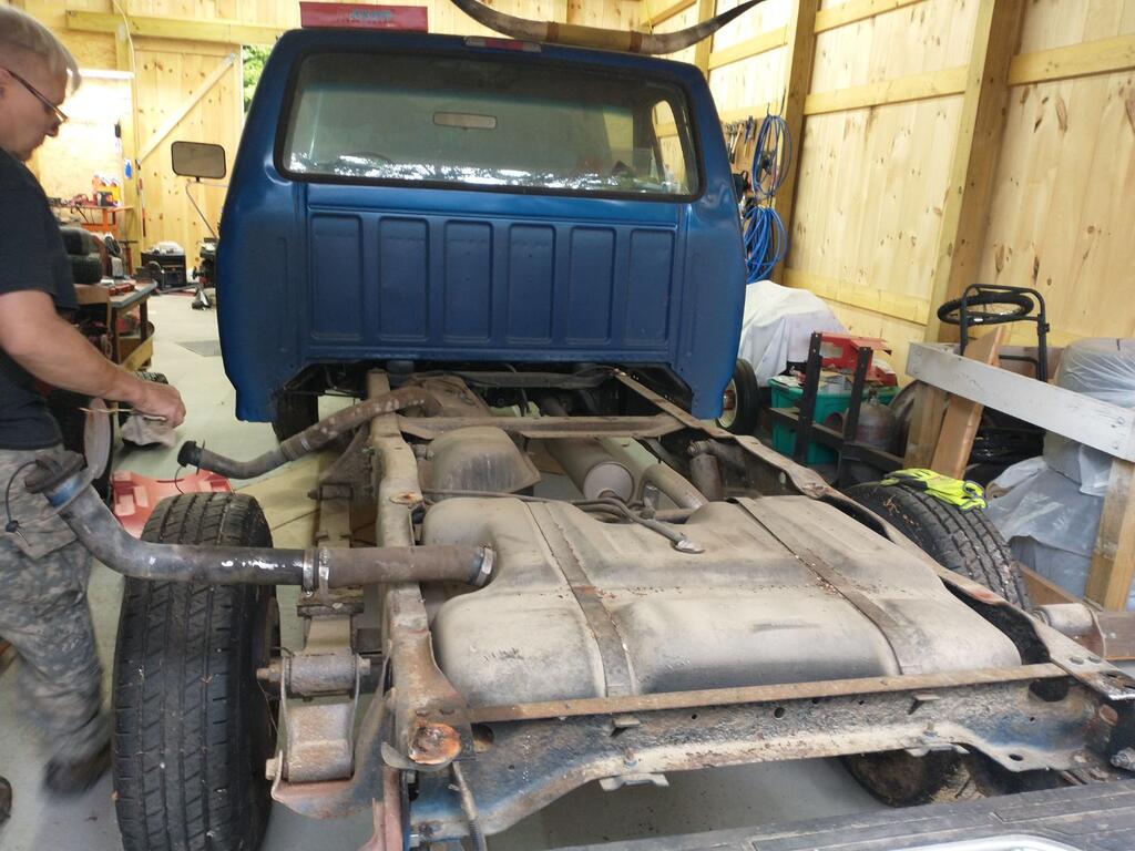

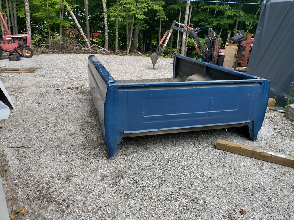

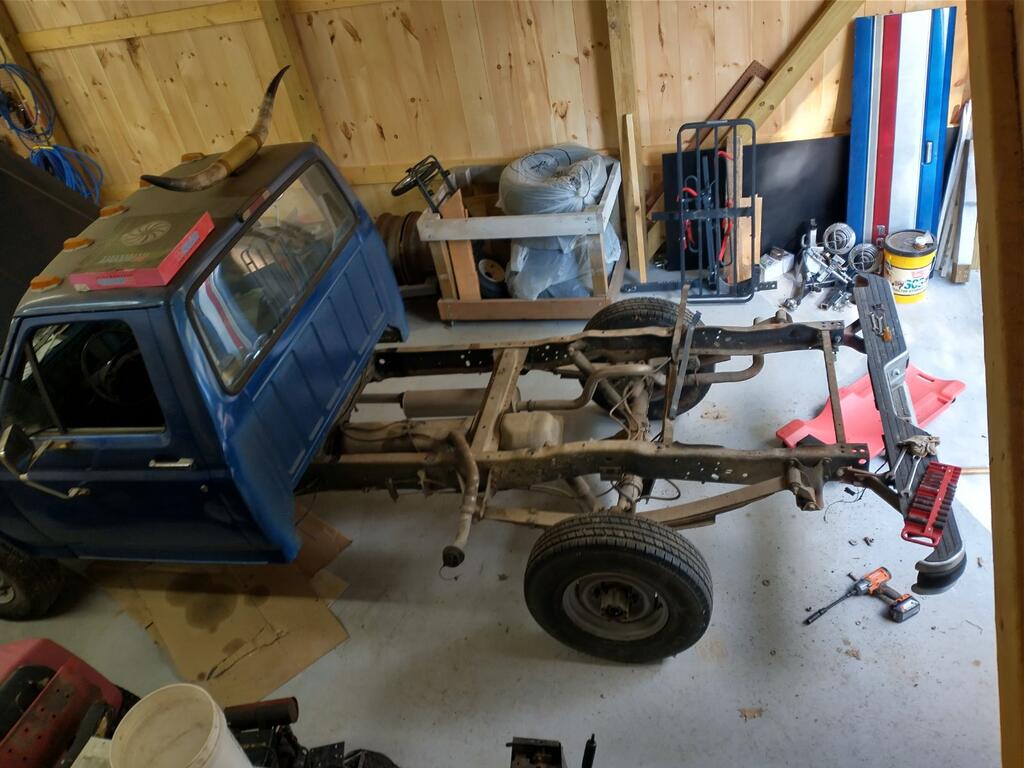

ebinmaine 81,278 #61 Posted August 12, 2024 (edited) We spent some time rearranging the barn workshop yesterday so we could spend some time these next few days getting back on the truck build. First task will be removing the bed and rear fuel tank for better access to the rear axle. The axle is being rebuilt with ALL new internal parts including Yukon yoke, Motive ring & pinion, and an Auburn Gear Company Limited Slip Differential. Stock 4:10 ratio. Of course all new bearings and seals. New brake shoes. The bed will be sold so I can build my own red oak & steel flatbed. The rear tank I'm not sure yet. I really don't need it more than once a year, if that. Any fuel left in it could easily go stale. Big issue there is it needs a distribution valve which I'd rather not buy. @87 416-8 horse Here's the list of performance parts i have purchased for the engine: Intake manifold. Clifford Performance single plane. Carburetor. Carter AFB (Aluminum Four Bore) 4bbl 500 CFM mechanical secondaries. Vacuum secondary carbs are easier to drive but I love having the control over exactly how much I open the venturies. I might put an extra spring on the secondary set so I can feel them detent to open. Exhaust. Ford original EFI split manifolds. Walker front pipe. 2 into 1. I went with a single exhaust partially for ease of exhaust assembly on a 4WD and also because I like the tone. Muffler to be determined. I'll go deep tone and not drag racer loud. Likely a chambered design similar to a Flowmaster 40. No catalytic converter needed here. Distributor. Custom built HEI done by Bill Ambler racing distributors specific for my engine. Camshaft. Jerry Cantrell at Schneider Cams made up a special Custom grind. Similar to: Part #13918-08. With stock rockers: Int. duration 208° at 050. .464 valve lift. Exh. duration 214° at 050. .472 valve lift. If/when I switched to a higher ratio rockers the lift would be: Int. .493 Exh. .502 Duration at .050 would also increase just a tiny smidgen. 108⁰ lobe separation angle. I kept LSA tight mostly for the raucous lumpy idle. A bonus of that is more low/midrange torque. With all the changes above this engine should pull like a train up to about 4500 RPM. Higher with a better cylinder head. I have a BUNCH of other things to put on. Some are repairs. Some are finishes I knew it needed. Some are accessories or changes specific to my desires. It'll be a constant work in progress for several years, forever really. Other changes for the future will be Four new leaf springs. Stock rears. 4"+ lift fronts to level the truck. Edited August 12, 2024 by ebinmaine Correct a brand name 6 1 Share this post Link to post Share on other sites
Pullstart 71,561 #62 Posted August 12, 2024 1 hour ago, ebinmaine said: The rear tank I'm not sure yet. I really don't need it more than once a year, if that. Any fuel left in it could easily go stale. Big issue there is it needs a distribution valve which I'd rather not buy. Norman has a 29 gallon transfer tank. It can gravity feed, so I have a solenoid valve draining fuel into my main tank. You could easily swap that distribution valve for a transfer pump. When I’m on a road trip, I get down to about 5/8 tank and flip the switch until it quits filling. I have no gauge on the transfer tank but I have a rough idea how many miles it’ll get me until I turn the valve off. You could keep it empty but for a few times a year to keep the whistle whet on the pump.. 3 1 1 Share this post Link to post Share on other sites
ebinmaine 81,278 #63 Posted August 12, 2024 14 minutes ago, Pullstart said: transfer pump That warrants further research! 1 Share this post Link to post Share on other sites
ebinmaine 81,278 #64 Posted August 12, 2024 This afternoon we got the bed taken off, rear hitch, and the rear fuel tank removed. We're gathering up parts this evening and seeing where we're at for installing the rear differential and gears. 5 1 Share this post Link to post Share on other sites
