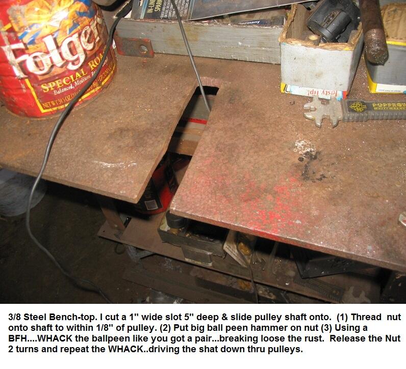

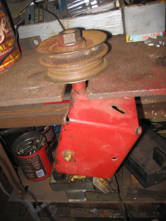

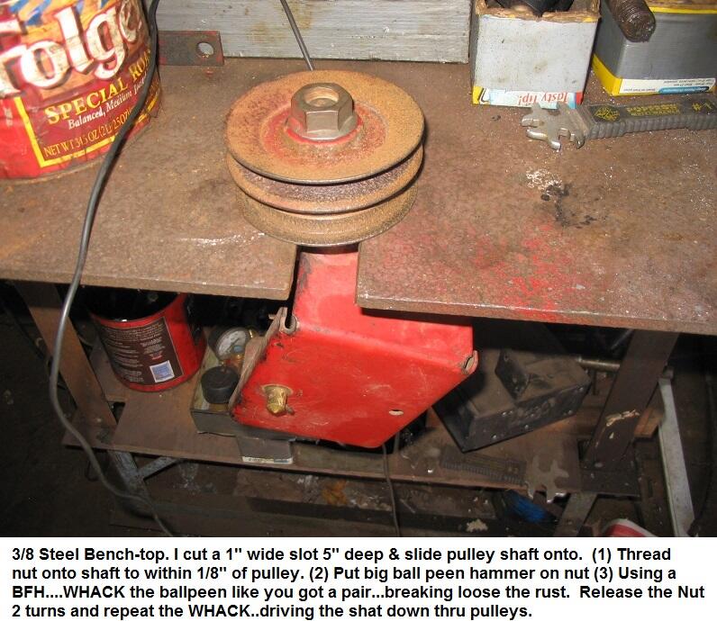

daveoman1966 3,884 #3 Posted May 24, 2021 Somtime they're stuck bad...but this has NEVER failed me. 3/8 Steel Bench-top. I cut a 1" wide slot 5" deep & slide pulley shaft onto. (1) Thread nut onto shaft to within 1/8" of pulley. (2) Put big ball peen hammer on nut (3) Using a BFH....WHACK the ballpeen like you got a pair...breaking loose the rust. Release the Nut 2 turns and repeat the WHACK..driving the shat down thru pulleys. 4 2 Share this post Link to post Share on other sites
