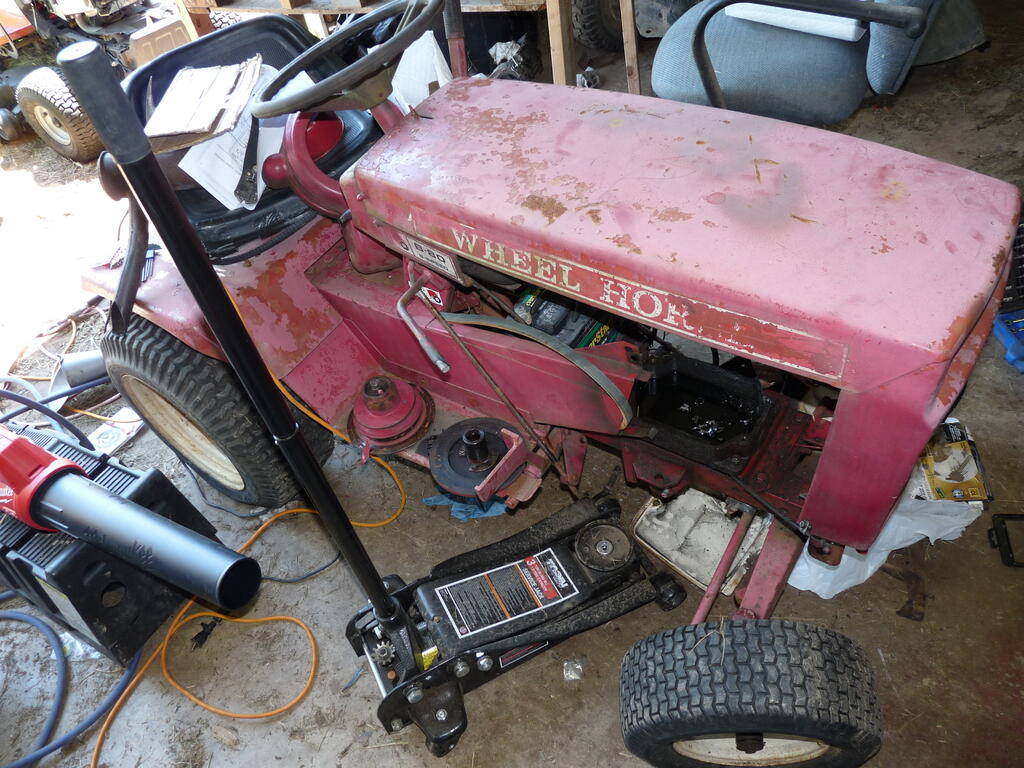

Jonnyrocket132 38 #1 Posted May 18, 2021 (edited) I just bought a B 80 that is in rough shape with the original K181 8 horse power motor for $50 but the rod let go and cracked the camshaft in half and it didn't damage the bore and everything else inside the engine is untouched by the debris because the guy that owned it before me was smart enough not to keep on turning the starter. does anyone know where I can find a cam shaft for this B 80 8 speed that isn't $200? Edited May 18, 2021 by Jonnyrocket132 1 Share this post Link to post Share on other sites

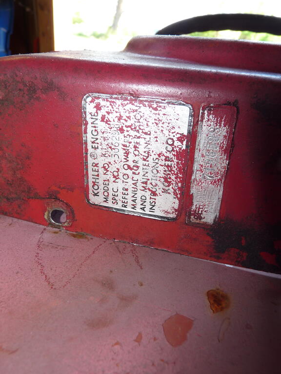

Jonnyrocket132 38 #17 Posted May 19, 2021 wait, so the B 80 is from 1964? I know I could look at the sticker that says the model number but the previous owner when he repainted it (with spray paint) he painted over the model number sticker Share this post Link to post Share on other sites

Jonnyrocket132 38 #20 Posted May 19, 2021 oh okay, because I have been trying to find out what year my B 80 8 speed manual is since you know the model number sticker was painted over Share this post Link to post Share on other sites
WHX?? 56,106 #21 Posted May 19, 2021 17 minutes ago, Jonnyrocket132 said: what year my B 80 Some pictures of it might help nail that down. A best guess would be in the 1974-1976 range. @stevasaurus what did you say we use to remove paint over model stickers? I use acetone on metal ones but not sure if that should be used on the decal ones. 1 Share this post Link to post Share on other sites

WHX?? 56,106 #24 Posted May 19, 2021 Engine numbers dates it to a 1975 Johnny. Spec # is also correct for that year so 1975 it is. If there is a model number under the paint it should be a 1-0141. Share this post Link to post Share on other sites
