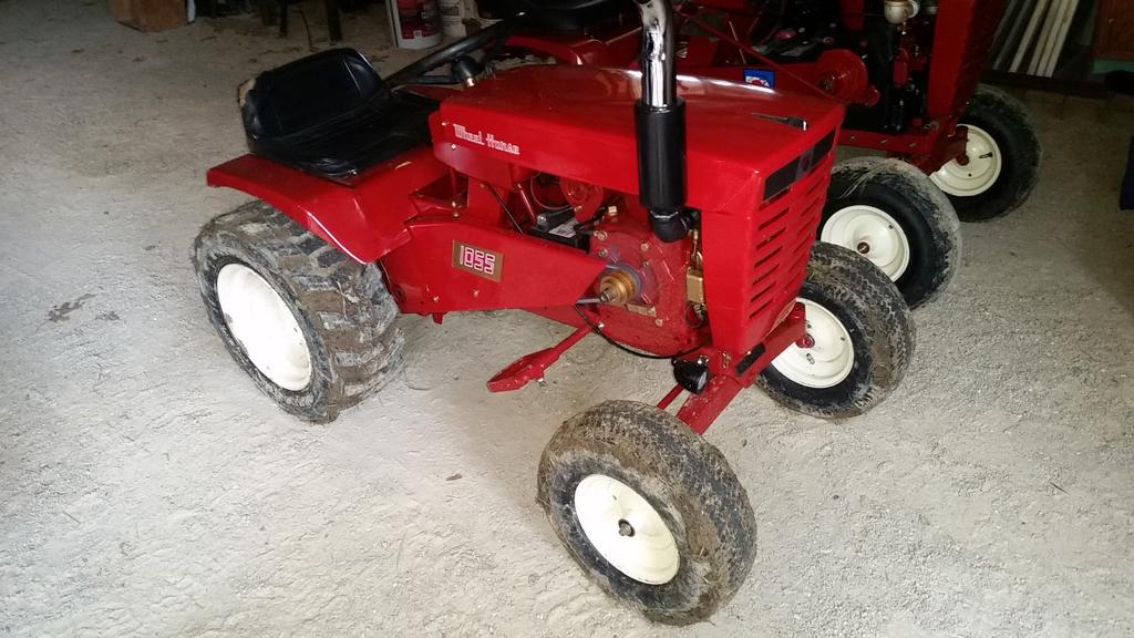

prondzy 3,890 #26 Posted May 17, 2019 Jim, i Like it a lot! 1 Share this post Link to post Share on other sites
PA.BOB 68 #27 Posted May 17, 2019 Beautiful work that you did. 1 Share this post Link to post Share on other sites
WHX?? 58,307 #28 Posted May 17, 2019 Thanks for all the compliments fellas. Can't wait to hook up a plow on her and stick it in a furrow. Prondzy says ther is no better way to seat some rings than put a load on her. Will be doing some fine tuning on her over the summer some V61's would really set her off as well as a decent seat. She is going to get loaded in the trailer and will be at AJ's on Saturday. 1 2 Share this post Link to post Share on other sites
Achto 32,845 #29 Posted May 17, 2019 It turned out great Jim!! The red & gold give off an old Trans Am vibe to me. Truly looking forward to checking it out tomorrow. Share this post Link to post Share on other sites
WHX?? 58,307 #31 Posted May 17, 2019 8 minutes ago, Achto said: The red & gold give off an old Trans Am vibe to me. To quote the Boss ... "all gonna meet down at the Cadillac Ranch!" 1 Share this post Link to post Share on other sites
Shynon 7,723 #32 Posted May 17, 2019 Looking good Jim I like the gold with the red. Now I see where you Beer and Cheese Ball money went. 1 3 Share this post Link to post Share on other sites
Tractorhead 9,217 #33 Posted May 17, 2019 Pretty awesome what you build.👍 the more if i seen the Pics what you got at start, i know, that’s a lot of work, but it‘s worth each minute and each cent you spent for. Impressive result ..👍 1 Share this post Link to post Share on other sites
953 nut 69,855 #34 Posted May 17, 2019 Great job. You can be proud of the outcome The seat looks great, Bob's seat covers for the factory seat are outstanding but I don't see anything wrong with yours. 1 Share this post Link to post Share on other sites
608KEB 854 #35 Posted May 21, 2019 On 5/16/2019 at 2:09 PM, WHX22 said: Where’d you put the video? You did take a few, didn’t you? Hold your horses said the old bull to the young'n ... lets not run down to get them cows we'll walk! That's the "G" rated version of that story. 1 Share this post Link to post Share on other sites
WHX?? 58,307 #36 Posted May 21, 2019 Family site here 608... I suppose I could go put the adult version in the funnies section. .... Did manage to stick in in the dirt and must admit it looks just fine in working clothes. Pulled a eight inch plow no problem but a twelve in hard pack gonna need weights and fluid. I don't think I'll spring for the expense since I have dedicated plow rigs. When we get any kind of decent weather I'm gonna drop a ten on it and turn some dirt but I suspect it will do do OK in my sandy loam soil. Just want to work the motor somemore to get to the break in oil change. I am real happy about the way this thing runs. Tranny seems a little noisy tho you notice that Dan? When I built the motor it did not have an ACR cam so the starter struggles abit if caught on compression stroke. Once it rolls pops on the first Rev with little choke. It has a cam that I have never seen with a spark retard on the side opposite where the ACR should be. 3 1 2 Share this post Link to post Share on other sites

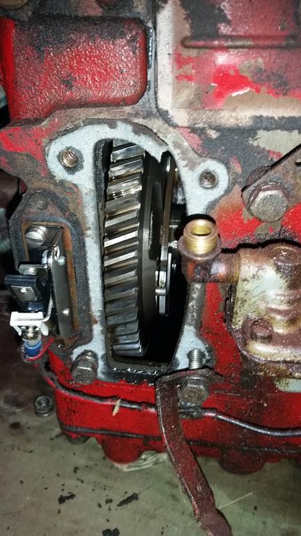

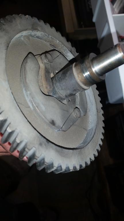

WHX?? 58,307 #37 Posted May 21, 2019 (edited) Here is the same 241 off the other 1055, note the ACR clearly visible. Second pic has the cam I used with with the funky points cam, same type of fly weights and hair springs but on the opposite side of the cam This whole topic might be better off in engines section. I can't give the spec no. off the motor I built ... it's a who knows where that engine plate went. If any one can skool me on this be appreciated. Edited May 21, 2019 by WHX22 3 Share this post Link to post Share on other sites

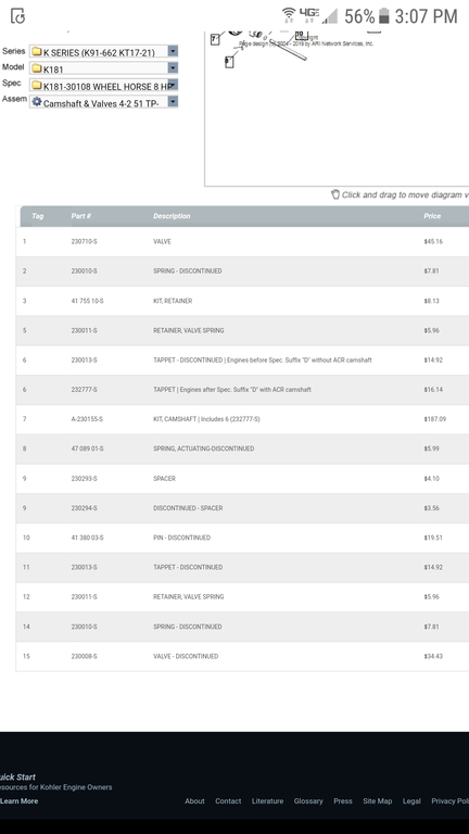

Wheelhorse427 15 #38 Posted May 21, 2019 I have a K181 off an 855 than I am currently rebuilding. It also had the spark advance cam, but I am putting an ACR cam in it for the rebuild. I think this engine is original to the tractor (spec number suffix "A" = 1965). I am not sure if this is true for all models, but at least K181 engines after spec number suffix "D" had an ACR cam. In the Kohler manual it says that spec suffix "D" was 1968. I came across this while searching for parts on the Kohler website: 2 Share this post Link to post Share on other sites

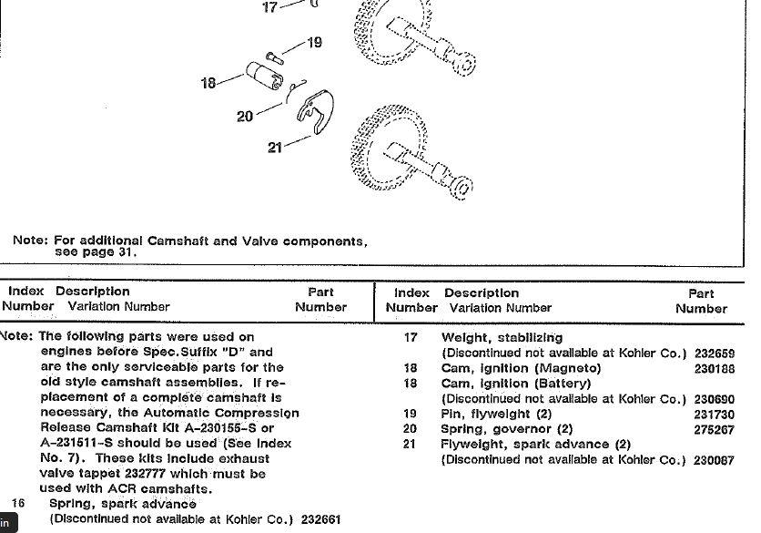

WHX?? 58,307 #43 Posted May 22, 2019 (edited) Hers a parts manual for a 181...check out page 31 & 32 Kohler K181 8hp IPL TP-2045-B.pdf It appears you are correct @oldredrider in that they were phasing out the spark cam in '64/'65 Edited May 22, 2019 by WHX22 1 Share this post Link to post Share on other sites
Racinbob 13,213 #44 Posted May 22, 2019 (edited) The very first paragraph in the Kohler service manual (section 9) states that ALL K-Series single cylinder, except for the K-91, have ACR. Apparently this ain't not so? Edited May 22, 2019 by Racinbob 1 Share this post Link to post Share on other sites
WHX?? 58,307 #45 Posted May 22, 2019 (edited) This would be true Bob for all engines after '65. If you have a motor before suffix D you are going to have the spark cam, if nobody's changed it. The parts manual for a 241 & 161 pretty much say the same thing as above. Interesting to note the tappet must be changed as well for an ACR cam. Looks like that tappet came with a replacement ACR cam. Also the spark cam is different from battery and mag ignitions. Apparently I have motors from the same year but in the transition period. OR someone changed out (upgraded) the cam to ACR in one of the motors which is entirely plausible. Still doesn't answer the question of a 701 double belt and a 702 not? Who's had a 161 from a 702 apart, does it have an ACR? If I had an extra cam cover gasket I'd find out easily enough. Edited May 22, 2019 by WHX22 2 Share this post Link to post Share on other sites
