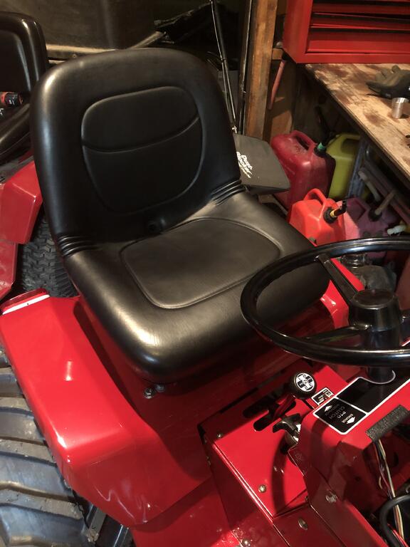

WheelhorseBob 1,550 #127 Posted October 16, 2021 On another happy note I bought a seat tonight. It would have been nice to find an original but I have one on my 300 hr. 520H. Truth is I cringe every time I sit on it. I’ve put more marine rubber uv protectant on it than is really necessary. Nope I don’t want to even think about cracking a seat on this. This is a working girl🤔😂! Tractor Supply and I love it! 1 1 Share this post Link to post Share on other sites

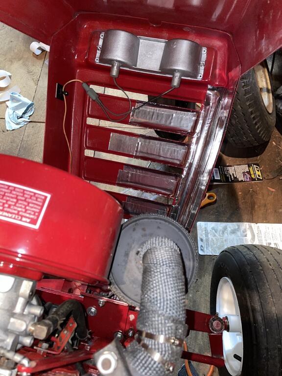

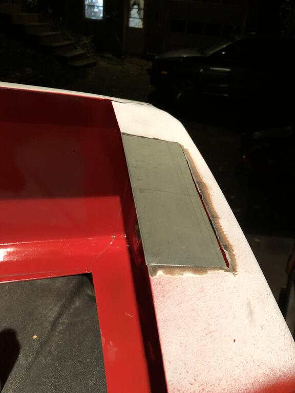

WheelhorseBob 1,550 #128 Posted November 6, 2021 My restoration has been bogged down but tonight I said $&@:; it and I cut out all the bad metal in my exhaust damaged hood. Tomorrow or Sunday it will get welded. Wish me luck!!!! 5 Share this post Link to post Share on other sites

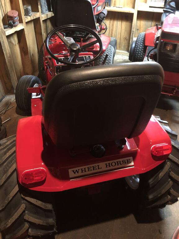

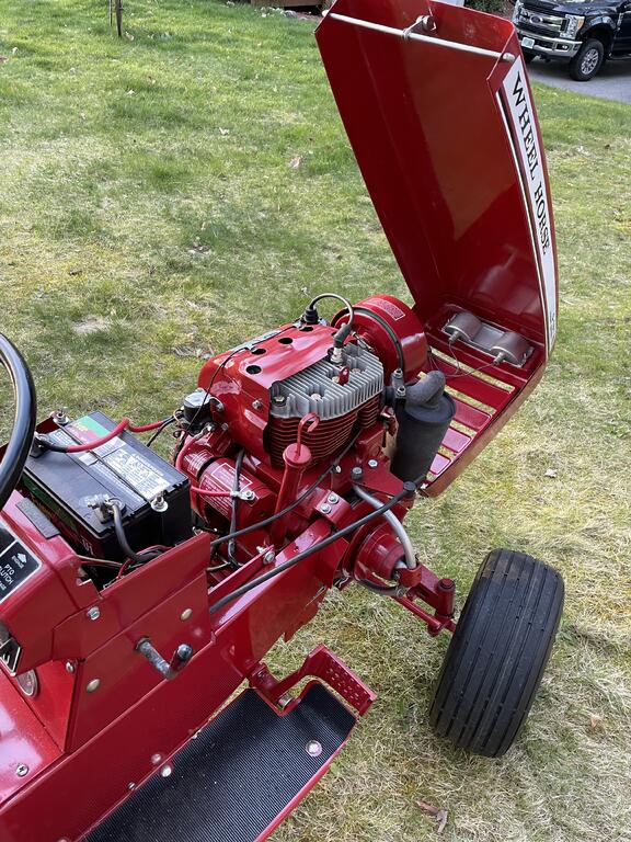

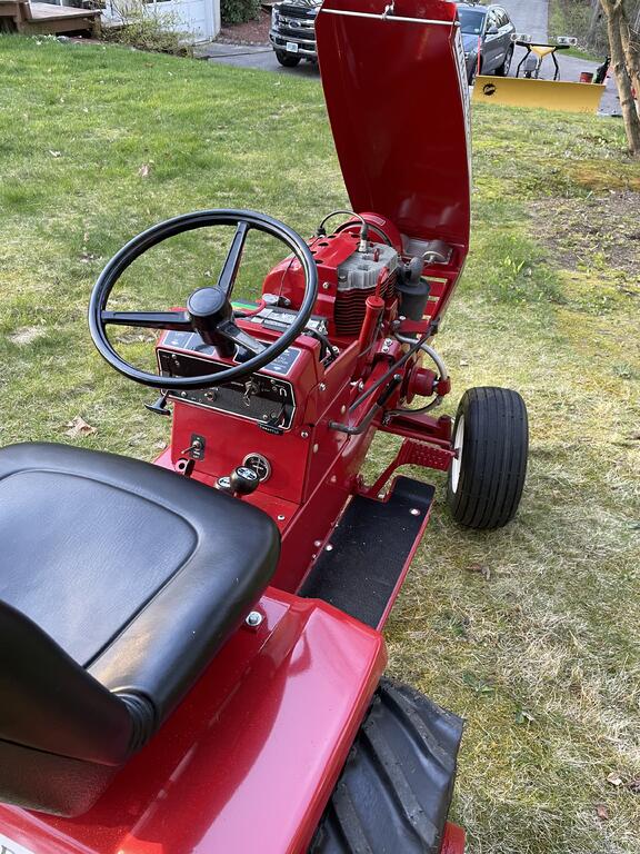

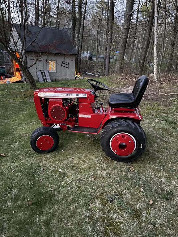

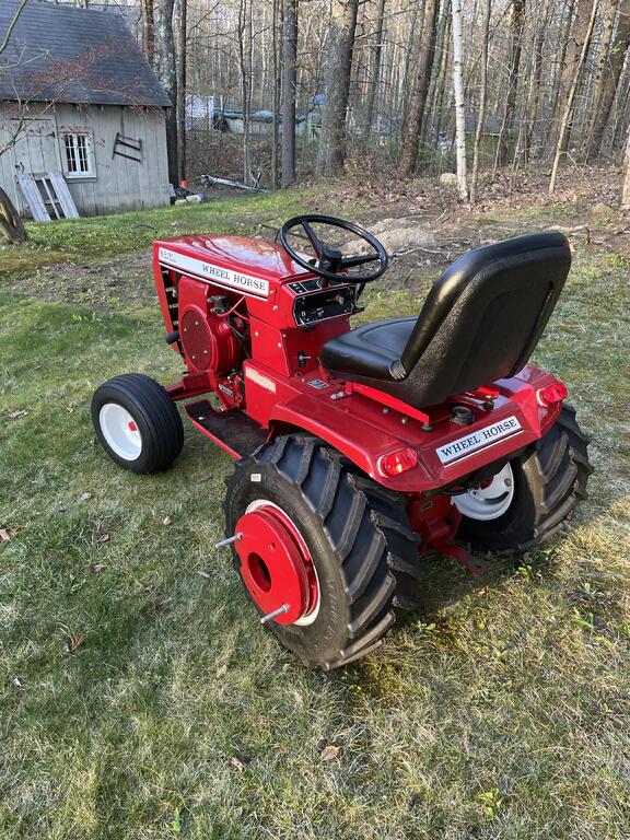

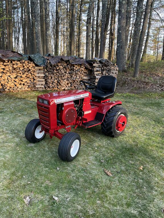

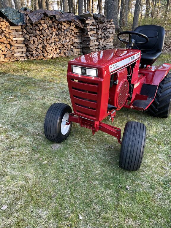

WheelhorseBob 1,550 #129 Posted May 8, 2022 Hi guys, been a while! I’m getting close to done on this build and thought you’d all like a progress update. Hood is repaired and done. How well it holds up is another question but I added header wrap to the inside panel. Also installed a lot of weights to the rear. Bolens inner and sears outer I believe. Still need to cut the carriage bolts to length and mount the front weights, and then she is done😁 10 3 Share this post Link to post Share on other sites
Thor27 892 #130 Posted May 8, 2022 That came out beautiful! 2 Share this post Link to post Share on other sites
ebinmaine 80,388 #131 Posted May 9, 2022 That Sir, is a beautiful machine! @c-series don check it out!! Bob what are you using for front weight (s)? 1 Share this post Link to post Share on other sites

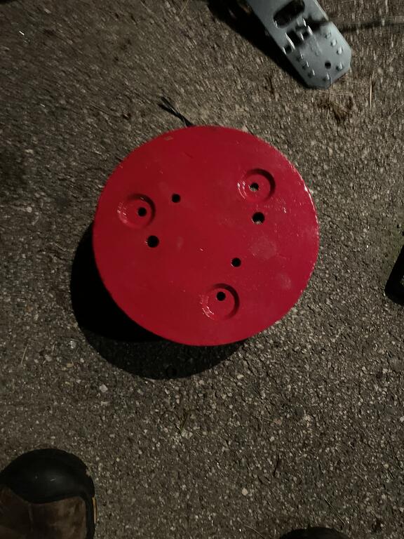

WheelhorseBob 1,550 #133 Posted May 9, 2022 51 minutes ago, ebinmaine said: That Sir, is a beautiful machine! @c-series don check it out!! Bob what are you using for front weight (s)? These, not sure what they are from? Simplicity? 3 Share this post Link to post Share on other sites
c-series don 12,371 #134 Posted May 9, 2022 @WheelhorseBob @ebinmaineAbsolutely beautiful Bob! I love the fact that you added an electric lift! I still want to do that to my C-161 8 speed. Are you going to bring it to the big show? 2 Share this post Link to post Share on other sites

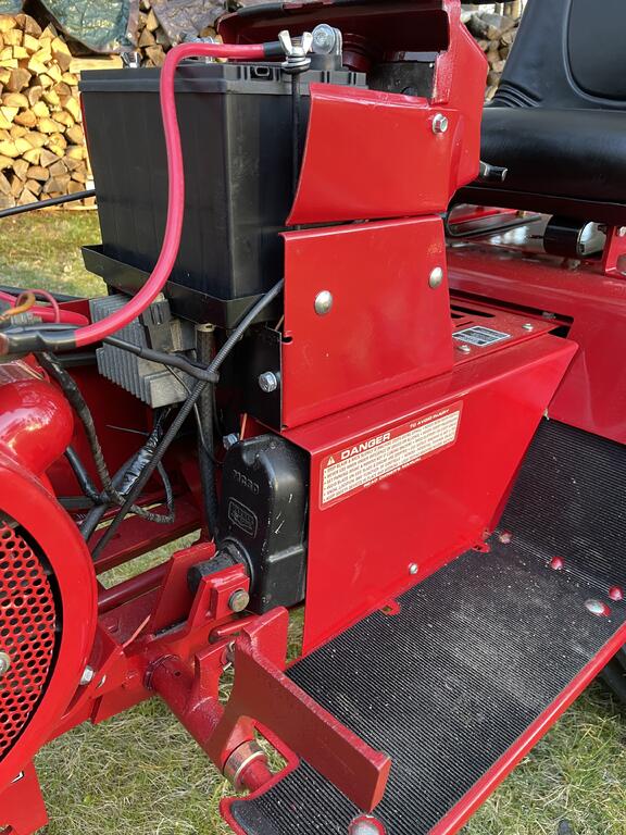

peter lena 10,020 #135 Posted May 9, 2022 @WheelhorseBob top down picture of the start point on that lever rod, added washers and lube , firms up and makes it work with solid ease . also note steering column flange bearing . also a great ground bolt extension point , for chassis grounding , pete 1 Share this post Link to post Share on other sites

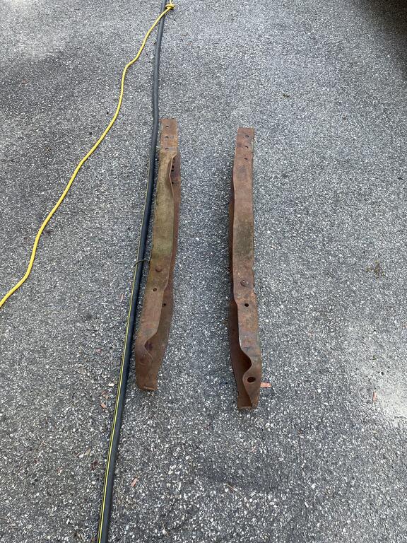

WheelhorseBob 1,550 #138 Posted May 9, 2022 (edited) 9 hours ago, ebinmaine said: Which reminds me ..... where are the pictures of that truck in progress??? 😀 You want parts pics…..here you go, I had to cut the frame horns off because someone in the last 58 years butchered the bumper mounts. This has been an expensive experience…..these are the new ones from Washington state. Edited May 9, 2022 by WheelhorseBob 1 1 Share this post Link to post Share on other sites
ebinmaine 80,388 #139 Posted May 9, 2022 Just now, WheelhorseBob said: You want parts pics…..here you go, I had to cut the frame horns off because someone in the last 58 years butchered the bumper mounts. This has been an expensive experience….. Yeah. Pretty typical. Keep at it and then drive to my house for coffee. 2 Share this post Link to post Share on other sites

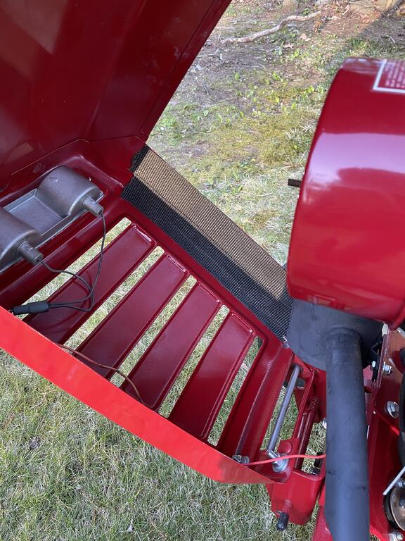

JoeM 10,166 #140 Posted May 10, 2022 Header Wrap Pros and Cons the strips vs. wrapping the muffler? 2 Share this post Link to post Share on other sites
WheelhorseBob 1,550 #141 Posted May 10, 2022 13 hours ago, JoeM said: Header Wrap Pros and Cons the strips vs. wrapping the muffler? Not sure other than I thought wrapping the muffler might cause it to rust out faster but that may be a false assumption. I may still wrap it. 3 Share this post Link to post Share on other sites

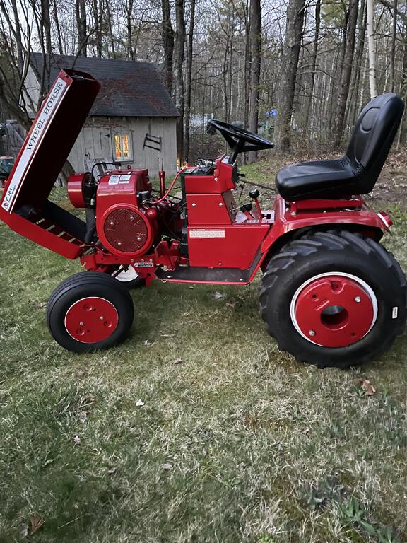

WheelhorseBob 1,550 #142 Posted May 11, 2022 Finished. Got the front weights mounted and rear carriage bolts trimmed. She is a thing of beauty to my eye. Not horse wheel weights but they look super nice. And those rears stacked are at least 100lbs. Per side. I’m real happy with it! 7 4 Share this post Link to post Share on other sites

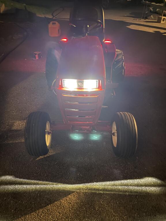

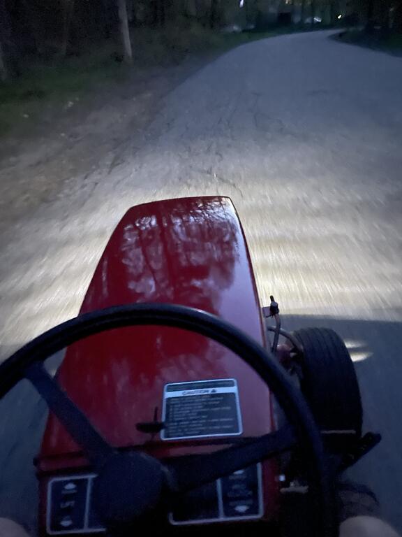

WheelhorseBob 1,550 #148 Posted May 14, 2022 Night ride tonight. Like the led’s 4 Share this post Link to post Share on other sites
kpinnc 18,888 #149 Posted May 20, 2022 On 5/13/2022 at 9:03 PM, WheelhorseBob said: Night ride tonight. Like the led’s Headlights that actually work. What a concept! Great job! OEM incandescent bulbs are about as bright as a candle. I never understood why they even used them! Beautiful tractor! 1 Share this post Link to post Share on other sites

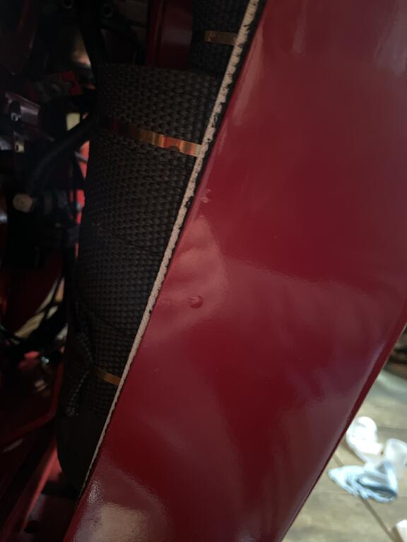

WheelhorseBob 1,550 #150 Posted May 21, 2022 I’m thinking that it maybe impossible to protect the hoods on the 101, 121, 141 and 161 steel hood tractors. Test tonight, I let it run at ma. Rpm for 10 min. This is with the exhaust wrapped, header wrap on the inside of the hood and 2000degree heat tape over it all. Still got three bubbles in my paint……I’m done, gonna use it and if it burns off oh well! 1 Share this post Link to post Share on other sites
