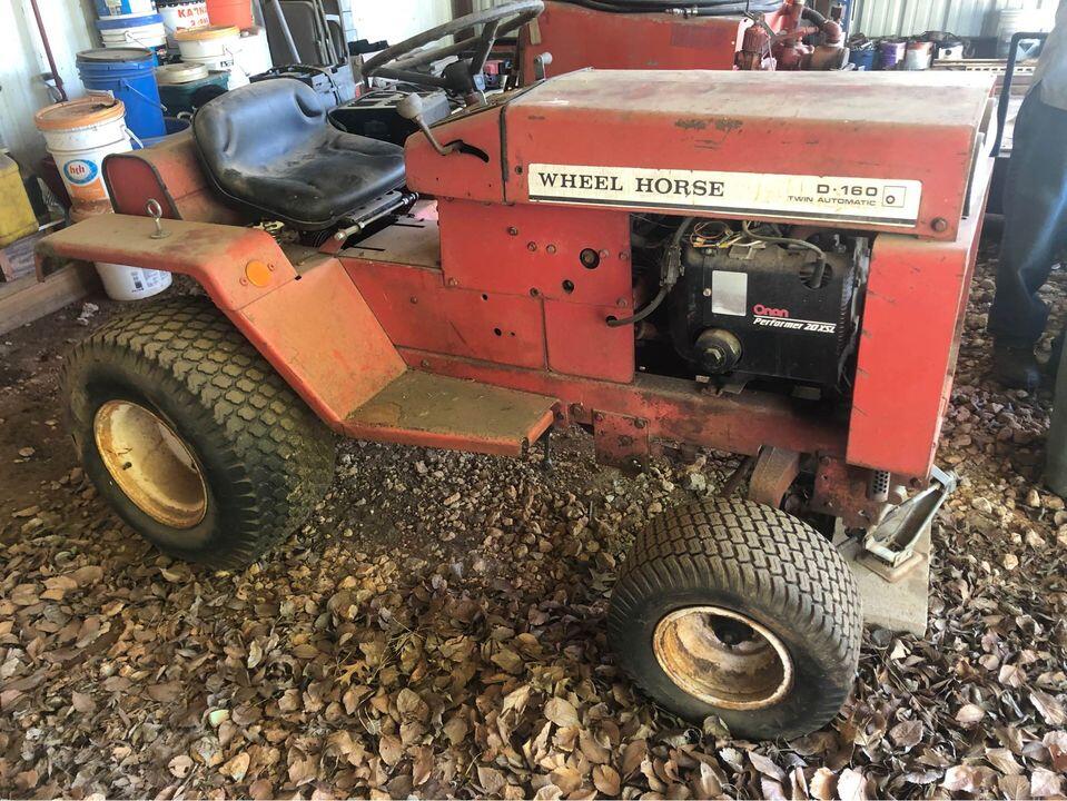

ZXT 2,402 #1 Posted May 8, 2021 Today after work I went and picked up the D160 I found on FB marketplace. Looked like a good tractor, so I offered to buy it and wound up paying for it before going to pick it up because there was a lot of interest. I get there this afternoon, the owner airs the tires up, we push it onto the trailer, load the original B43M on the trailer, and i head down the road. Said it wasn't running great when it was parked a year or two ago. Got it home, hooked up an aux fuel tank as the original tank is rusty. Fires right up, but is obviously missing. Pull the plug on the passenger side (Not sure if right/left is determined by looking at the front of the tractor or sitting in the seat) and found the gap closed. No problem, I open it some, put it back in and it still misses. I look down in the bore, turn the engine by hand and I never see a piston. Great.. Looks like I'll be tearing into a P220G soon. Guess I'll start reading up on them, and check to see if the B43M is a good or not. I promised the 16hp to my father who needs an engine on his Toro Grounds Master, so we'll see how it works out. I suppose I could always swap the N52M off of my Sears onto it, but I think i hear some bottom end noise in it. Pictures to come later this weekend. Any of you guys have any pointers? Thanks! 2 Share this post Link to post Share on other sites

Pollack Pete 2,273 #8 Posted May 8, 2021 (edited) Looks like a newer engine in it? Supposed to be red like the rest of the tractor.If those are the tins that came on that engine,it's a 20 horsepower,not the original16.Maybe rebuildable?Maybe just needs a connecting rod?I think you did great on the price.I have a D-160 here in pieces that I wouldn't let go for that price.Your D-160 looks like it certainly has a lot of potential.Have fun with your new toy.I like it. Edited May 8, 2021 by Pollack Pete 1 Share this post Link to post Share on other sites

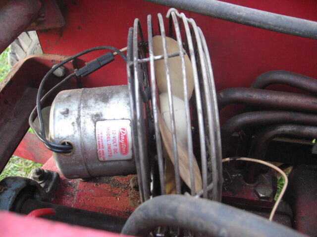

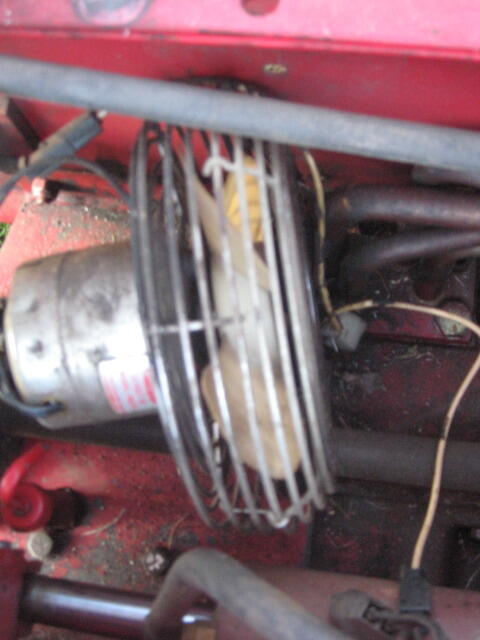

pfrederi 20,891 #9 Posted May 8, 2021 (edited) Fan was factory in later years. Onan Kohler same coupler but a different sequence of washer nuts and bolts. Look at TSB #217 Filter 51410 Edited May 8, 2021 by pfrederi 1 1 Share this post Link to post Share on other sites
ZXT 2,402 #10 Posted May 8, 2021 1 hour ago, Pollack Pete said: Looks like a newer engine in it? Supposed to be red like the rest of the tractor.If those are the tins that came on that engine,it's a 20 horsepower,not the original16.Maybe rebuildable?Maybe just needs a connecting rod?I think you did great on the price.I have a D-160 here in pieces that I wouldn't let go for that price.Your D-160 looks like it certainly has a lot of potential.Have fun with your new toy.I like it. Yes, it has a P220G on it. It came with the original B43M as well. I'll have to tear into it to see how bad the damage is. 14 minutes ago, pfrederi said: Fan was factory in later years. Onan Kohler same coupler but a different sequence of washer nuts and bolts. Look at TSB #217 Filter 51410 Good to know! Thanks! Share this post Link to post Share on other sites
