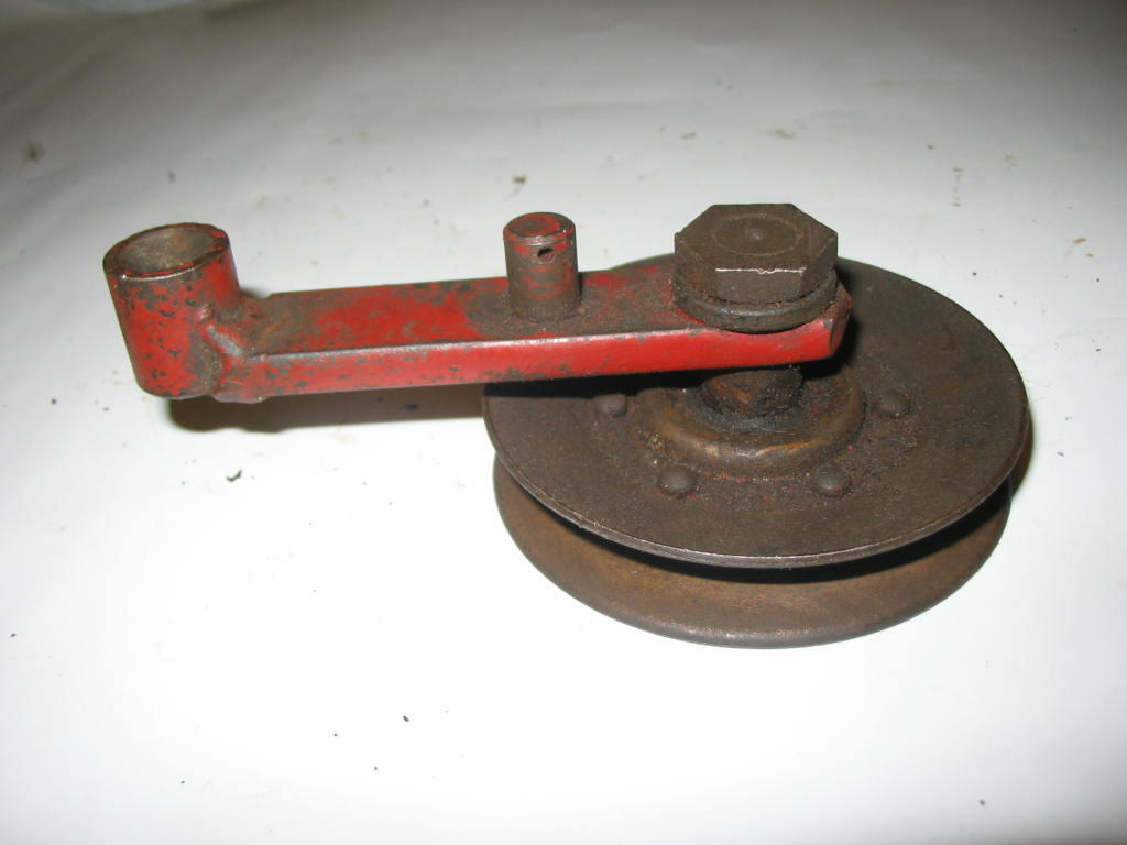

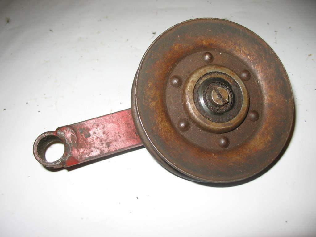

ebinmaine 80,295 #1 Posted April 30, 2021 (edited) @OldWorkHorse Steve and I both need a clutch idler pulley on early tractors. The one from Trina's 856 military tribute tractor measures 3" od. How do we get these new? Is there a Sten's or other aftermarket number? Edited April 30, 2021 by ebinmaine 2 Share this post Link to post Share on other sites

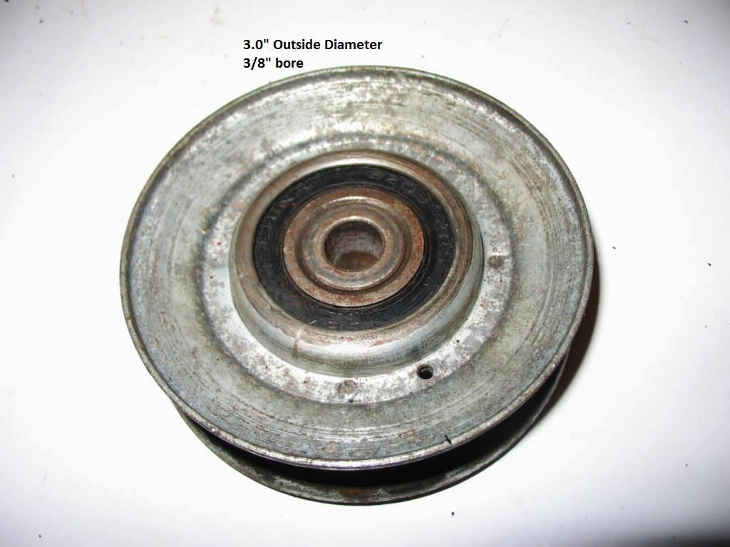

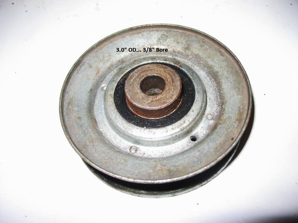

daveoman1966 3,884 #18 Posted April 30, 2021 (edited) I have an ebay listing with the 1623 pulley. I have TWO of these...$21.95 each + 5 ship. Ebay item : 133412177681 Edited April 30, 2021 by daveoman1966 3 2 Share this post Link to post Share on other sites

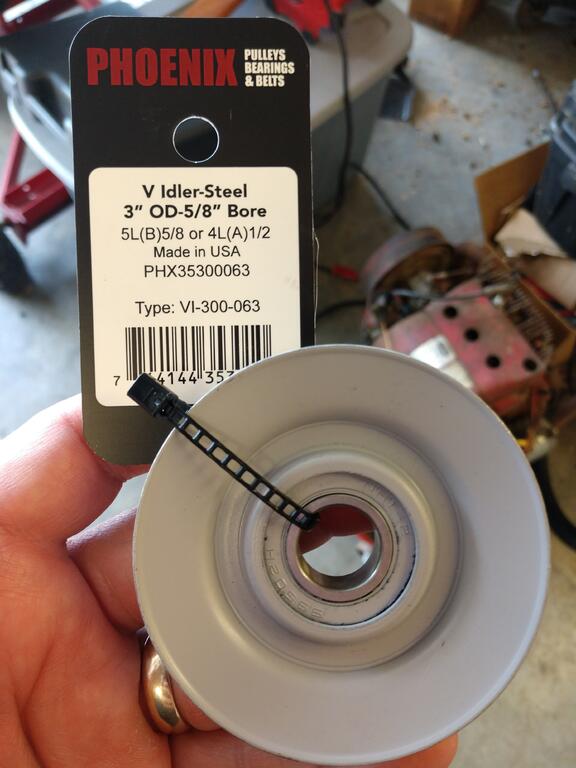

kpinnc 18,886 #19 Posted May 2, 2021 (edited) I got one today at TSC for $19. 3 inch diameter with a 3/8 bearing. It will need a spacer on the mounting bolt, but that is easy enough. Edited May 2, 2021 by kpinnc 1 Share this post Link to post Share on other sites
ebinmaine 80,295 #20 Posted May 2, 2021 6 hours ago, kpinnc said: I got one today at TSC for $19. 3 inch diameter with a 3/8 bearing. It will need a spacer on the mounting bolt, but that is easy enough. Could you post pics please? 1 Share this post Link to post Share on other sites
kpinnc 18,886 #21 Posted May 3, 2021 (edited) 13 hours ago, ebinmaine said: Could you post pics please? I typoed that, it is 5/8 bore. I think the spacers are 3/4 but they have that size at TSC too. Edited May 3, 2021 by kpinnc 1 Share this post Link to post Share on other sites
