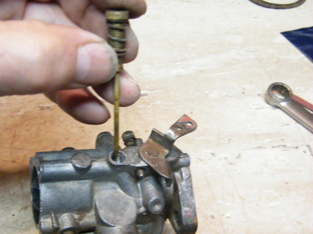

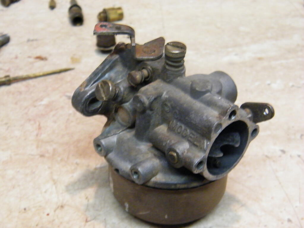

stevasaurus 23,884 #10 Posted April 26, 2021 A picture of the carb would help. There should be an adjustment fuel mixture screw on top of carb. Turn it in counting the turns until it bottoms out...may 1 1/2 to 2 1/2 turns. Take screw out, don't lose the spring, and look and poke the little holes in the shaft. A paper clip may be too big for the holes, I ended up pulling a wire out of one of my wire brushes. Spray carb clean down the screw hole and the adjustment screw. Put screw back in and bottom out, then back out to where the screw was. 1 Share this post Link to post Share on other sites
stevasaurus 23,884 #11 Posted April 26, 2021 This is a Carter "N" carb. In the 1st picture, I am holding the fuel screw and you can see one of the holes I am talking about. 2nd picture shows it in place. Share this post Link to post Share on other sites

Jeff-C175 7,211 #14 Posted April 26, 2021 5 minutes ago, stevasaurus said: Carter "N" carb Worked on a multitude of those over the years... know exactly what you mean. But this is a cheapie Chinee 1 Share this post Link to post Share on other sites
