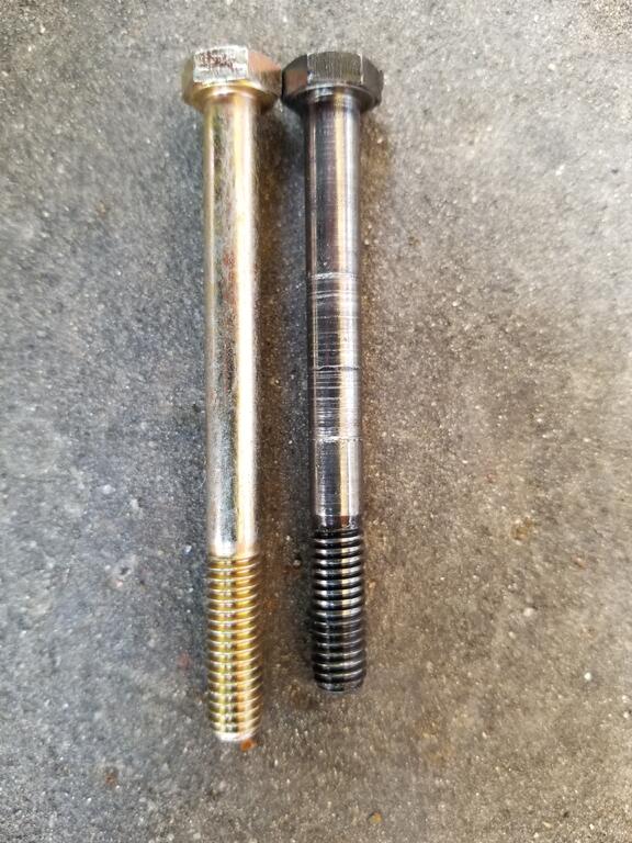

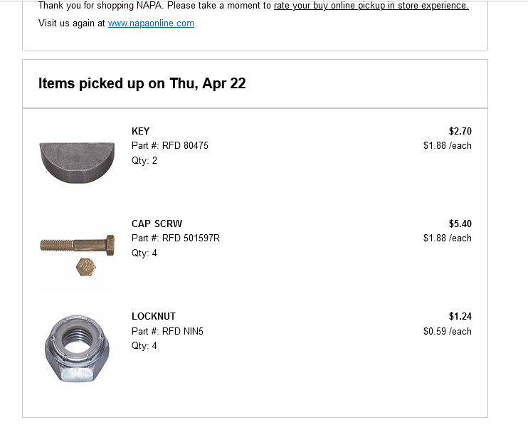

cafoose 3,862 #130 Posted April 22, 2021 (edited) @stevasaurus@pfrederi I got the parts from NAPA. The bolts I got are grade 8 3.5 inches long. They are a little longer than the original bolts. Does that matter? Also the new axle keys wiggle about 1/64" to 1/32" in the shaft. Does that matter? Edited April 22, 2021 by cafoose Share this post Link to post Share on other sites
Gregor 4,848 #131 Posted April 22, 2021 24 minutes ago, cafoose said: Also the new axle keys wiggle about 1/64" to 1/32" in the shaft I have tigtened up woodruff keys in the past, with coil stock. Share this post Link to post Share on other sites
pfrederi 21,184 #132 Posted April 22, 2021 When in doubt I tend to follow the manual. it calls for 5/16 3-1/4" bolts.... (The other version of the older Wheelamatic with a bevel gear differential did use 3-1/2" Share this post Link to post Share on other sites
stevasaurus 23,857 #133 Posted April 22, 2021 Do not use longer bolts then what you pulled out. I know Paul likes to change out his bolts, but it is really not necessary. New nuts are a must. It seems like Wheel Horse never used the length of bolts that you can readily buy. If you have to use them, put a regular nut on them and then saw to the same length as the ones you pulled out. Back that nut off to fix the thread. 3 1 Share this post Link to post Share on other sites
squonk 48,163 #134 Posted April 22, 2021 You try some Loctite bearing and sleeve retainer on the axle keys 1 1 Share this post Link to post Share on other sites
cafoose 3,862 #135 Posted April 22, 2021 7 minutes ago, Gregor said: I have tigtened up woodruff keys in the past, with coil stock. Like this? Share this post Link to post Share on other sites
squonk 48,163 #136 Posted April 22, 2021 WOW! I edited my post to add a word and it posted another one! DOO DO DOO DO! 1 1 Share this post Link to post Share on other sites
Gregor 4,848 #137 Posted April 22, 2021 (edited) 15 minutes ago, cafoose said: Like this? Yep. Unless you want to have the axles re-cut. It's only money. I have also used tin cans. They are steel. Edited April 22, 2021 by Gregor 1 Share this post Link to post Share on other sites
