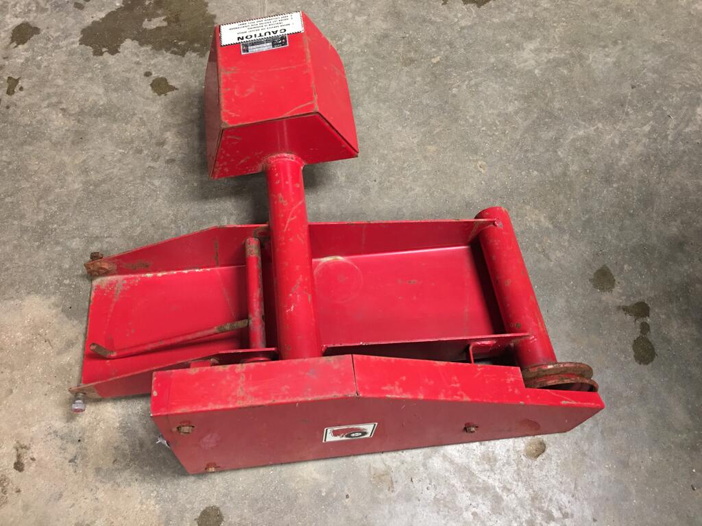

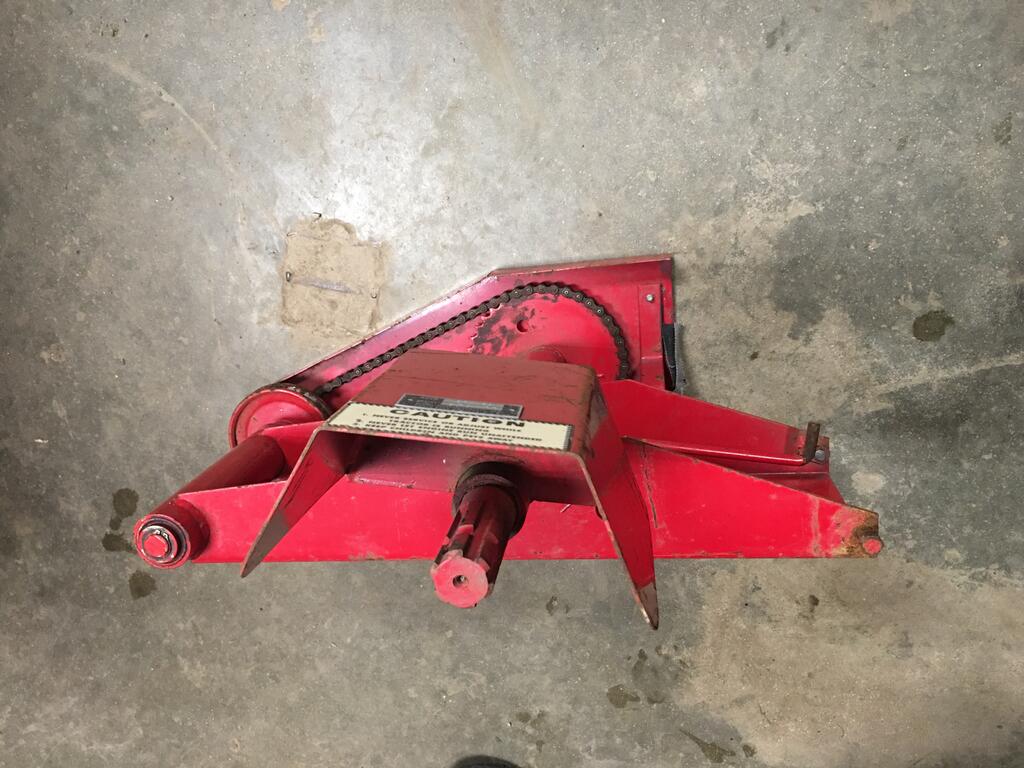

steelman 255 #1 Posted April 9, 2021 Saw this today with a WH and didn’t know for sure what it is or would be used for? It’s red so I figured it came from Wheelhorse. Looks like it would hook up to the front attach-a-matic. 2 Share this post Link to post Share on other sites

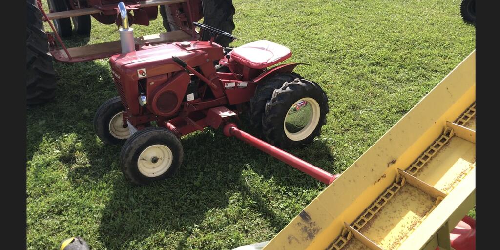

gwest_ca-(File Mod) 12,483 #2 Posted April 9, 2021 One of these maybe? Garry 2 Share this post Link to post Share on other sites
The Tuul Crib 7,354 #3 Posted April 9, 2021 (edited) It looks like some kind of power take off. @WHX24 ill bet has one of these Edited April 9, 2021 by The Tuul Crib Share this post Link to post Share on other sites
8ntruck 9,289 #4 Posted April 9, 2021 That looks like an adaptor to provide the standard farm tractor pto drive (530 rpm?) to drive things like grain elevators, hay conveyors, or generators. 2 Share this post Link to post Share on other sites
steelman 255 #5 Posted April 9, 2021 That's kind of what I thought....I saw it at an auction with lots of farm machinery. I was told that it went with an 87 Wheel Horse. Trying to figure out if it was worth picking up. 1 Share this post Link to post Share on other sites
oliver2-44 11,734 #6 Posted April 9, 2021 @steelman That PTO attachment is not real common and definitely worth picking. 3 Share this post Link to post Share on other sites
The Tuul Crib 7,354 #7 Posted April 9, 2021 Buy it!! 2 Share this post Link to post Share on other sites

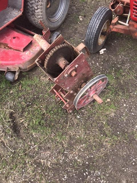

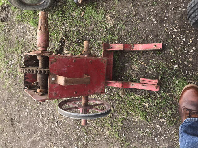

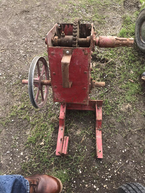

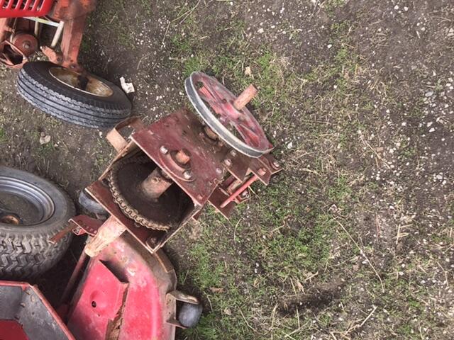

WHX?? 58,070 #8 Posted April 9, 2021 (edited) 17 minutes ago, oliver2-44 said: @steelman That PTO attachment is not real common and definitely worth picking. I'll second that Ollie... nope but wished I had one ... Only guy I know that has one is @wheelhorseman but what ain't he got!!! @c-series don check it out Don... Looks like it's got both brackets for attaching?? Sorry steelman neck gettin sore and I was drooling sideways.... Lowell's ... he's prolly got better pics I just stole this one off his site... Edited April 9, 2021 by WHX24 2 Share this post Link to post Share on other sites

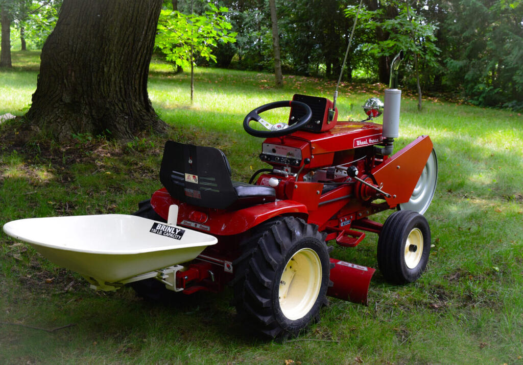

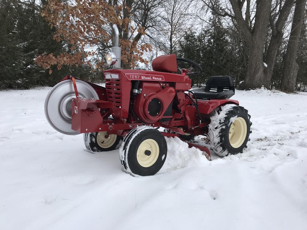

wheelhorseman 3,256 #9 Posted April 9, 2021 (edited) 15 minutes ago, WHX24 said: I'll second that Ollie... nope but wished I had one ... Only guy I know that has one is @wheelhorseman but what ain't he got!!! One??? That is not a Wheel Horse PTO attachment they only made the two like whats in my pictures not sure what it is for however I would still buy it🤷♂️ Edited April 9, 2021 by wheelhorseman 6 Share this post Link to post Share on other sites
Lee1977 7,764 #10 Posted April 9, 2021 1 hour ago, steelman said: Saw this today with a WH and didn’t know for sure what it is or would be used for? It’s red so I figured it came from Wheelhorse. Looks like it would hook up to the front attach-a-matic. That one looks to be home made. Most likely to run a grain or hay elevator. 2 Share this post Link to post Share on other sites
