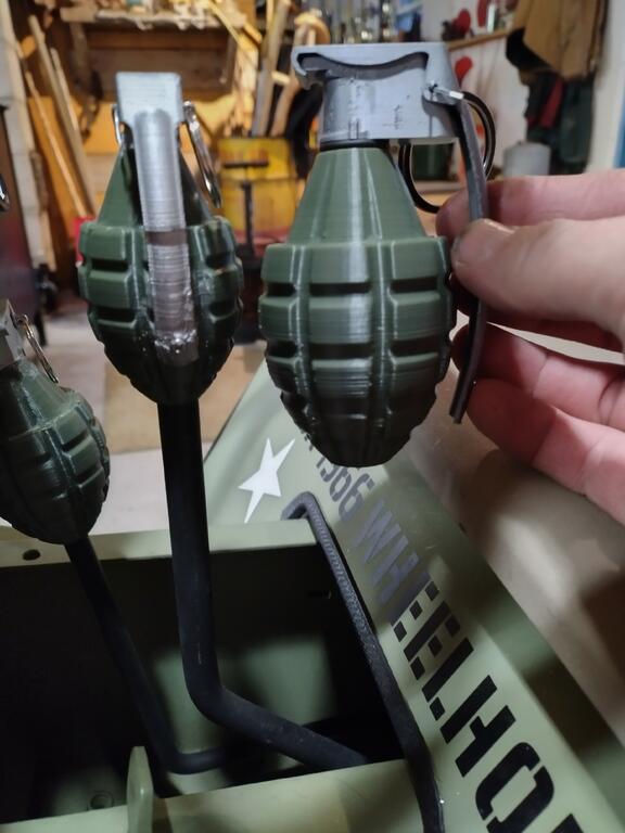

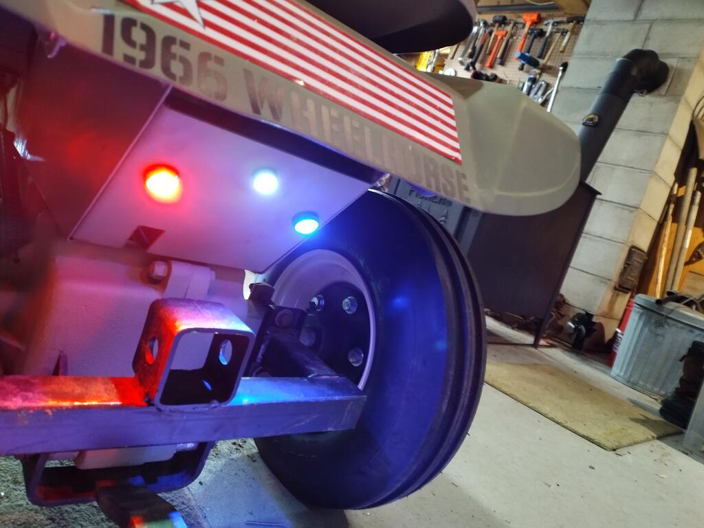

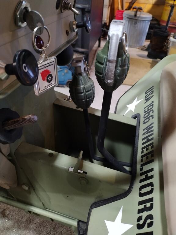

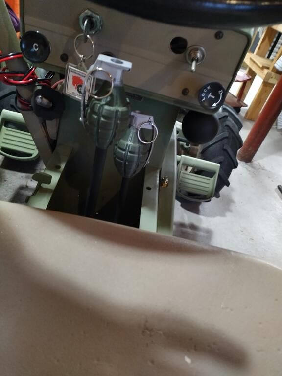

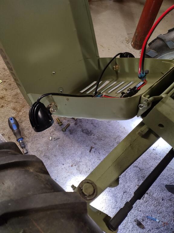

ebinmaine 80,974 #328 Posted May 4, 2023 Front and rear lights are working. Love these Red White n Blue!! The @Wheel Horse 3D Grey made grenade shifters are in place. Here's a full scale model for comparison. 2 8 Share this post Link to post Share on other sites
SylvanLakeWH 32,708 #329 Posted May 4, 2023 Based on the relative general jewelanatomical location of them grenades, I'd triple check they ain't live... 4 Share this post Link to post Share on other sites
ebinmaine 80,974 #330 Posted May 4, 2023 1 minute ago, SylvanLakeWH said: Based on the relative general jewelanatomical location of them grenades, I'd triple check they ain't live... The uhhhhh jewelanatomical location will NOT be an issue given consideration that the owner/driver is a ♀️ woman girl female. 3 Share this post Link to post Share on other sites
kpinnc 19,015 #331 Posted May 4, 2023 12 minutes ago, ebinmaine said: The uhhhhh jewelanatomical location will NOT be an issue given consideration that the owner/driver is a ♀️ woman girl female. She may disagree with you Eb... They don't talk about theirs as much as us big strong manly chicken turds do, but that don't mean they don't care! 6 Share this post Link to post Share on other sites
Wheel Horse 3D 3,827 #332 Posted May 4, 2023 (edited) 1 hour ago, ebinmaine said: The uhhhhh jewelanatomical location will NOT be an issue given consideration that the owner/driver is a ♀️ woman girl female. My personal pronouns are H.E.(might have to be an explosive geek to get that) Edited May 4, 2023 by Wheel Horse 3D 2 Share this post Link to post Share on other sites

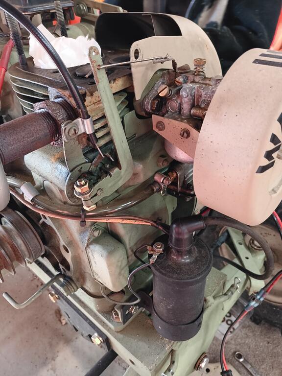

ebinmaine 80,974 #344 Posted January 21, 2024 We brought the Millie tractor in the basement workshop for some repairs and maintenance. Diagnosis on no-start or stall condition. Change ALL fuel line and filter. (The clear blue line was hardening too quickly for my satisfaction). Increase upper RPM limit. Determine cause of generator lamp dysfunction as per last post. 3 4 Share this post Link to post Share on other sites

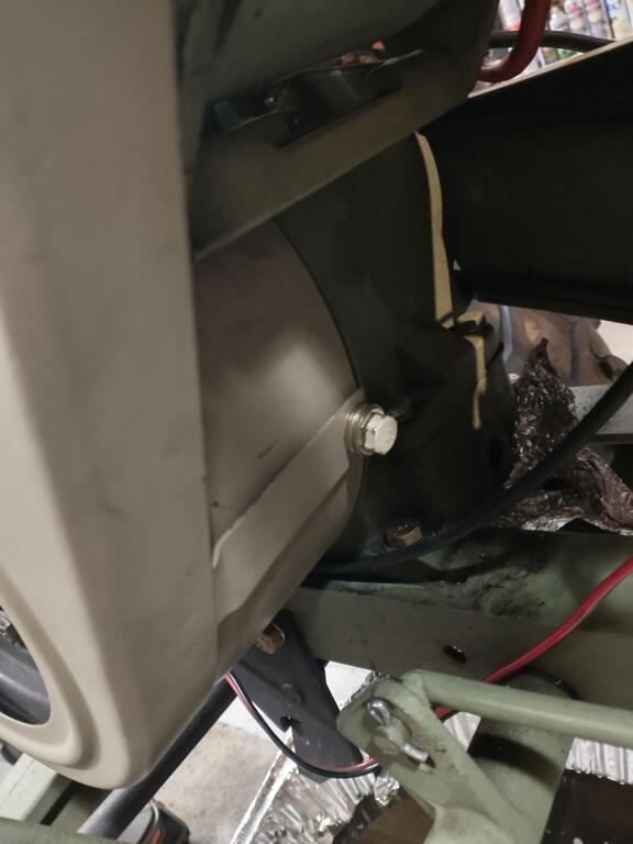

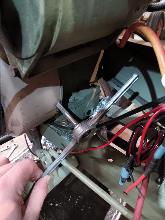

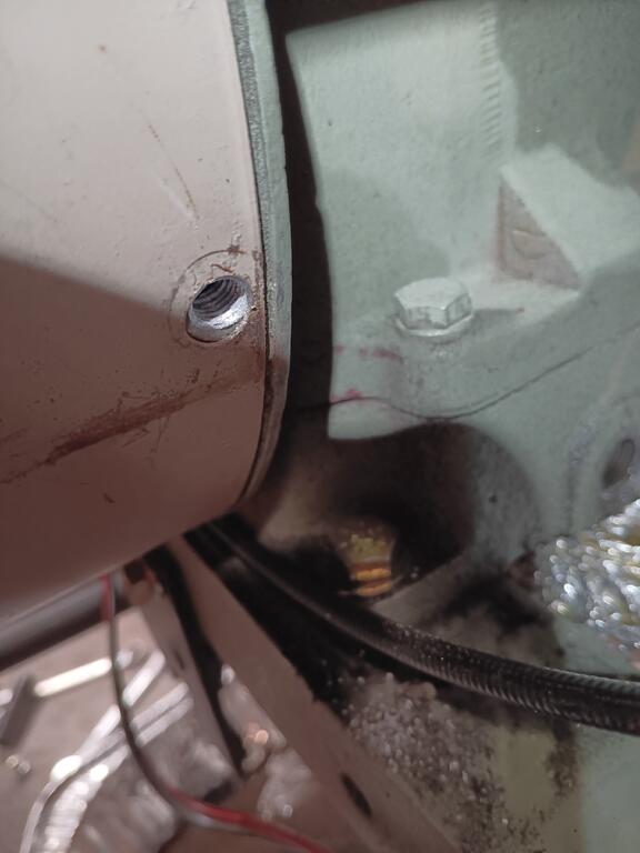

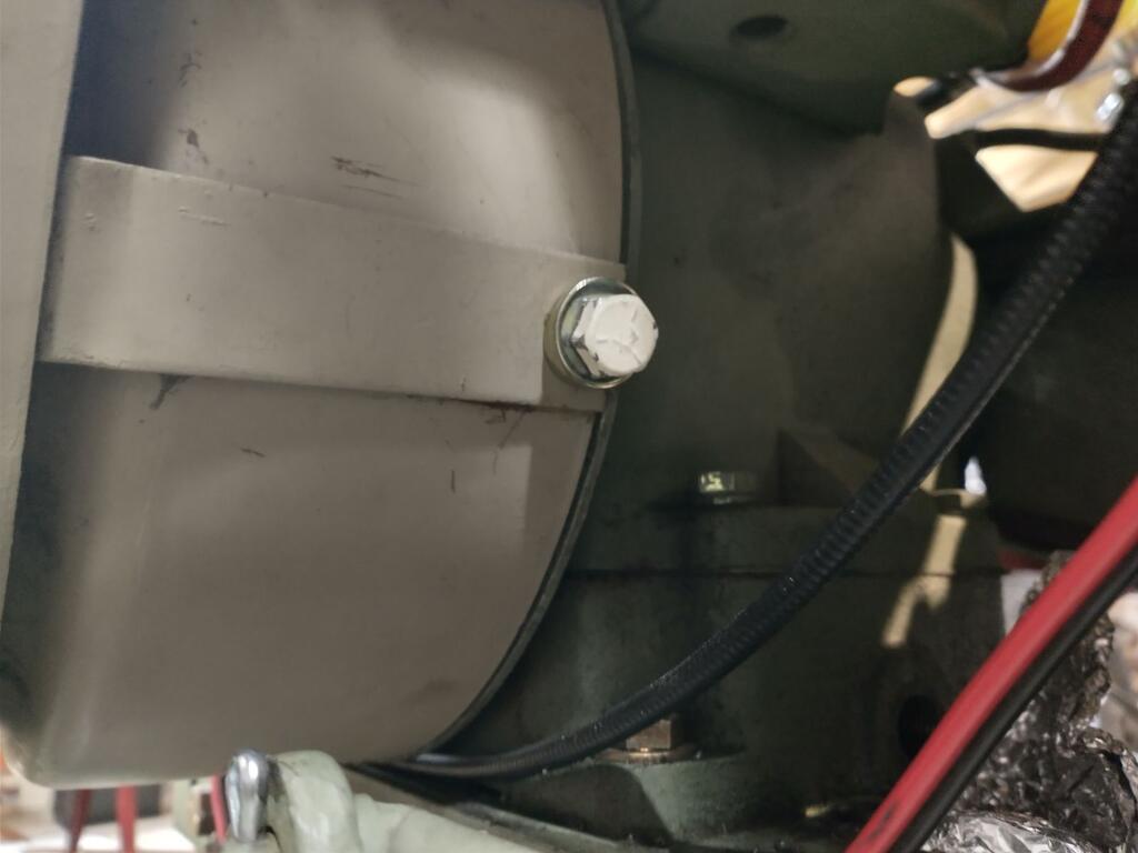

ebinmaine 80,974 #345 Posted January 22, 2024 Can anybody offer any tips or tricks for repairing stripped out bolt holes in the engine for where the sheet metal is supposed to be held on? Share this post Link to post Share on other sites
SylvanLakeWH 32,708 #346 Posted January 22, 2024 I had a mini bike that Dad cut thin tin strips and put in stripped holes to keep chain guard on... worked like a charm... poor man's tool and die... single use. Not a "repair" but quick and functional. No pics... photography had just been invented... 2 2 Share this post Link to post Share on other sites
Darrenw85 761 #347 Posted January 22, 2024 I have run the next size tap in several of mine to fix the same problem. 2 1 Share this post Link to post Share on other sites
Racinbob 13,213 #348 Posted January 22, 2024 1 hour ago, SylvanLakeWH said: I had a mini bike that Dad cut thin tin strips and put in stripped holes to keep chain guard on... worked like a charm... poor man's tool and die... single use. Not a "repair" but quick and functional. No pics... photography had just been invented... I've tapped a few out to 5/16". Fine thread seems to work best. 2 1 Share this post Link to post Share on other sites
wallfish 20,689 #349 Posted January 22, 2024 3 hours ago, SylvanLakeWH said: I had a mini bike that Dad cut thin tin strips and put in stripped holes to keep chain guard on... worked like a charm... poor man's tool and die... single use. Not a "repair" but quick and functional. No pics... photography had just been invented... Ha, Toothpicks work for that! Learned from my grandfather. ( But -- depending upon what it's holding ) 3 2 Share this post Link to post Share on other sites
ebinmaine 80,974 #350 Posted January 23, 2024 8 hours ago, Darrenw85 said: I have run the next size tap in several of mine to fix the same problem. 7 hours ago, Racinbob said: I've tapped a few out to 5/16". Fine thread seems to work best. Got this done tonight. 1 5 Share this post Link to post Share on other sites
