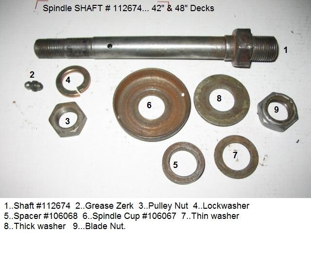

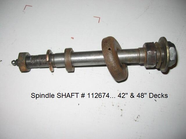

daveoman1966 3,884 #2 Posted April 2, 2021 (edited) I have to agree that the spindle assy 111726 will NOT use the keyed shaft. The shaft that is part of that assy is part # 112674 which does NOT have a keyway slot. The top of the shaft is 5/8 dia for the pulley to fit, but the shaft is 3/4' dia at the bearing. In other words, the shaft steps down from 3/4" dia to 5/8" dia...giving rise to a shoulder on the shaft for the pulley to 'pinch' against. Here is a pic of the 111726 spindle assy... This is the parts list for the 111726 spindle assy: You can get that sp[indle assy here for $115... https://www.psep1.biz/arinet.asp?aribrand=TO#/Toro_Consumer/78425%2c_42"_Recycler_Mower%2c_1994_(SN_490001-499999)/Spindle__Blade_Assembly/5ba2b047-9dca-452b-802c-8b39a40e9893/147a74b4-3d6d-4f87-855f-797d75a95feb Edited April 2, 2021 by daveoman1966 1 Share this post Link to post Share on other sites

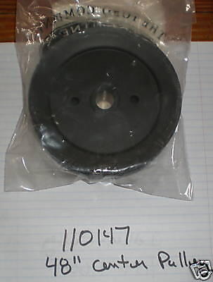

daveoman1966 3,884 #6 Posted April 2, 2021 Double center pulley 106073 uses a KEYWAY...it is 3/4" bore and for a 48" deck. Double center pullley110147 DOES NOT use the keyway and is for 5/8" bore (17mm) for 48" deck. (pic below) Share this post Link to post Share on other sites
Jeff-C175 7,211 #7 Posted April 2, 2021 (edited) @daveoman1966So you're telling me that I've ordered the wrong pulley then... that sucks. And, if I wanted to replace ALL THREE of the spindles with the 111726 I would need ALL THREE new pulleys? What's the part number for the SINGLE pulley that would fit the 111726 spindle? @squonk Is that the 110146 ? So, to recap, the 111726 spindle assembly uses the 110147 double center pulley, the 110146 single pulley, and these spindles use the standard 6203 bearing with the 17mm bore. ALL CORRECT? I wish that there was a "WHERE USED" listing for deck and spindle parts. But maybe there is? Wonder how Garry does it? @admin Edited April 2, 2021 by Jeff-C175 1 Share this post Link to post Share on other sites
