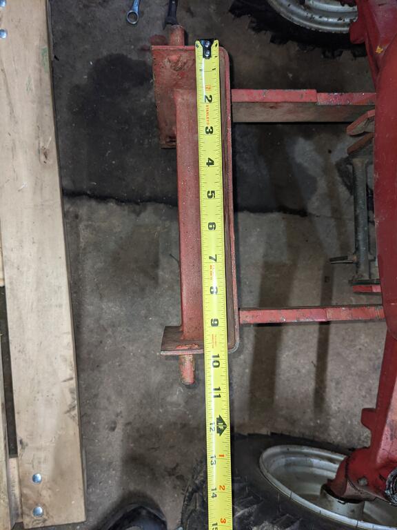

ebinmaine 80,932 #4 Posted March 30, 2021 I'd love to see close-ups of the bracket system. 1 Share this post Link to post Share on other sites
seuadr 490 #5 Posted March 30, 2021 @gwest_ca thanks for the link, unfortunately the belt is listed as "belt" no size :/ it came with a 78" belt but that isn't long enough, i am assuming because the 520H is longer. @ebinmaine i can get some tomorrow. it matches up to holes that were already in the wheelhorse frame and has a couple spacers to make it tight to the frame it is pretty simple. big problem i need to figure out is the front set of bolts are between the steering and the front tach-a-matic point and i can only get a couple fingers in there to hold a bolt, and there isn't enough room to feed a bolt in backwards so that it sticks out of the frame towards the tire cause you can't get a straight shot. not really sure what to do with it, may have to take the axle off so there is clearance and put a threaded stud in or something. 1 1 Share this post Link to post Share on other sites

seuadr 490 #8 Posted April 1, 2021 @ebinmaine PXL_20210331_235750010.mp4 1 3 Share this post Link to post Share on other sites
ebinmaine 80,932 #9 Posted April 1, 2021 @seuadr Absolutely awesome!!! THANKS. @Stepney is yours set up like this? 1 Share this post Link to post Share on other sites
seuadr 490 #10 Posted April 1, 2021 8 hours ago, ebinmaine said: @seuadr Absolutely awesome!!! THANKS. no problem. you can see in the picture that it is angled down, i don't know if that was intended for operation or if it is just because my front bolts are only finger tight because i can't get in there. 1 Share this post Link to post Share on other sites

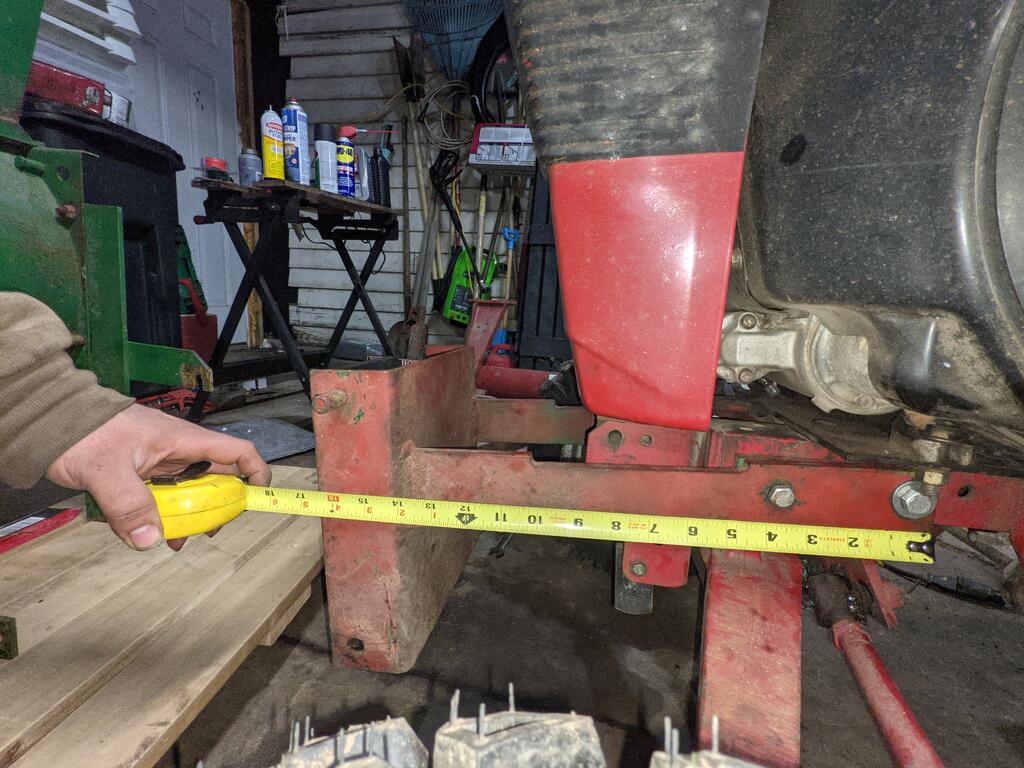

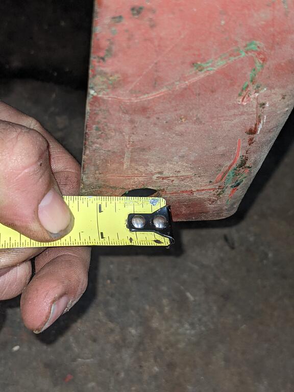

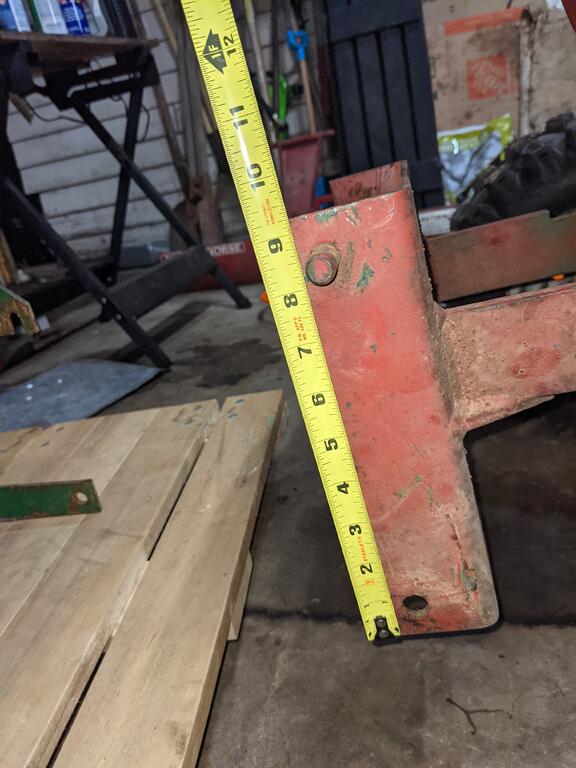

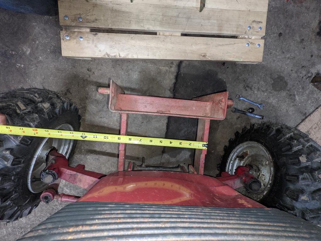

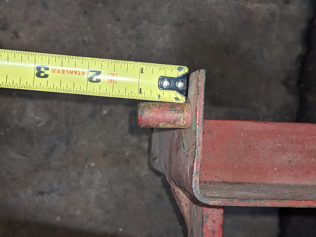

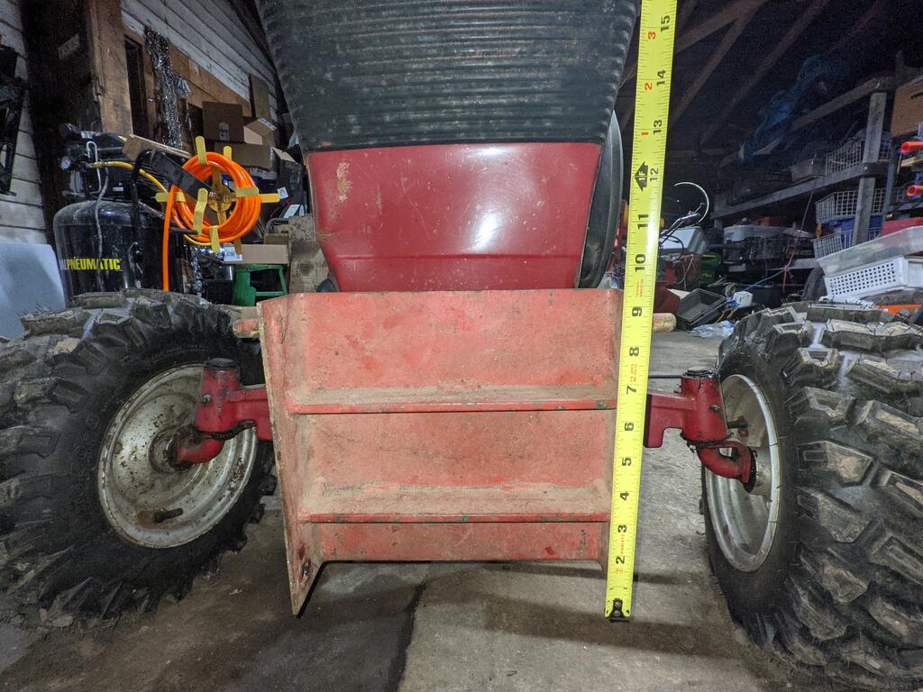

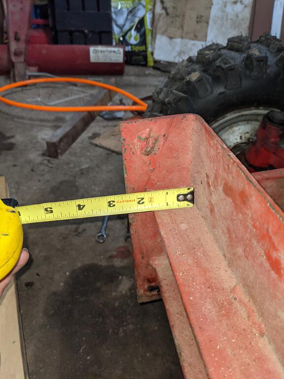

ebinmaine 80,932 #12 Posted April 6, 2021 On 3/31/2021 at 8:04 PM, seuadr said: @ebinmaine PXL_20210331_235750010.mp4 On 3/31/2021 at 8:04 PM, seuadr said: The bars that go from the front mount square and bolt directly to the frame... Are those just 3/8" x (2"? Or 2-1/2"?) bar stock welded to the mount?? 1 Share this post Link to post Share on other sites
seuadr 490 #13 Posted April 6, 2021 Just now, ebinmaine said: The bars that go from the front mount square and bolt directly to the frame... Are those just 3/8" x (2"? Or 2-1/2"?) bar stock welded to the mount?? 2" tall, 1/2" thick. looks like bar stock. 1 1 Share this post Link to post Share on other sites
ebinmaine 80,932 #14 Posted April 6, 2021 7 minutes ago, seuadr said: 2" tall, 1/2" thick. looks like bar stock. Looks like this will be an easy conversion for me. EXCELLENT. Share this post Link to post Share on other sites
Lee1977 7,805 #15 Posted April 7, 2021 (edited) On 4/1/2021 at 5:42 AM, seuadr said: no problem. you can see in the picture that it is angled down, i don't know if that was intended for operation or if it is just because my front bolts are only finger tight because i can't get in there. You could use a treaded rod to go all the way trough. Edited April 7, 2021 by Lee1977 2 Share this post Link to post Share on other sites
