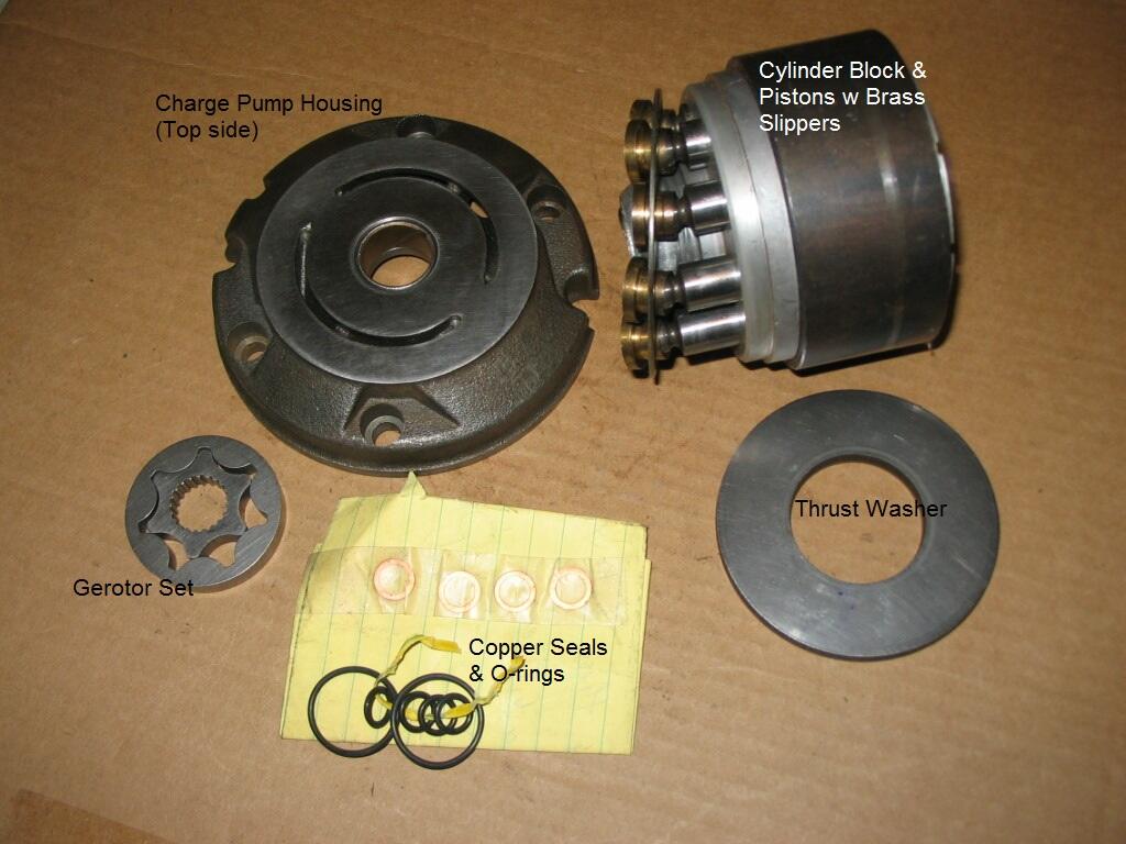

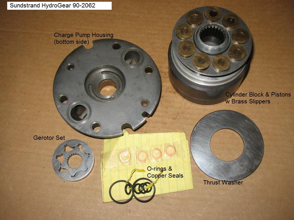

The GT-14 was made from 1969 -1972...meaning it is 50+ yrs old. With out a doubt, the hydro pump has internal wear causing low power which deteriorates as the hydro warms up...right?  There are internal soft brass surfaces that get scored causing loss of hydraulic pressure, leading to power loss.  The only solution is a rebuild.  You can try replacing the filter and fluid (ATF or motor oil) which mignt help a little bit, but eventually rebuild is in order.  Your GT-14 tractor has the Sundstrand model 90-2062 Hydro-Gear unit and I have the 'refurbished' parts you'll need.  That is, 1) Cylinder block & 9 brass pistons (2) charge pump housing with Gerotor set, (3) Thurst plate.  I can also provide you with a supplier for the Gaskets and O-rings needed. ps..I've rebuilt many of these over the 30 years of working with Wheelhorse tractors.

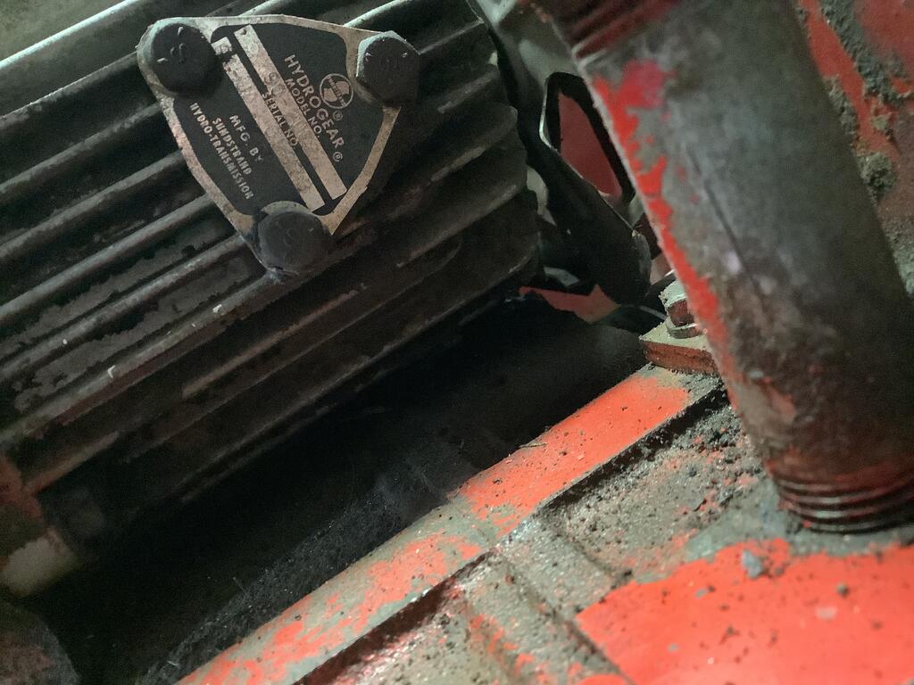

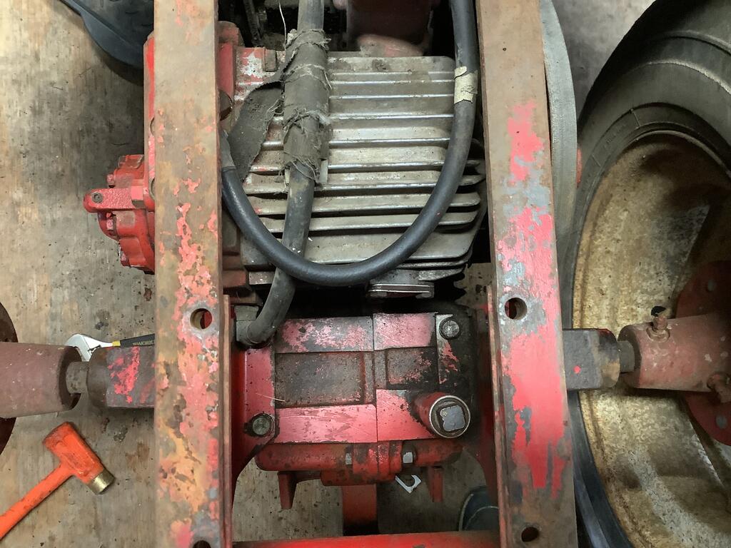

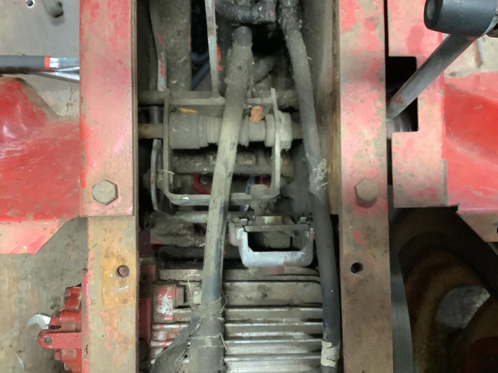

helpmefixmygt14
some pics

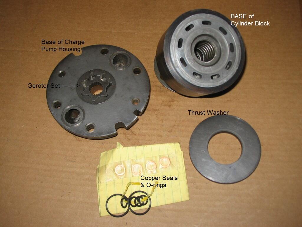

These are the Internal components I can provide.  The O-rings & Copper seals are new.  Both faces of the Charge Pump Housing AND the Gerotor set are resurfaced.  The Brass face of the 9 Piston slippers are hand refinished as well as the Base of the Cylinder Block.  The Thrust Washer is perfectly smooth too.
Email for price of lot   I am:
daveoman@windstream.net
I have other good used internal parts too...valves, springs, etc.
