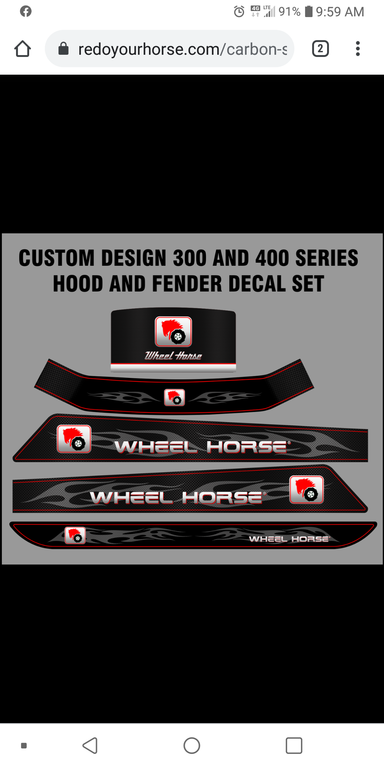

Cee245 853 #1 Posted March 4, 2021 I have a 86? 417A with the (louved?) Hood.. I figure I'll have room to store it inside my new shed and I'd like to clean it up this year as I have time. It's purpose is a back up mower / plow tractor. I'm going with the decals in the picture. I'm thinking of painting my wheel weights for it maybe flat or gloss? black and also painting all the rims black. Its not intended to be a show piece, but i plan on sand blasting / stripping all panels and easier accessible parts. I'll be using regal red as the color in a rattle can. I've read its a decent choice. I also bought 7/16-20x 1.5" bolts and nuts for the rear wheels so it'll be easier to take them off and put back on. I have them on my 416, and i love them. Thoughts? 3 3 Share this post Link to post Share on other sites
Achto 31,885 #2 Posted March 4, 2021 Love the decals!! I think you're making great choices. 1 Share this post Link to post Share on other sites
Cee245 853 #3 Posted March 5, 2021 Thanks @Achto. Does anyone have pics of their tractors with the black rims etc? Share this post Link to post Share on other sites
