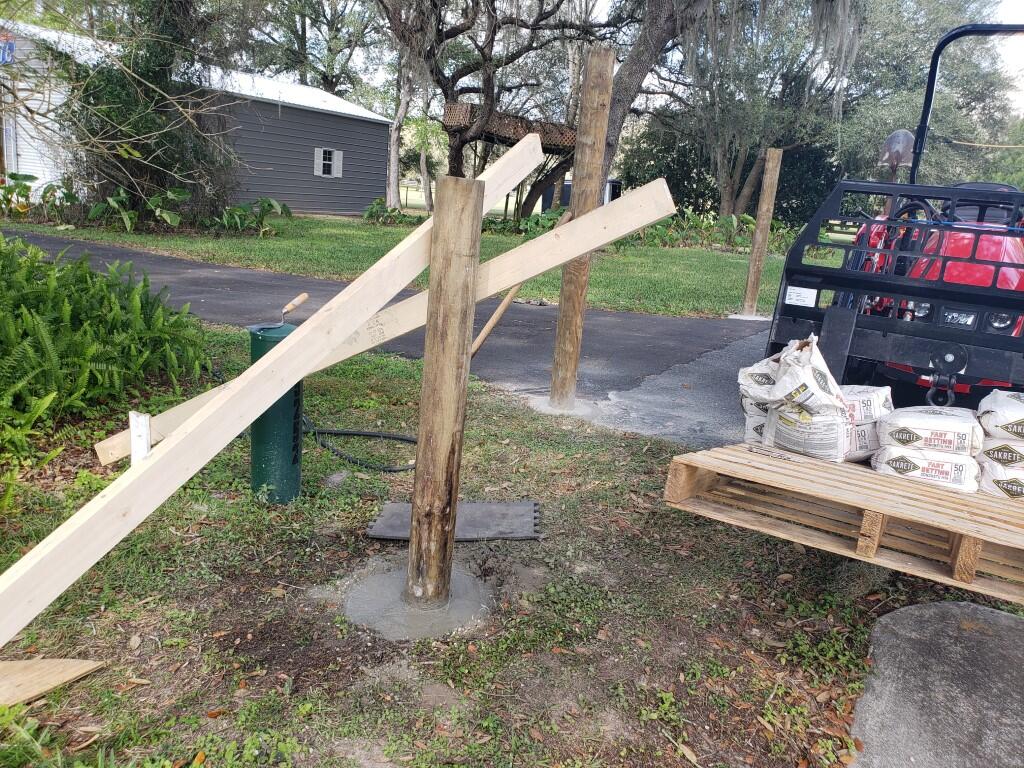

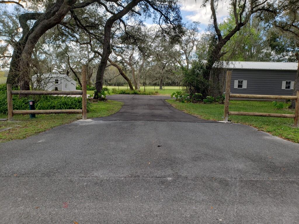

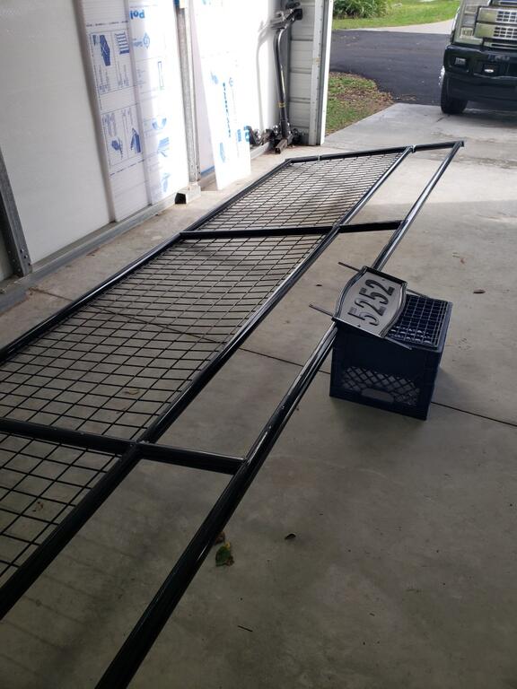

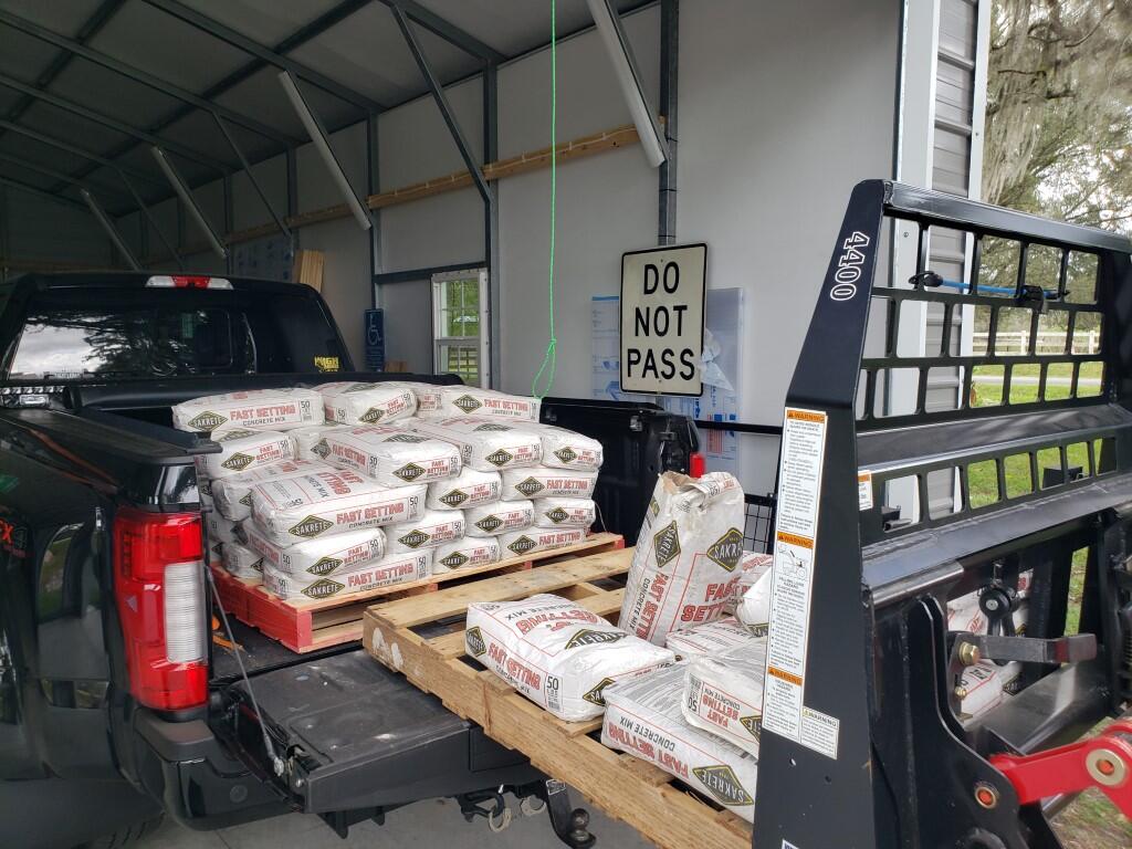

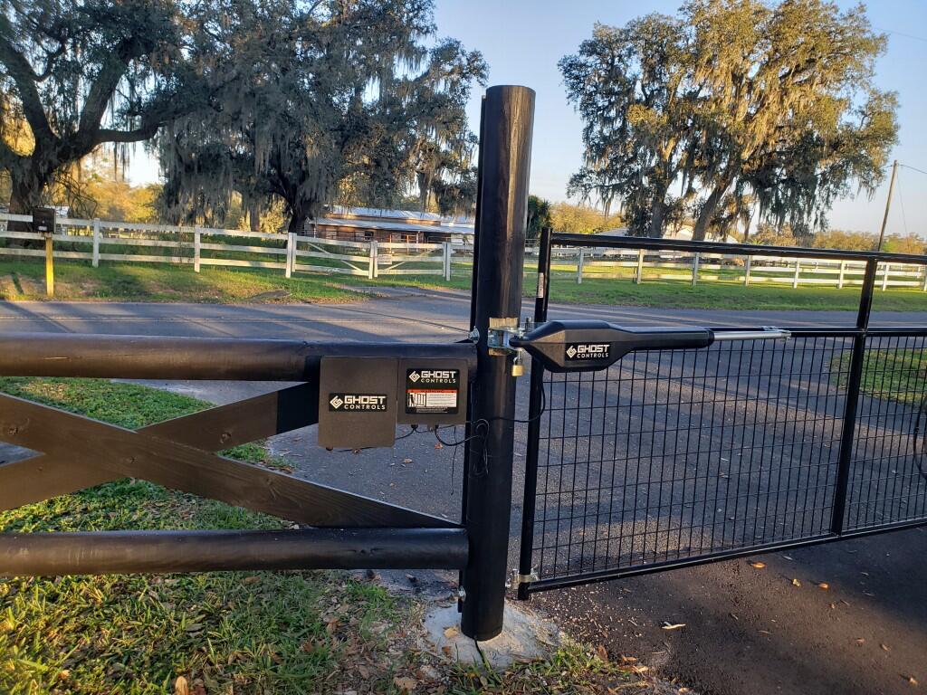

Zeek 2,299 #1 Posted February 25, 2021 I finally got around to installing a driveway gate with an opener. The main posts are 4' deep since the soil is sandy here the secondary's are 3' . So 50 bags of Fast Setting Concrete later . . . 8 10 Share this post Link to post Share on other sites
WHX?? 58,226 #2 Posted February 25, 2021 50 bags???? Just seems like an awful lot. Looks good tho. How did you fasten the horizontal posts to the verticals? Share this post Link to post Share on other sites

DennisThornton 4,773 #4 Posted February 25, 2021 1 minute ago, WHX24 said: 50 bags???? Just seems like an awful lot. Looks good tho. How did you fasten the horizontal posts to the verticals? Seems? Is an awful lot! My goodness! Share this post Link to post Share on other sites

Handy Don 17,495 #6 Posted February 25, 2021 2 hours ago, WHX24 said: 50 bags???? Just seems like an awful lot. Looks good tho. How did you fasten the horizontal posts to the verticals? 45 80# bags is a yard. For that I'd have called my local redi-mix delivery outfit. Pull up, set up in a couple minutes, a quick pour, and then on their way to the next job. 1 Share this post Link to post Share on other sites

WHX?? 58,226 #8 Posted February 25, 2021 (edited) All the ready mix outfits here won't get out out bed for just a yard Don. Last time I poured it was a 10 yard minimum. Nice to see that tractor is earning it's keep Zeek Edited February 25, 2021 by WHX24 2 Share this post Link to post Share on other sites

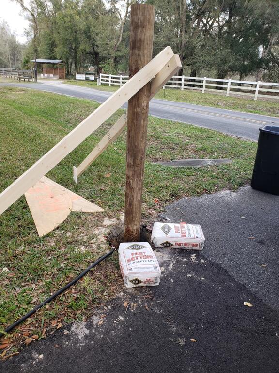

Zeek 2,299 #12 Posted February 25, 2021 (edited) 5 hours ago, WHX24 said: 50 bags???? Just seems like an awful lot. Looks good tho. How did you fasten the horizontal posts to the verticals? The posts are 6" wide. The primary holes are 18" wide x 4' deep. I got the calculations from Sakrete. General rule is hole is 1/3 pole height and 3x post diameter. I'm in sandy soil so I followed theirs and gate manufacturers recommendations. I suspect that's why you see so many sagging gates. My gate is 16' wide which is kind of long and my primary posts are 6' high. I did the opposite side the same incase I ever decided to change the swing side. If I was just installing fence, that is overkill except for corner king posts. Gates are a different story. I attached with these brackets and screws. They were about $2.50 at a farm supply store. I needed 8. 2 hours ago, WHX24 said: All the ready mix outfits here won't get out out bed for just a yard Don. Last time I poured it was a 10 yard minimum. Nice to see that tractor is earning it's keep Zeek Same here. Nobody is coming out for a four post pour that would be cost effective. Plus it didn't fit my time frame to dig four holes that deep, keep the water out and buy all the 2x4's to support all four at the same time. I'm like you all, I'm busy and had to spread it out over a few weeks since I work part-time everyday now. That gave me time to get the gate number sign done and get the tree thing ordered and get the opener shipped. Edited February 25, 2021 by Zeek 3 2 1 Share this post Link to post Share on other sites

Handy Don 17,495 #16 Posted February 26, 2021 1 hour ago, Zeek said: The posts are 6" wide. The primary holes are 18" wide x 4' deep. I got the calculations from Sakrete. General rule is hole is 1/3 pole height and 3x post diameter. I'm in sandy soil so I followed theirs and gate manufacturers recommendations. I suspect that's why you see so many sagging gates. My gate is 16' wide which is kind of long and my primary posts are 6' high. I did the opposite side the same incase I ever decided to change the swing side. If I was just installing fence, that is overkill except for corner king posts. Gates are a different story. I attached with these brackets and screws. They were about $2.50 at a farm supply store. I needed 8. Same here. Nobody is coming out for a four post pour that would be cost effective. Plus it didn't fit my time frame to dig four holes that deep, keep the water out and buy all the 2x4's to support all four at the same time. I'm like you all, I'm busy and had to spread it out over a few weeks since I work part-time everyday now. That gave me time to get the gate number sign done and get the tree thing ordered and get the opener shipped. I do get the issues with time and scale. My Dad taught me and my brothers to mix concrete in an old electric-powered mixer. Most of our chore time one summer was spent putting in front, rear and side walks for our new house (layout, dig, forms, mix, pour, finish)--over 200' at 30" wide. The supervisor (Dad) checked our work every night. Our local has big trucks for the big jobs and does plenty of those. But they take small jobs where they tell you the day they'll be where you are and the time they can be there--the truck has sand, gravel, cement, and water all in separate bins and mixes as it delivers--pretty slick. Last time I checked the min was ½ yard and the price was fair. Might not make sense for posts, but for replacing a couple sections of sidewalk its a no brainer. 1 Share this post Link to post Share on other sites

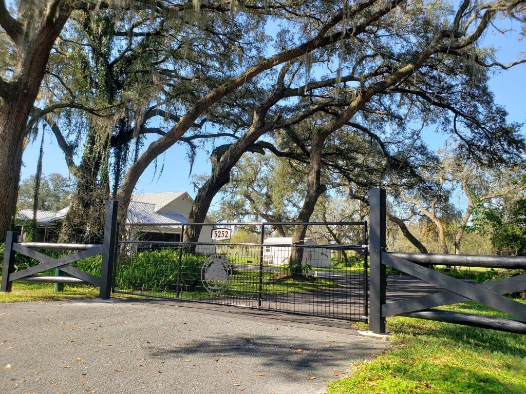

Pullstart 71,329 #17 Posted February 26, 2021 Looks great @Zeek! I see the finish is square posts, are they clad with a sleeve or home built something? I recall doing a 21 80# bag pour one night, with my FIL at the old house. We both got up between 3 and 3:30 for work each day, but at 9 at night we decided it shouldn’t take too long. One wheelbarrow, one hoe. We were both worthless at work the next day! Share this post Link to post Share on other sites

WHX?? 58,226 #19 Posted February 26, 2021 12 hours ago, pullstart said: I see the finish is square posts, Sure look square in the last pic??? Share this post Link to post Share on other sites
Zeek 2,299 #20 Posted February 26, 2021 15 hours ago, pullstart said: Looks great @Zeek! I see the finish is square posts, are they clad with a sleeve or home built something? 2 hours ago, WHX24 said: Sure look square in the last pic??? The posts are all round. I attached 1x6 fence boards to the face of the vertical posts and added cross pieces of 1x6. 1 Share this post Link to post Share on other sites
WHX?? 58,226 #21 Posted February 26, 2021 I kinda like the round look.... I live in a log home tho... Stupid ? Zeek why didn't you just use treated 6×6s then? Share this post Link to post Share on other sites
Zeek 2,299 #22 Posted February 26, 2021 1 minute ago, WHX24 said: I kinda like the round look.... I live in a log home tho... Stupid ? Zeek why didn't you just use treated 6×6s then? The posts are a true 6" in diameter so more wood. 6x6 square treated are actually 5.5"x5.5" in reality and looked too small from a distance. Plus I wanted the multi-dimensional beefier look, not single posts if that makes sense. Posts are cheap down here at Sparr Farm Supply. They make the actual poles in nearby Tarrytown, FL. 3 Share this post Link to post Share on other sites

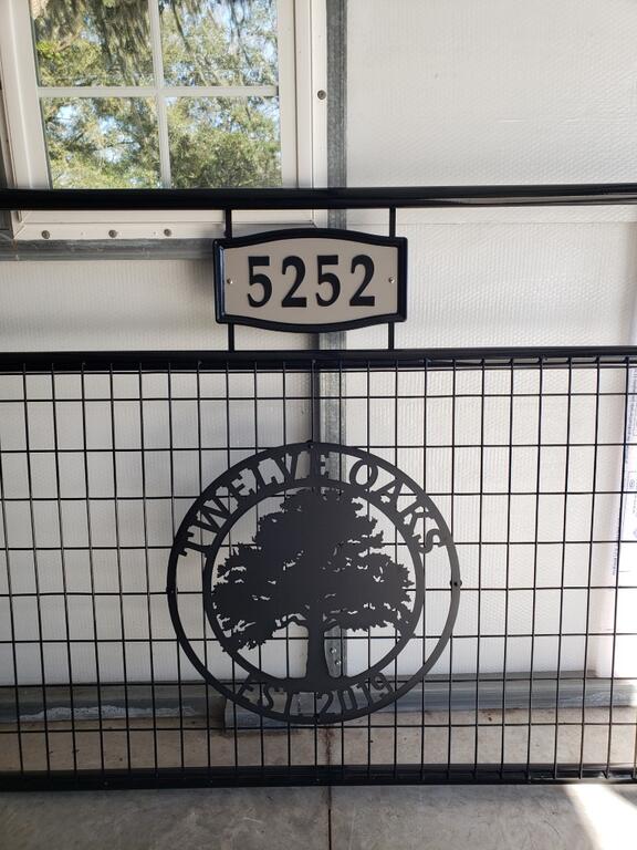

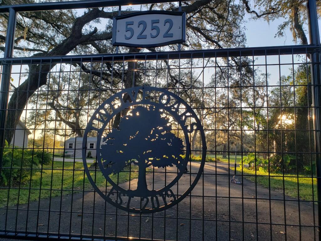

formariz 12,381 #25 Posted February 27, 2021 Its amazing how something so simple can totally change the look of a place. Great elegant design and great logo on it. One can not drive by and not take a second look. Very well done . 1 Share this post Link to post Share on other sites
