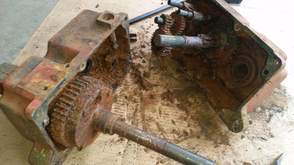

WHX?? 57,922 #76 Posted April 16, 2021 (edited) I love it when a plan comes together says the A team dude! Did you use that material under the motor that work donated to the cause? It really does work good for a mounting pad. 48 minutes ago, Achto said: changed all of the shaft seals on the transmission How do you always seem to get away with just seals? I saved a bit of the rust dust in case you wanted to be a real bro and snort some like I had to do off the wire wheel! Had brown boogers for a week! This is where I stand but just getting baby steps done. Life keeps getting in the way. Edited April 16, 2021 by WHX24 6 2 Share this post Link to post Share on other sites
rjg854 13,330 #77 Posted April 16, 2021 28 minutes ago, WHX24 said: I saved a bit of the rust dust in case you wanted to be a real bro and snort some like I had to do off the wire wheel! Had brown boogers for a week! After you put it back together, this time use gear lube, instead of water, and you won't have that condition again. 7 Share this post Link to post Share on other sites
Achto 32,510 #78 Posted April 17, 2021 2 hours ago, WHX24 said: Did you use that material under the motor that work donated to the cause? It really does work good for a mounting pad. Bolted it right down to the frame. Figured it was good enough for the Pond's, good enough for me. 2 hours ago, WHX24 said: How do you always seem to get away with just seals? Sorry about your tranny Jim, It's hard to get quality goods for free. I'll pass on snorting the rust dust, had a enough of that with this project to last me a while. 1 3 Share this post Link to post Share on other sites

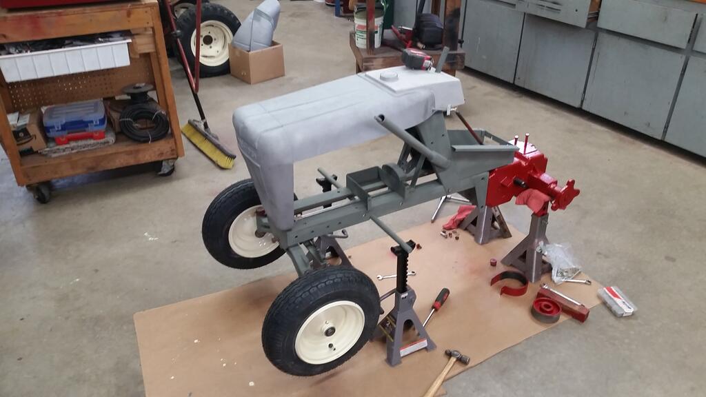

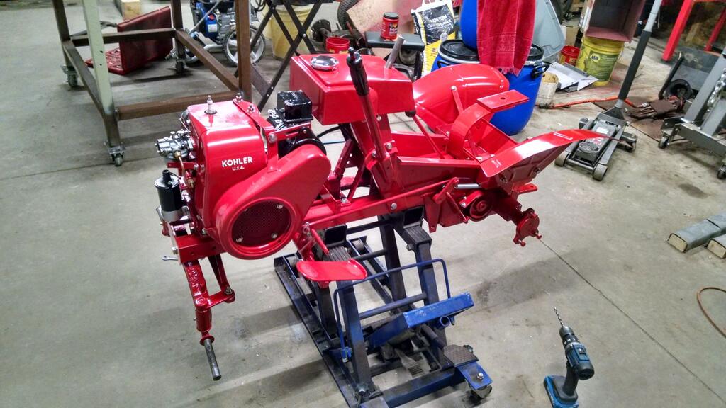

Achto 32,510 #79 Posted April 18, 2021 (edited) A late start to my day & had to quit earlier than I wished, but I was able to make some progress. First thing on my agenda was to pull the head and de-carbon it. I was happy to see that there was little to no piston wash when I pulled the head off. There was also good cross hatch on the cylinder walls. Engine looks much better with a nice clean head free of any paint or crud. Tins back on the engine and the dash tower installed. I had to walk away after I came to this point. Hope to be able to get the wiring done tomorrow. Waiting for a couple of parts yet other wise I would be able to button it up the rest of the way. Edited April 18, 2021 by Achto 2 7 3 Share this post Link to post Share on other sites

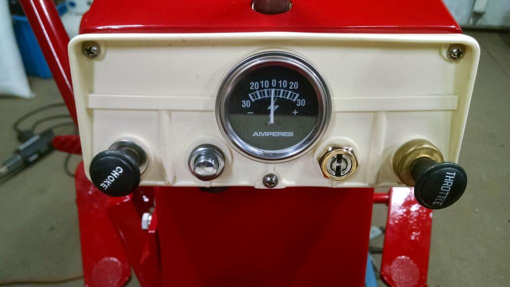

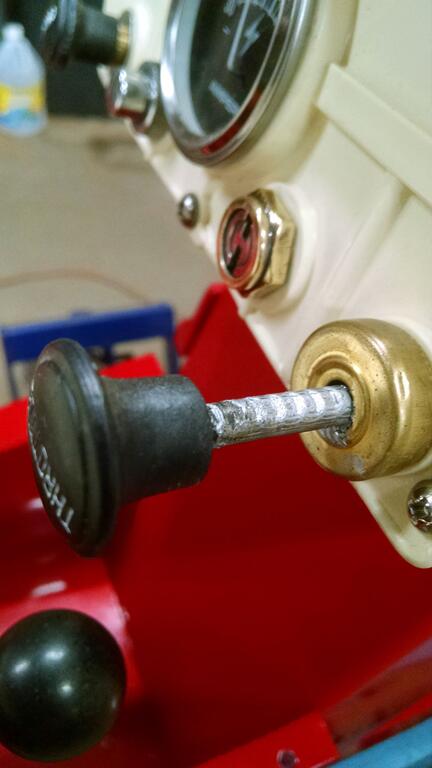

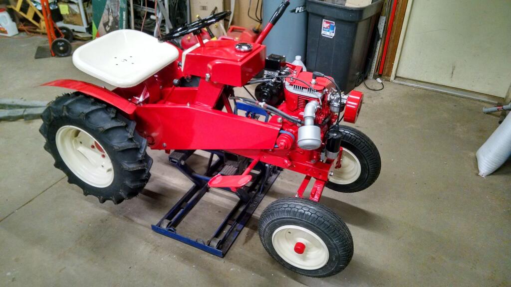

Achto 32,510 #82 Posted April 19, 2021 (edited) Started out my day polishing up the old switches. Then it was on to getting the wiring done. Wiring is one of those jobs that consumes a fair amount of time with little wow factor to show off. I will start pictures with showing the dash all put together. I neglected to look for a 10-0-10 ammeter but I can live with the 30-0-30 meter that was on the tractor when I bought it. I ordered Willy's Jeep throttle & choke cables from I had to install some 3/8" x 5/8" x 1/4" bushings in the dash to reduce the holes enough to install the new cables. I do think that I'm going to be very happy with the locking mechanism on the throttle cable. It's not a pinch locking system, instead it has a ratchet mechanism. 1/4 turn allows the ratchet to catch, 1/4 turn the other way releases the ratchet. I tried to find these again so that I could post a link, but of course I can't seem to find them again. When I tried to install the locking collar on to the steering shaft it would not slide over the paint that was on the shaft. To make the collar fit I had to sand all of the paint off from the shaft, put every thing together and then cover the tractor up and respray the steering shaft. Currently I am 1 sediment bowl away from being able to finish the project. A bit bummed about the sediment bowl thing, but hopefully it will show up in the mail this week. Until the part shows up, I'll leave you all with this last picture. Edited April 19, 2021 by Achto 9 2 Share this post Link to post Share on other sites

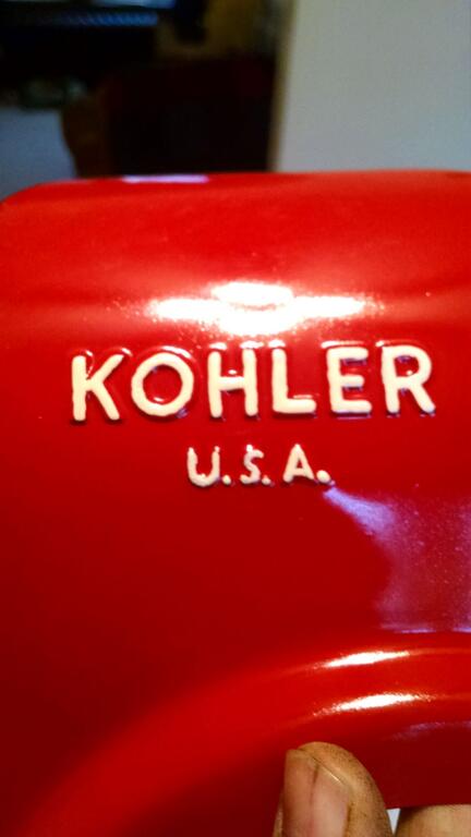

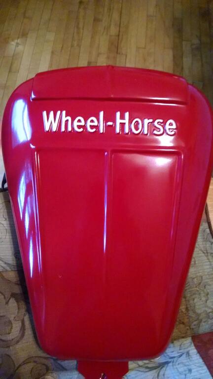

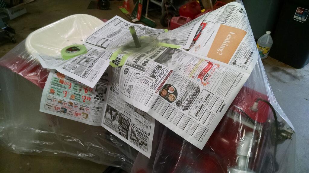

Achto 32,510 #85 Posted April 20, 2021 Wife was off getting her teeth floated tonight. While she was gone I decided to take advantage of the quiet time and get my hood lettered. I know that Terry now makes some awesome decals to letter your hoods, but I kinda enjoy the artsy time and I can do an OK job with a brush. As long as I had the brush & paint out I also lettered an engine shroud that I had sprayed for Jim. @WHX24 8 1 2 Share this post Link to post Share on other sites

WHX?? 57,922 #88 Posted April 22, 2021 The cables mentioned Black choke + Throttle cables with Metal knobs Fit Willys CJ2A CJ3A CJ3B jeep | eBay I am going to try and cover them with a small piece of black shrink wrap if it pans out cover the whole cable. I'll have to put up a post of the original amp meter I am going to use. 4 1 Share this post Link to post Share on other sites

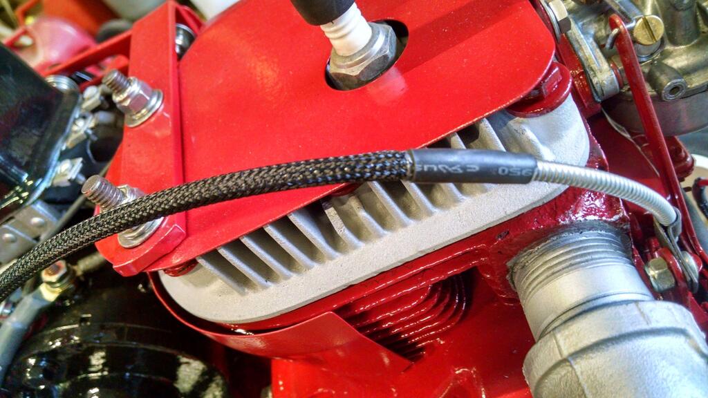

Achto 32,510 #89 Posted April 22, 2021 53 minutes ago, WHX24 said: I am going to try and cover them with a small piece of black shrink wrap if it pans out cover the whole cable Thanks for posting that link Jim. I covered my cables with braided wire loom, then put a short piece of shrink wrap on the ends to cap it off. I left the loom back a ways where the cable goes over the exhaust figuring that it might melt in that area. It turned out looking very good. I'll get some close ups later today. 3 Share this post Link to post Share on other sites

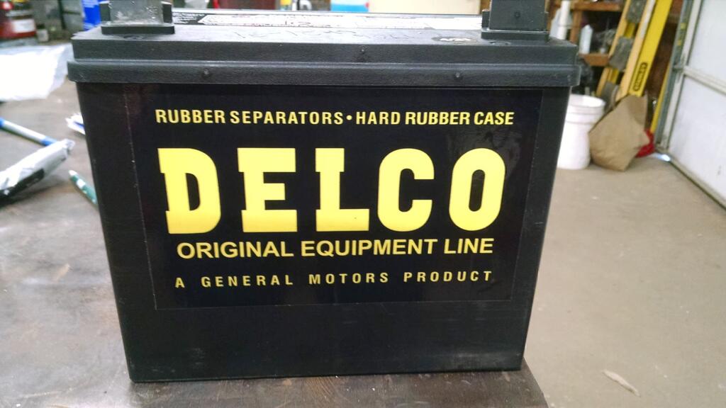

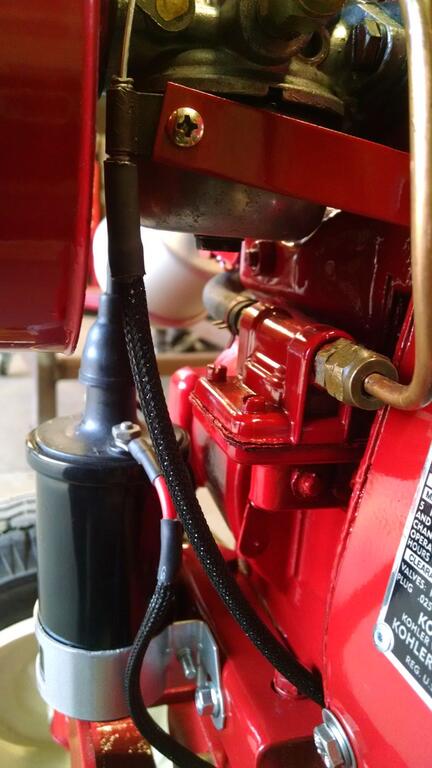

Achto 32,510 #91 Posted April 23, 2021 11 hours ago, WHX24 said: I am going to try and cover them with a small piece of black shrink wrap As promised, here are some picture of how the cables look with braided wire loom on them. Last night I installed my new sediment bulb then left it sit over night so that anaerobic sealant that I used on the threads would have a chance to set up. I thought that tonight would be a good night to install a battery and see if the ole girl would come back to life. Before installing the battery I added a little bling to it, I think that the old school decal from Terry is a nice touch for an older tractor. After installing the battery, adding a little gasoline to the tank, and working the primer pump a few times. I'm happy to say that it fired right up. Then it was time to take her out topless for a cruise,I'm happy to report that it ran and drove beautifully. Sorry no pictures, I'll get you guys some glammer shots when she has her top on. Oh ya, @pullstart might get a kick out of this. Some "Jack Wagon" got a little carried away with the never seize when he was putting the exhaust together. Spent a good 30min cleaning that mess up after I ran the engine, 2 4 2 Share this post Link to post Share on other sites

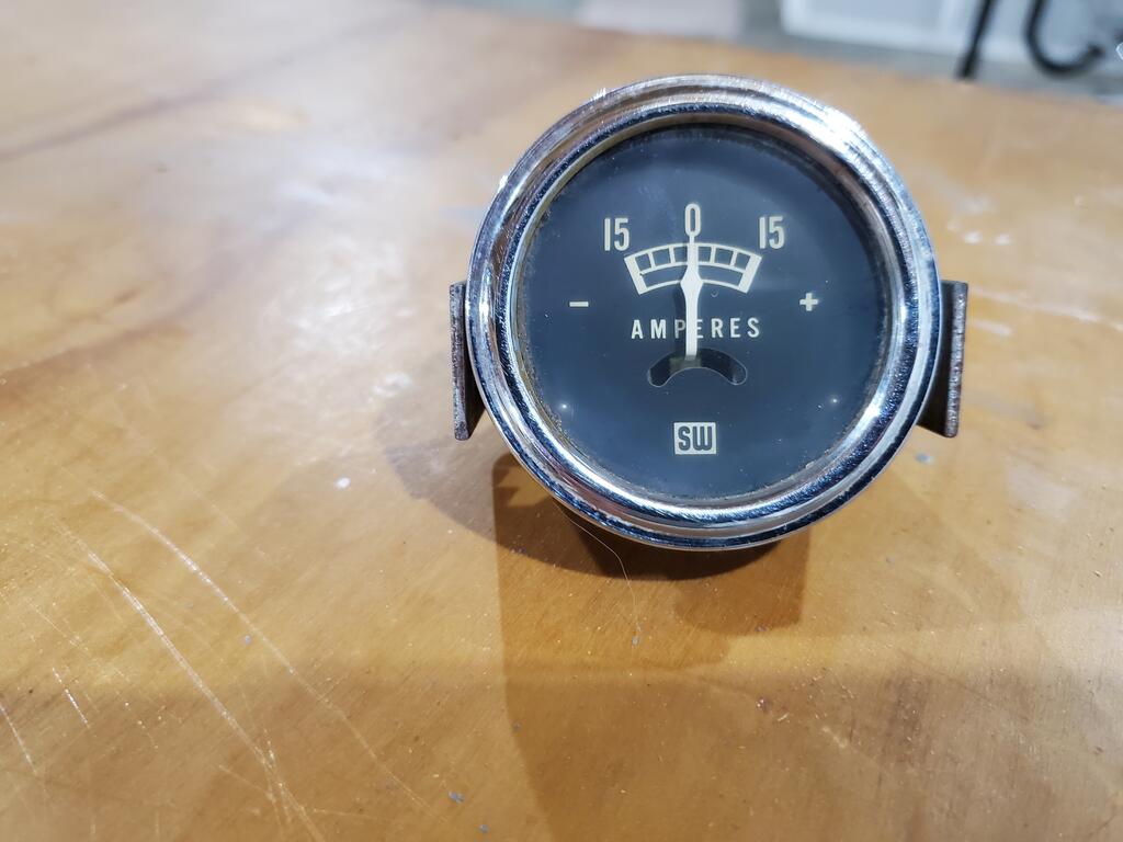

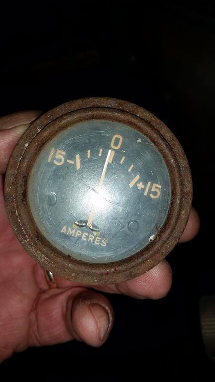

WHX?? 57,922 #93 Posted April 23, 2021 On 4/18/2021 at 8:36 PM, Achto said: I neglected to look for a 10-0-10 ammeter but I can live with the 30-0-30 meter Didn't you say @Racinbobhad something for you??? I really don't know why you guys keep bad mouthing him I think he is a pretty decent guy..... What I am going to use patina and all. I have no reason to believe this is not original and if it don't work so be it will just be ther for another conversation piece. 2 Share this post Link to post Share on other sites
WHX?? 57,922 #94 Posted April 23, 2021 Thats the same kinda Chinese finger trap wire loom I have then Dan and was not overly confident on it's abrasion resistance. That battery decal is t's on a ritz!!!!! 1 1 Share this post Link to post Share on other sites

Racinbob 13,122 #97 Posted April 23, 2021 9 hours ago, WHX24 said: Didn't you say @Racinbobhad something for you??? I really don't know why you guys keep bad mouthing him I think he is a pretty decent guy..... What I am going to use patina and all. I have no reason to believe this is not original and if it don't work so be it will just be ther for another conversation piece. I work hard to deserve the bad mouthing. You and Dan need to communicate more often. I think I could have figured out how to toss the 15 in with the 10. It doesn't have the swing the 10 has though. I checked all three out for continuity and that was good so I'm assuming they work fine. Let me know if you need it Jim. 4 Share this post Link to post Share on other sites
WHX?? 57,922 #98 Posted April 23, 2021 Thanks Bob But I don't think I will as if it's shot it will be there just to fill a hole and match some other special patina items I have for her. Kinda like a frame off resto but not. 8 hours ago, OutdoorEnvy said: I leave my local Ace I usually say "see you in 20!" The Ace clerk as I wander aimlessly around wondering what I am forgetting. " Sir the anti-seize is over here" 1 4 Share this post Link to post Share on other sites

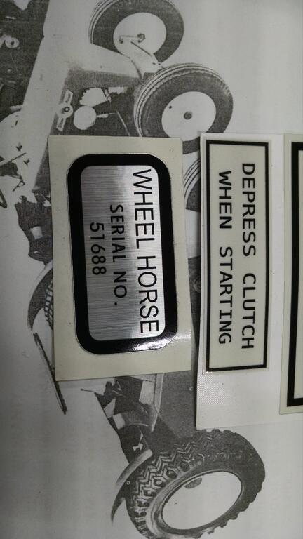

Achto 32,510 #99 Posted April 25, 2021 Does anyone have a picture of the correct location for these decals? @Lane Ranger? 2 Share this post Link to post Share on other sites
Lane Ranger 12,094 #100 Posted April 25, 2021 (edited) My Hein Werner hy2 unit obstructs the decal location on dash tower. I believe they are both on dash tower in front of shifter. Edited April 25, 2021 by Lane Ranger 1 1 Share this post Link to post Share on other sites
