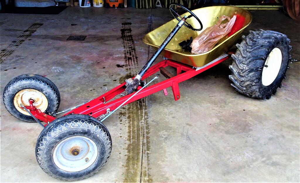

giddyap 1,574 #3 Posted February 20, 2021 As cheap as snowplows are these days, I figured my extra one would be an economical base to build upon. The gold is just some cheap paint to highlight the dry cement and dents. 6 6 1 4 Share this post Link to post Share on other sites

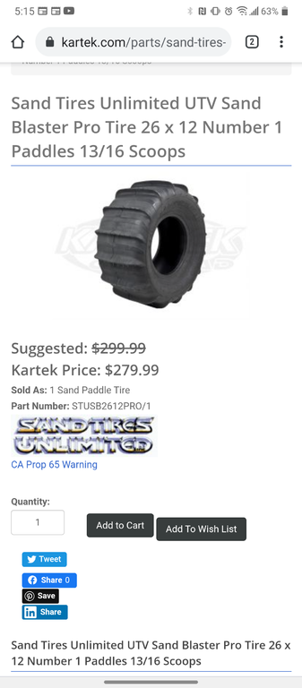

giddyap 1,574 #10 Posted February 20, 2021 6 minutes ago, WVHillbilly520H said: maybe later a set of 24x12-12 turfs for some smooth riding steam rollers? Yes, My Cub 100 is wearing a pair of those and I can switch em. During this mock up stage I'm dreaming of Silver Lake Michigan running wild on the sand dunes 2 3 2 Share this post Link to post Share on other sites
Slimpickins 61 #11 Posted February 20, 2021 30 minutes ago, giddyap said: Yes, My Cub 100 is wearing a pair of those and I can switch em. During this mock up stage I'm dreaming of Silver Lake Michigan running wild on the sand dunes Have a go at test hill I'd like to see that. 2 Share this post Link to post Share on other sites
JoeM 10,317 #12 Posted February 20, 2021 I like it yap! 1 3 Share this post Link to post Share on other sites
WVHillbilly520H 10,379 #13 Posted February 20, 2021 (edited) 1 hour ago, giddyap said: Yes, My Cub 100 is wearing a pair of those and I can switch em. During this mock up stage I'm dreaming of Silver Lake Michigan running wild on the sand dunes Like these... Or ... Edited February 20, 2021 by WVHillbilly520H 2 Share this post Link to post Share on other sites

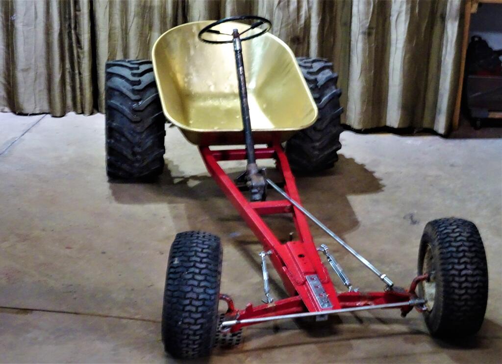

giddyap 1,574 #19 Posted February 22, 2021 Today's progress was cutting a hole in the bucket thus committing the location of the sleering box location. Upon review I am going to move everything back 6" because I may have to open the "dash" to extend my legs. The go kart seat I am considering may also need extra space and I think opening the back will also be required, but with careful consideration to retaining cosmectic apperance. The addition of a short truck bed will help with the seat location and will hold the battery and gas tank. The drive belt is my biggest concern clearing the tub to a pulley on the solid axle. Engine in the front, no transmission, centrifugal clutch and one forward speed. I also have to shorten the steering column 3 1 Share this post Link to post Share on other sites

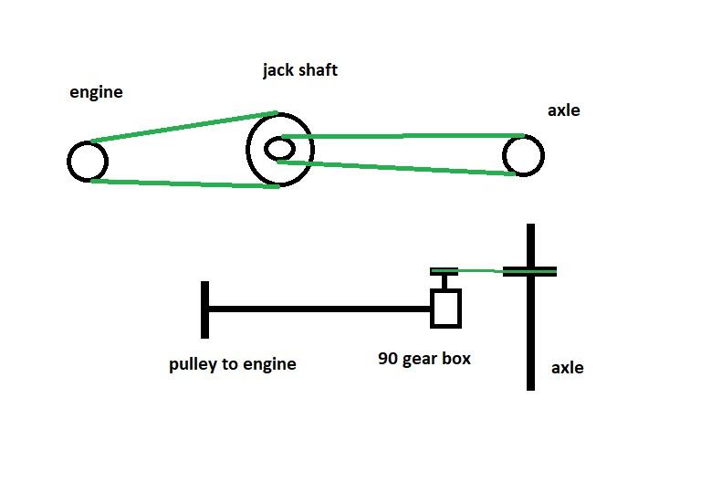

wallfish 20,707 #20 Posted February 22, 2021 3 hours ago, giddyap said: The drive belt is my biggest concern clearing the tub to a pulley on the solid axle. Maybe cut down the size of the axle pulley by using a jack shaft with pulleys between the engine and axle? Or a right angle gear box and or use of a torque converter instead of a centrifugal clutch? 5 2 Share this post Link to post Share on other sites
953 nut 69,939 #21 Posted February 22, 2021 Not too long ago @dells68 was building a wheelbarrowwheelhorse custom and @prondzy built the "Tub Rat" so rest assured you aren't breaking any laws around here. Also, John @wallfish made a motorcycle out of a snowplow frame. 5 Share this post Link to post Share on other sites

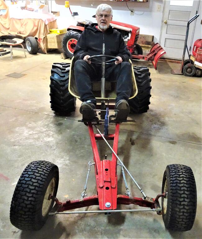

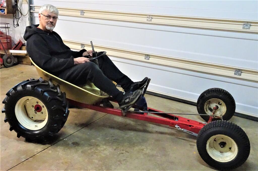

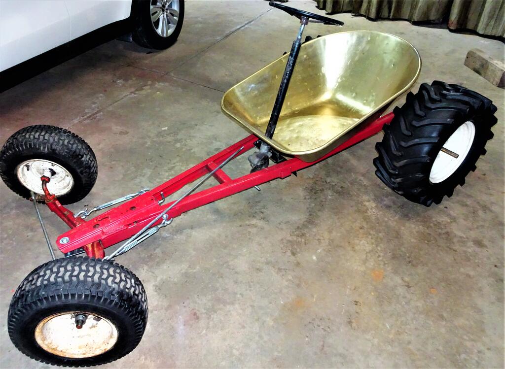

giddyap 1,574 #22 Posted February 23, 2021 11 hours ago, wallfish said: Maybe cut down the size of the axle pulley by using a jack shaft with pulleys between the engine and axle Great idea wallfish. together with your "engineering blueprint" I now have a very good idea how I will setup the jack shalft I had Donna take these photos so I could see how it fits me. I now see I would rather keep my feet inside and stretch the bucket But that can change. I got my second covid-19 shot today 5 3 1 Share this post Link to post Share on other sites

8ntruck 9,356 #24 Posted February 23, 2021 I agree with keeping th our feet inside the tub. Go ahead and stretch it. Maybe find a donor tub to help you along. 1 Share this post Link to post Share on other sites
Pullstart 71,468 #25 Posted February 23, 2021 @giddyap I don’t recall, do you weld? I’m sure the stretching of a tub has very similar shapes with the lip, but there will likely be a lot of pie cuts and shaping to go along... Share this post Link to post Share on other sites
