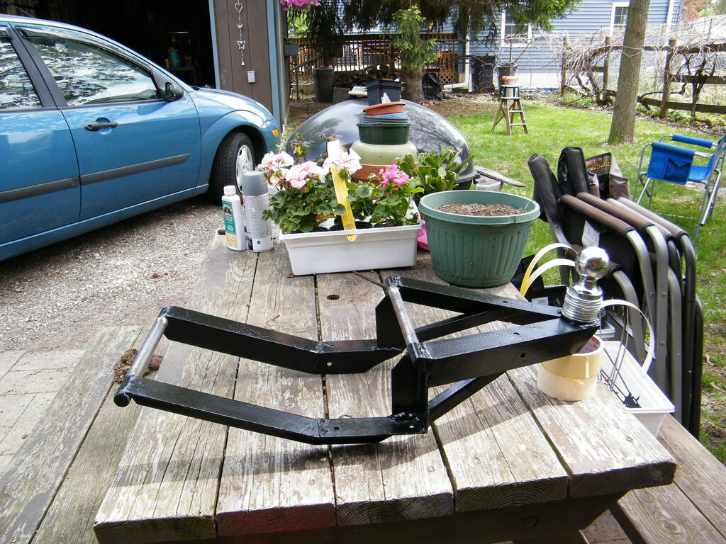

BeninCT 451 #1 Posted February 7, 2021 (edited) Currently have the stock hitch and I do have a boat I need to tow around the yard and after cleaning it all up yesterday I realized its pretty low for the boat trailer. Also realized I have a 2” receiver lying around my shop that I could cut up and make into something multipurpose for the rear of this thing. Anyone have any pictures of something that might be of interest? Could dream up my own but best to do a little homework first. Edited February 7, 2021 by BeninCT 1 Share this post Link to post Share on other sites

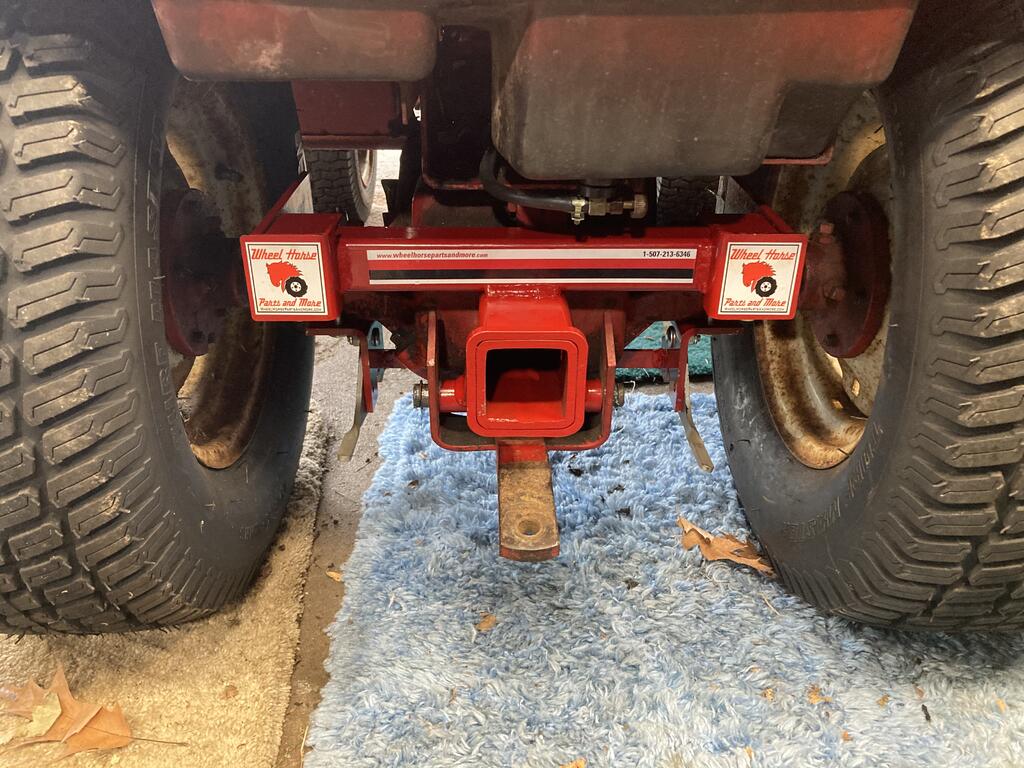

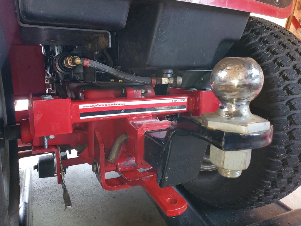

Racinbob 13,193 #2 Posted February 7, 2021 Ya can't beat this one available here: Hitches Archives - Wheel Horse Parts and More 4 3 Share this post Link to post Share on other sites
953 nut 69,359 #3 Posted February 7, 2021 Lowell makes some very nice hitches for the rear of a Wheel Horse at a reasonable price. https://wheelhorsepartsandmore.com/product-category/hitches/ Several members have made up hitches that clip into the front Atach-A-Matic where the mule drive goes which make backing a boat up much easier. 3 1 Share this post Link to post Share on other sites

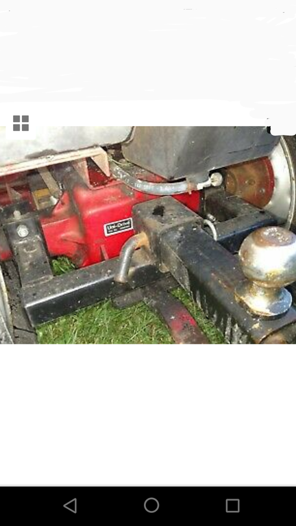

BeninCT 451 #7 Posted February 7, 2021 Just now, Maxwell-8 said: I don't know how big your boat is and on which type trailer, but be careful about tongue weight. She will pull almost everything, and like @ebinmaine always says the brakes are your limit. Flat ground on grass mostly but its a 17’er and think the boat and trailer are maybe 2500. Great point though @ebinmaine about the brakes! 2 Share this post Link to post Share on other sites

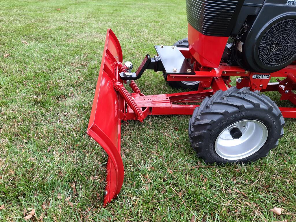

cschannuth 3,821 #9 Posted February 7, 2021 (edited) I have a receiver that goes on the front of my spray tractor that I use to add a couple of suitcase weights to the front when my sprayer out back is full. It also works well with a hitch. I think I got it off of flee Bay but I really can’t remember. They also have some on there that just have a regular hitch pin hole that works for a trailer ball I think. Edited February 7, 2021 by cschannuth 8 1 Share this post Link to post Share on other sites

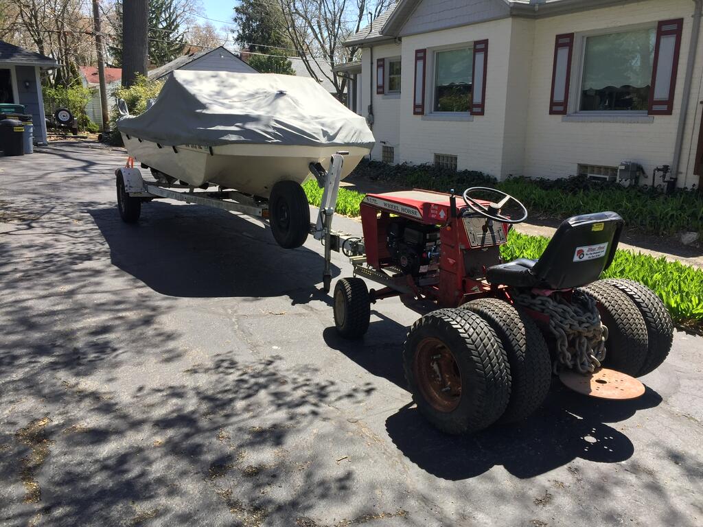

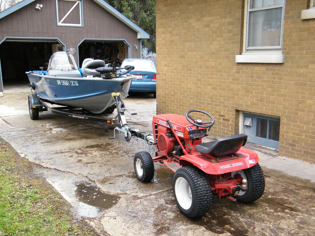

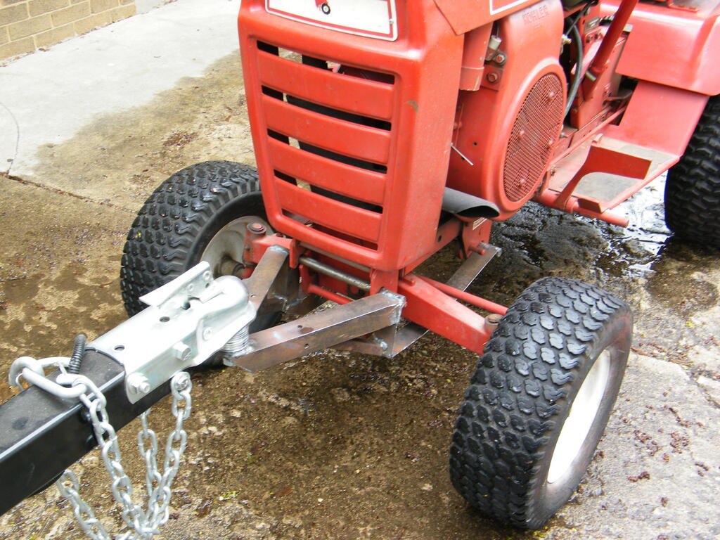

stevasaurus 23,856 #12 Posted February 7, 2021 Like was said, the ball needs to be high enough to get the jack up. The rear one here was made by 1Niederfan from Michigan...also one of our vendors. The front hitch was made by Shorts. Sometimes it is easier to push the boat trailer...easier on the neck also. 5 4 Share this post Link to post Share on other sites

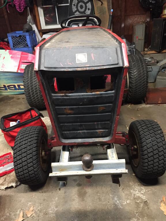

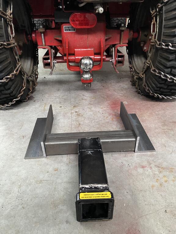

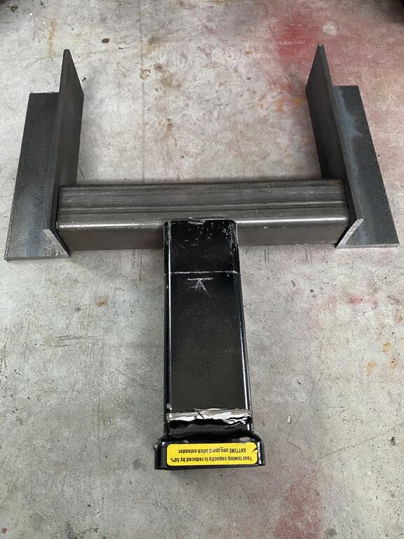

BeninCT 451 #13 Posted February 7, 2021 Great forum you guys have here! So many really useful responses in such short time! So as I mentioned I have an old piece of a receiver hitch extension in my shop and some angle. Went out there and came up with this in short time this morning. The angles are 3 x 3 x 1/4 which is overkill but there is room and its what I had. Didn’t want to go thinner (though looks like most people did and no problem) because the bolts from the plow mount will hold this on the axle and the bars for those bolts are 1/4 x 1” or so. May rip them down to 3x2 or 2x2 or so if I get inspired and plasma cutter will do it. I have a Chinese plasma cutter that is able to cut 1/4 but I haven’t yet learned the patience to do it well (go slow). Cross tube is 1 1/2” with 1/4 walls so very heavy and fits inside the piece of receiver hitch so I am going to notch out the sides on the front end of the receiver tube to just leave the top and bottom of it so I can weld all around- cope it over the smaller tube. Should be really strong and plenty high. Braces to lower pin will be incorporated once the top piece is together. 6 5 Share this post Link to post Share on other sites

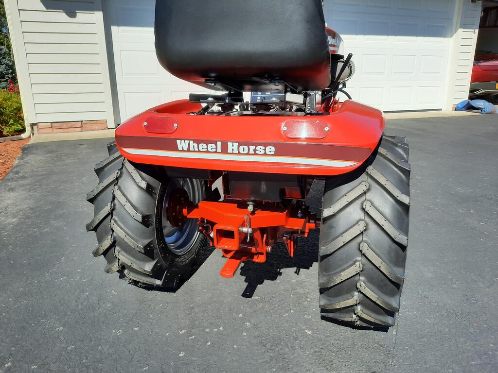

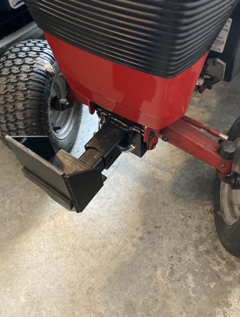

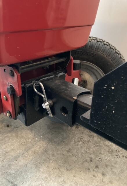

Bill D 3,156 #15 Posted February 7, 2021 I made this for my tractor. Just curious what you did with the old Trac Vac hitch? 2 Share this post Link to post Share on other sites

BeninCT 451 #19 Posted February 8, 2021 6 hours ago, Bill D said: I made this for my tractor. Just curious what you did with the old Trac Vac hitch? Nice mine will be very similar. I have that trac vac hitch on a shelf. No intent to use it, interested? Not sure I have the time to ship it right now. Too GD busy but let me know. 1 1 Share this post Link to post Share on other sites
Bill D 3,156 #20 Posted February 8, 2021 (edited) 3 hours ago, BeninCT said: Nice mine will be very similar. I have that trac vac hitch on a shelf. No intent to use it, interested? Not sure I have the time to ship it right now. Too GD busy but let me know. I could use that if you don't want it. PM with your asking price and we can go from there. No rush on shipping. No plans to vacuum my snow. Edited February 8, 2021 by Bill D 1 2 Share this post Link to post Share on other sites

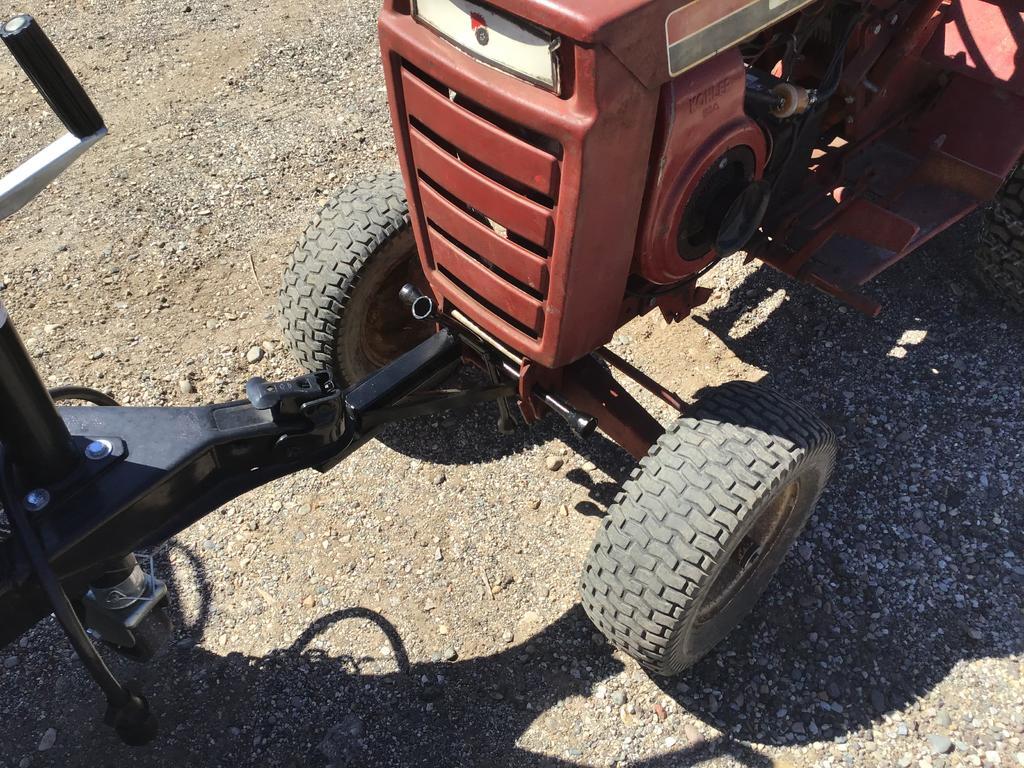

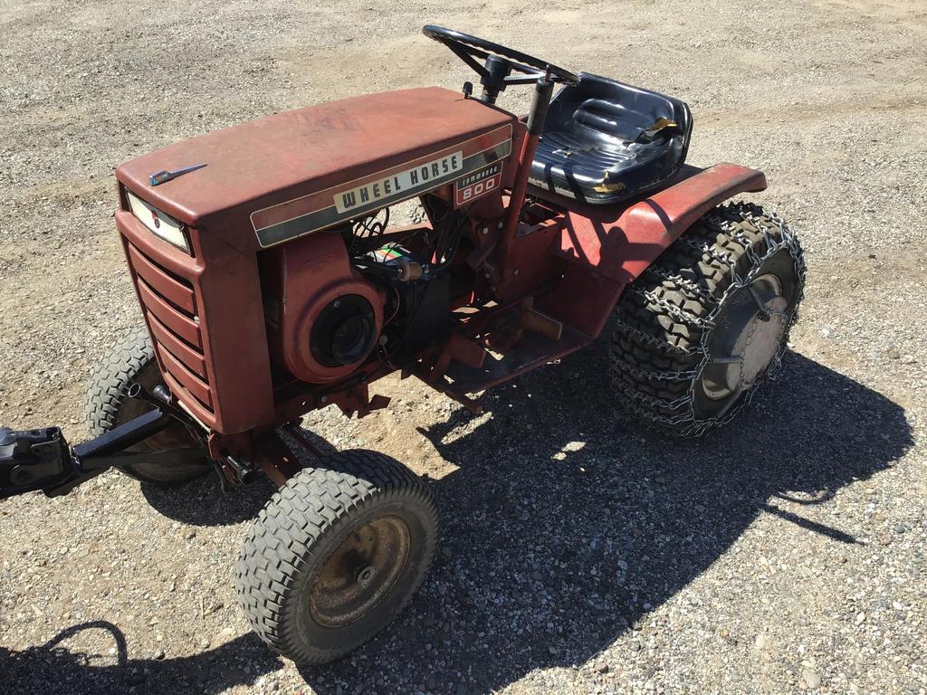

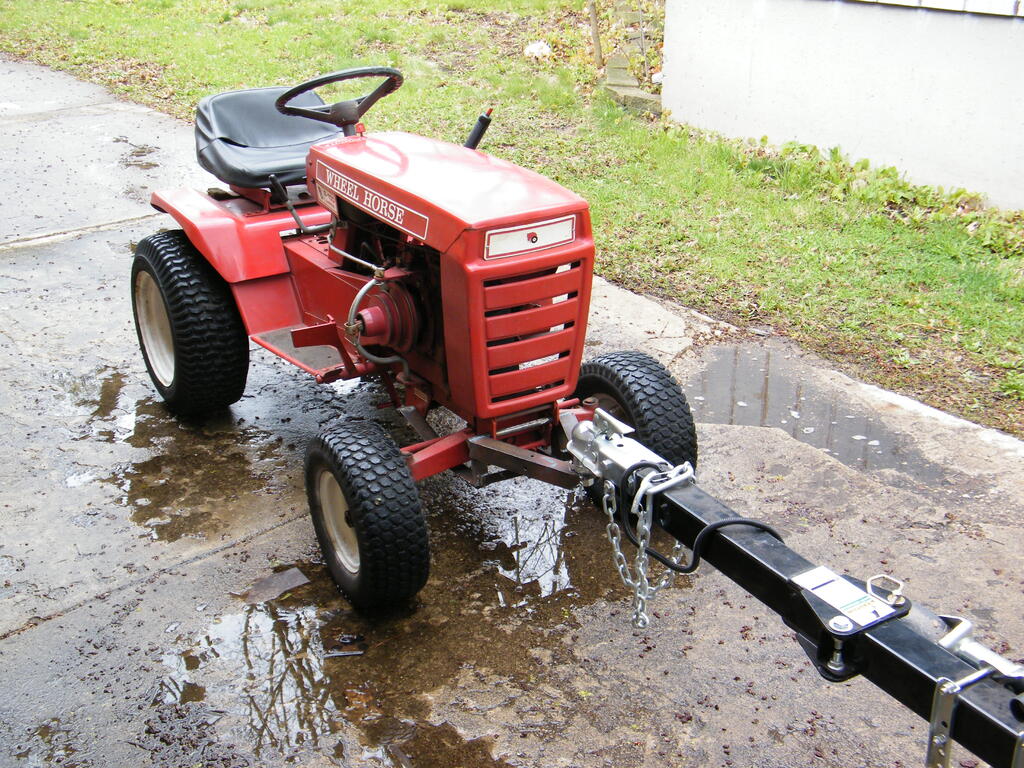

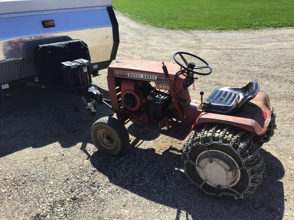

SylvanLakeWH 32,547 #21 Posted February 8, 2021 When moving heavy trailers I keep my tongue jack / wheel down and let it just skim the ground... that way if something goes wrong I’m not flipping the tractor... I do this front or rear towing... Here’s my set up: rear is my current tractor. Front I made but tractor is now in @pullstart’s barn... 4 Share this post Link to post Share on other sites
Pullstart 71,259 #22 Posted February 8, 2021 I cut and welded up a 4 way lug wrench to fit snug in a front tach-a-matic then welded and braced a hitch to it... 3 Share this post Link to post Share on other sites

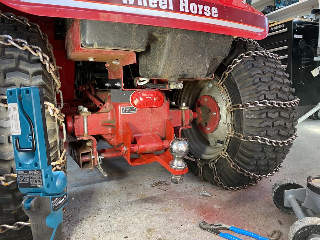

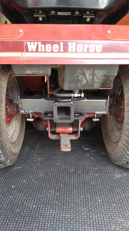

BeninCT 451 #23 Posted February 9, 2021 Getting there! Thanks all for your suggestions. This thing is so strong its ridiculous lol. 1 2 Share this post Link to post Share on other sites
ebinmaine 80,743 #24 Posted February 9, 2021 15 minutes ago, BeninCT said: Getting there! Thanks all for your suggestions. This thing is so strong its ridiculous lol. VERY nice work!!! 2 Share this post Link to post Share on other sites
BeninCT 451 #25 Posted February 9, 2021 @ebinmaine thank you but there is some ugly welding on this thing. Still working on my beads and maybe 1/3 of them are respectable that that leaves a majority to rule. I make up for it with grinding when I feel like it. Can you believe how big it is compared to the factory unit? Haha. Had to move my tail light to the hitch to keep it safe. 1 Share this post Link to post Share on other sites
