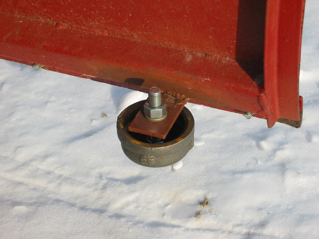

pfrederi 20,372 #3 Posted February 2, 2021 (edited) I used to use these I made from Carriage bolts and pipe caps. They worked well but wore out after a couple season. Broke down and bought the $85 Toro skids they wear better but dig in more when you have the blade angled Edited February 2, 2021 by pfrederi 2 1 Share this post Link to post Share on other sites
SylvanLakeWH 31,219 #4 Posted February 2, 2021 On gravel I’m thinking the puck style will simply dig trenches...? Probably need a “ski” with turned up front and back... perhaps mount on blade with pivot both horizontal and vertical. Maybe tied in back with a rigid rod to the plow frame so when blade is angled the skis don’t pivot and stay facing forward...? No pics, just thinking... 1 Share this post Link to post Share on other sites

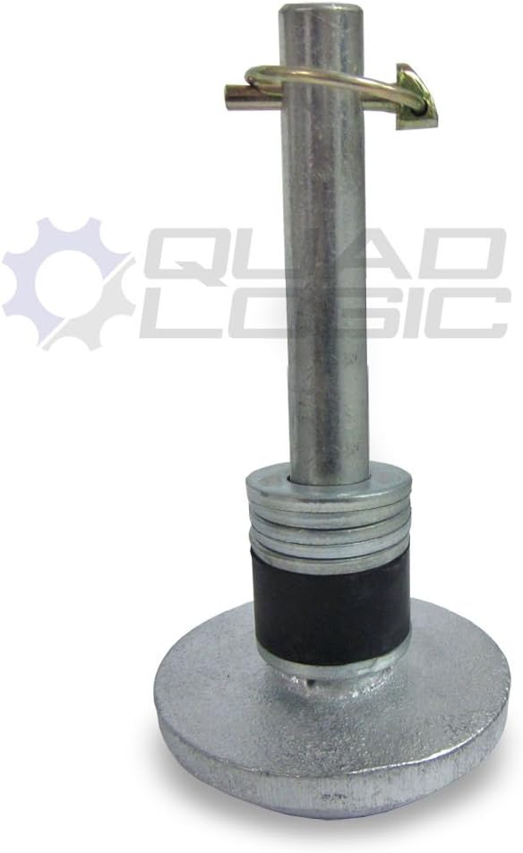

squonk 46,249 #7 Posted February 2, 2021 (edited) ATV Plow skids. Make a couple of hoops to hold them on. Work great! https://www.amazon.com/s?k=atv+plow+skids&gclid=CjwKCAiAjeSABhAPEiwAqfxURfUwnIKJ3vtH43SQ5ktZdbbwpSKHH5FKJazj6HteMSIScXhd7aONxhoCCtkQAvD_BwE&hvadid=177637085410&hvdev=c&hvlocphy=9005158&hvnetw=g&hvqmt=e&hvrand=12584320407615563393&hvtargid=kwd-2812256287&hydadcr=7467_9586261&tag=googhydr-20&ref=pd_sl_5wz3npilfi_e Edited February 2, 2021 by squonk 1 2 1 Share this post Link to post Share on other sites

Jeff-C175 7,207 #9 Posted February 2, 2021 (edited) 31 minutes ago, WVHillbilly520H said: Dan, post #2 here A couple observations from their use the past couple days. If the snow is wet and packable, these shoes will 'ride up' on the snow, packing it as you go. Plan your plowing so that you don't have to go over the same area twice or you'll end up with a layer of packed snow, in my case this is about an inch thick right now. Still driveable but at some point it will turn to ICE and then to a SLUSHY MESS both of which will require removal. Once you've got a packed layer, any attempts to scrape or remove it will result in LOTS of stone being pulled up with the hard pack. Need to get it right the first time or you're screwed... I somewhat solved this with the design of the added walk behind blower skids by bringing them to a POINT, with not as much upward curve as my original design. In other words, you want any design you come up with to be such that they CUT THROUGH the snow, at the same time keeping the blades above the gravel / stone. With the walk behind, that was pretty easy. With the plow blade not so much because angling the blade would mean that skids like that would be dragged side ways, defeating the purpose and digging up the stone and gravel. The 'mushroom' design addresses this to some extent but if you make the bottom contact area too large, they will still ride up on packable snow. If less contact area they will dig gouges into the rock and not work unless the stuff is well frozen to the ground. More down force on the blade by means of extra weight on the tongue, or a down force 'bar' instead of the chain on the blade lift might help some but I don't believe it will fully alleviate the problem. I like the idea of the chain to prevent damage to the rest of the lift mechanism in the event I hit a dead frozen cat or something else. Yes, the 'flipper' springs should take care of this but the less stress on the overall mechanics I think is a good thing. I'm thinking now that a smaller diameter and less wide PVC shoe might help a lot, along with removing the rubber 'sweep' that I've got on my blade. I'm going to start by removing the sweep that will allow the 2" PVC to ride closer to the 'cutting edge' of the blade. I might cut the existing ones in half and use them in three places, one in the middle also. Edited February 2, 2021 by Jeff-C175 2 Share this post Link to post Share on other sites
Jeff-C175 7,207 #10 Posted February 2, 2021 (edited) 55 minutes ago, SylvanLakeWH said: On gravel I’m thinking the puck style will simply dig trenches...? Yup, big time. Unless the stone / gravel is very well packed and FROZEN! Edited February 2, 2021 by Jeff-C175 2 Share this post Link to post Share on other sites
Jeff-C175 7,207 #11 Posted February 2, 2021 54 minutes ago, SylvanLakeWH said: Maybe tied in back with a rigid rod to the plow frame so when blade is angled the skis don’t pivot and stay facing forward...? Ohhhh... I LIKE that idea! Now where did I store my cache of UniStrut? 1 1 Share this post Link to post Share on other sites

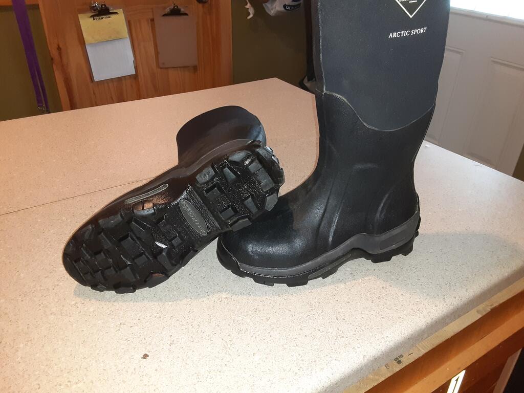

D_Mac 9,334 #17 Posted February 2, 2021 (edited) I am outside most of the day at work. Walking through heavy snow. I wear The Original Muck Boot Company Arctic Sport Boots. I stay warm, dry, and they are very comfortable. I can walk through a creek up to my knees in them to and stay dry. Worth every penny I spent on them. You can also get them with a steel toe if you wanted. Believe that model is the " Chore" Edited February 2, 2021 by D_Mac 5 Share this post Link to post Share on other sites
