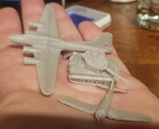

23 hours ago, Wheel Horse 3D said:
Nice.  Are the gun barrels in the chin turret of the B17 printed?  I never tried printing anything that fine when I was messing with the 3d printer at work.
I'll vote for red led for the horse's eyes.  Kind of goes along with the Western literature being discussed - 'Ghost Riders in the Sky' vibe.
Edited by 8ntruck
  • Excellent 1
Wheel Horse 3D
It might be possible to print the turret seperately, theres a bunch of sifferent models out there thats just one o pulled on a whim. The turret of the sherman is printed seperately and swivels, its barrel is about 1.2 mm diameter.
Edited by Wheel Horse 3D
Wheel Horse 3D
Right now I have .4 mm nozzle on and you can get nozzles down to .1mm. Usually line thickness is about the same as nozzle size.
8ntruck
With the proper printing direction, you can print operating multiple piece mechanisms.  I did a few that had .010" running clearance between the parts.
Wheel Horse 3D
Yes you can! I find that is usually about right(0.25mm), sometimes a little more depending how snug the surfaces need to be.
Just have to rmember resolution isnt the same horizontally and vertically. While the printer can achieve higher resolution vertically after the first layer, your limited by nozzle size horizontally.
Wheel Horse 3D
Basically the printer can print very fine layers, but detail in each layer is limited by the nozzle diameter.
Wheel Horse 3D
I can stack up a single line width of 0.3mm with the .4 nozzle so thats basically my minimum resolution. Right about .01 inch.
